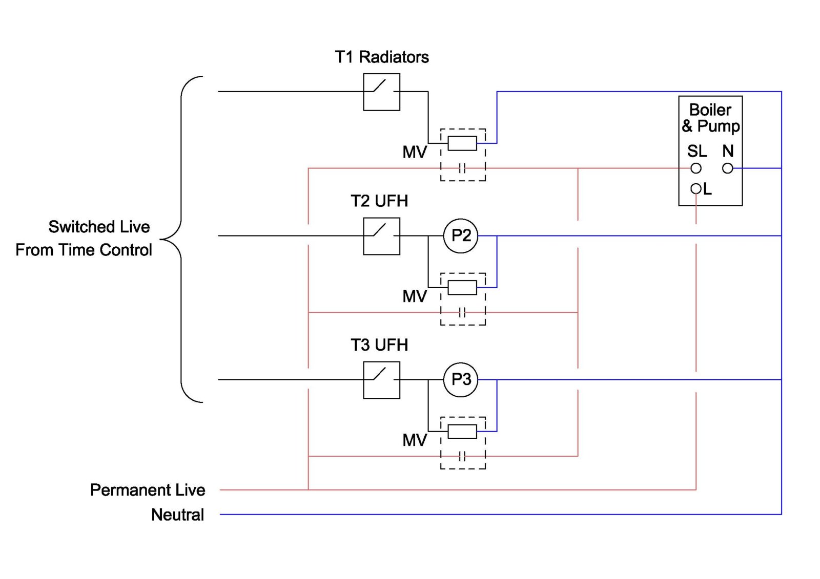

I’m hoping someone might be able to help me out with a wiring diagram.
The system runs off a combi boiler.
There is a main house radiator circuit.
There are two additional zones with underfloor heating, each with its own pump and isolator valve.
Each of the three zones has its own thermostat.
I want a valve to open, the pump to run and cfh from the boiler only when the thermostat for that zone activates.
I have a plan in my head; I’m just convinced it’s right. I’m cautious I don’t want other zones to activate additional pumps.
I’ve found many wiring diagrams on the web, but none that feature multi pumps.
If you have a diagram to share it would be appreciated.
Yes; appreciated. Each zone has a relay activated by the stat.
Each Drayton valve also has a relay micro switch available to use.
I’m cautious though if they all go back to a single cfh, I don’t want each zone to power other pumps.
Does someone have a diagram I could use to make this simpler.
Here's the basic concept. There may be some minor variations, if for example your thermostats need a neutral connection. The motorised valves contain a microswitch to allow them individually to control the boiler without feeding back to the other heating circuits and switching them on.

I think that answers what I was after; thank you.
The thermostats are simple nest heat links. They make or break the chf wire from the boiler.
The aux switch allows for the circuit isolation if I underestimate correct. You get my concern that the other circuits would have been back fed by the one active circuit.
Nest's are programmable thermostats. (you just said "thermostats" which are different. Thermostats don't include any time control) That just means that there won't be any separate programmer / time control that I have shown, and the Nest Heat Links will need a neutral connection.
In your case, Heat links don't "make or break the chf wire from the boiler", they provide 230V to control the motorised valves and UFH pumps. Then the motorised valves' internal microswitches control the boiler. Either by wiring them to 230V as per my diagram, if that's appropriate, or alternatively the microswitches can be used as 'voltage free' contacts if your boiler is currently wired to use low voltage (24V) control.

Thanks - that’s very helpful. I simplified some of my language.
The background is, it’s an old installation that didn’t work very well. The installer effectively put the ufh on the same thermostat as the radiators. This of course meant that the radiators fired needlessly for four hours a day while the ufh was gearing up or the house was freezing working the other way round.
I improved this a couple of years ago my adding a second heat link and valve to isolate the rads use. My wiring design back then wasn’t ideal as it ‘enhanced’ the original installation.
But now with a new house extention and another ufh with its own pump and isolator the design is more complicated (for a novice at least).
I know the boiler cfh expected 230v
If I understand correctly the cfh function should always be activated by the aux switch on the valve.
The valves should be powered by the heat link circuit making contact.
A bit of a guess, but I imagine it also should happen like that to ensure the boiler doesn’t start pumping until the valve has opened and there is somewhere for the water to pump to.
The pump combined with the boiler that circulates water around the radiators and also supplies the UFH circuits won't start until a motorised valve is fully opened which is the point when the microswitch is operated. If your boiler has a pump overrun facility (where the pump runs for a while after the heating shuts down) then there will be a by-pass to allow the water to circulate anyway.
I have only worked on a couple of UFH systems, but on those I did, the UFH manifold allowed the UFH pump to circulate water around the UFH loop even if the motorised valve supplying it from the boiler is closed, but as the valve and pump are powered together there will only be a few seconds delay between the pump starting and the valve opening anyway.

The water leaving your boiler will be supplied hot enough for the radiators, however this would be too hot for UFH.
The UFH pump circulates water around the UF pipes at a much lower temperature which it achieves by the manifold mixing the cooler return water from the UF pipe system with some hot from the boiler as and when required.
