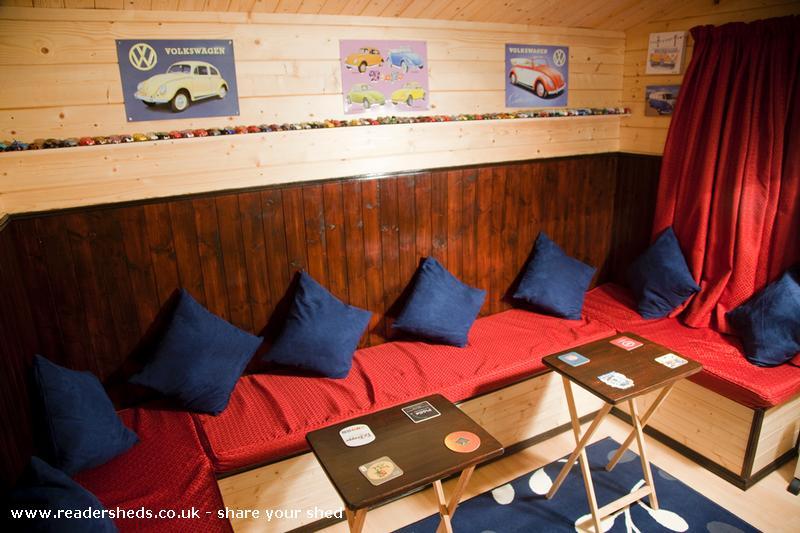

I have built a timber summerhouse/log cabin using 28mm thick T&G wall planks. it is double glazed.
The Roof and floor I am happy with and both are insulated and finished.
I want to line the walls with plasterboard (top half the walls) and T&G Cladding (bottom half of the walls) its going to be a pub of sorts.

not sure what you mean John but hopefully these pics may explain better.
the cabin I have is constructed like the one in the image attached.
I want to create an interior similar to the image attached. Plasterboard or ply upper half of the wall to be plastered or wallpapered and a T&G cladding on the bottom half.
The final image is what I was hoping would be ok. My concern is does there need to be an air gap between the outer wall in this diagram and the 'red' breathable membrane with this particular setup?
thanks again
