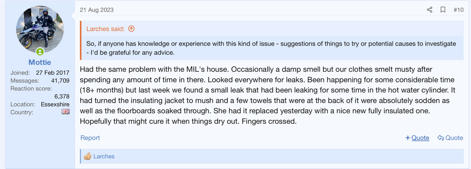

Had something similar.
That didn’t cure it, smell still there but the MiL's in a care home now so the house will be sold. Couldn’t normally smell the mustiness when in there but can now when we pay an occasional visit to the house.,

My sister in law has a flat that always smells like that, I think there is a failure with the damp,proof arrangement somewhere, although there’s no damp anywhere visible….it is very annoying.
