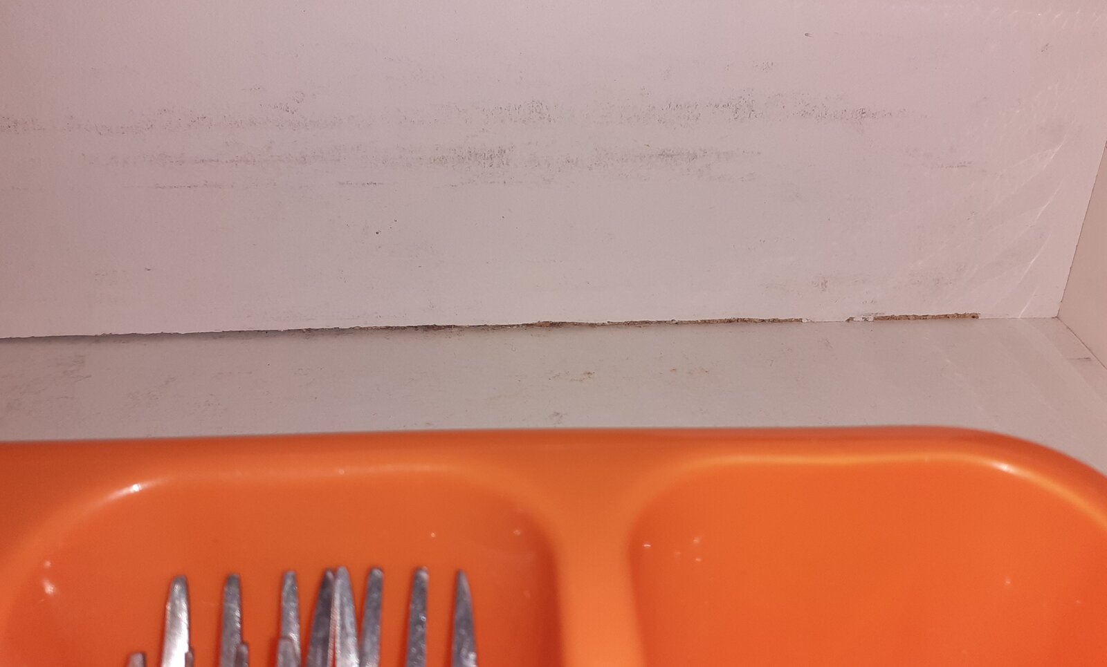

I've cleaned the cabinet thoroughly but the musty smell always returns. The countertop above is dry. None of the other kitchen cabinets have this issue.
I've noticed the small hole in the top left-hand corner. I wonder if that could be where the smell is coming from.
Drawer:
Take the plinth off and if you have a mobile phone with a camera take a picture of the void behind the units, better still take a video of it,see what that shows....
I took the plinth off a few months ago and found some debris on the floor as well as mould on the back wall which I removed. It now looks like this:
I think this reduced the musty smell but there's still a lingering odour inside the cabinet. I'm wondering if it just needs more time to air out or if there's another source for the smell.
Update: the plates and cutlery I had cleaned and put back in the cabinet now have that familiar musty smell. I can't use the cabinet for storage because it make everything inside it smell.
I'm at a loss as to where the musty smell might be coming from. The area behind the plinth was cleaned months ago. Any suggestions?

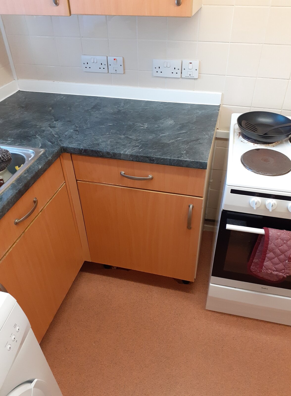

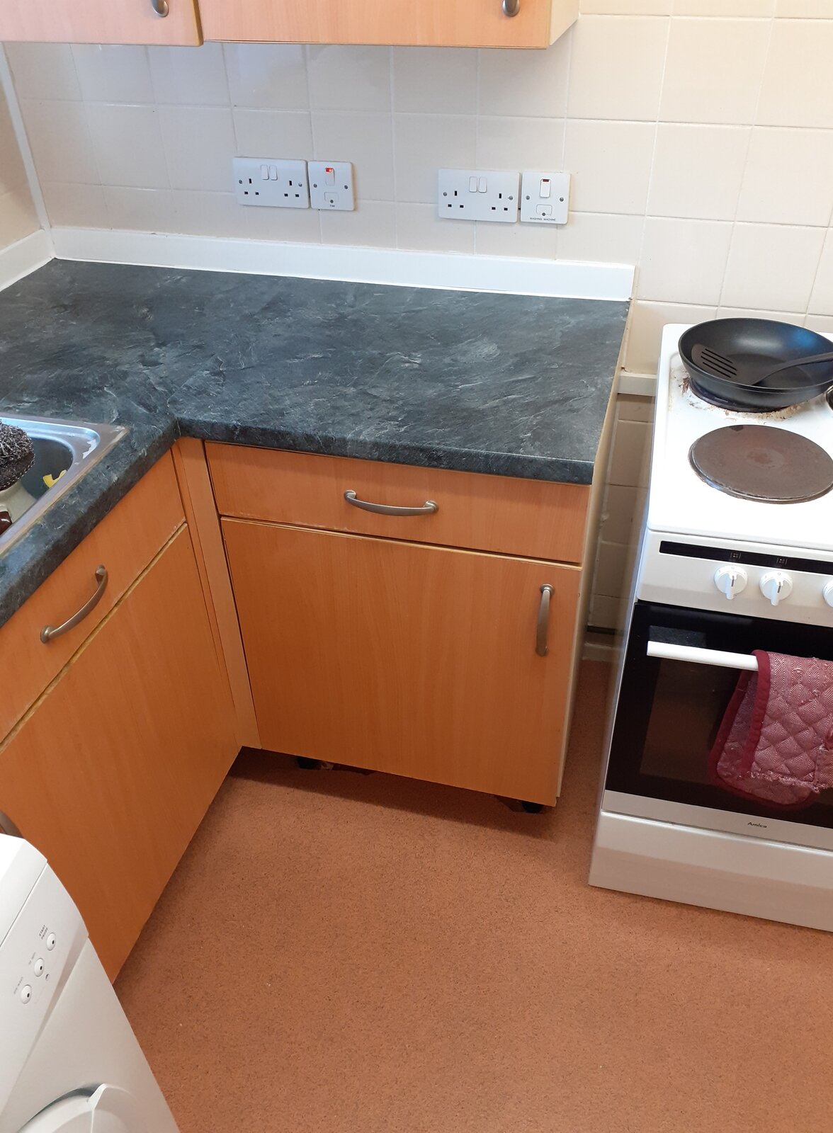

Stand back and show what's around it, e.g. pipes, sink, washing machine, waste pipe, boiler, fridge
Sometimes it is a broken or leaking gulley or waste pipe adjacent outside, making the wall wet.

Is it the one between the sink and the cooker? The sink and its plumbing are especially suspect

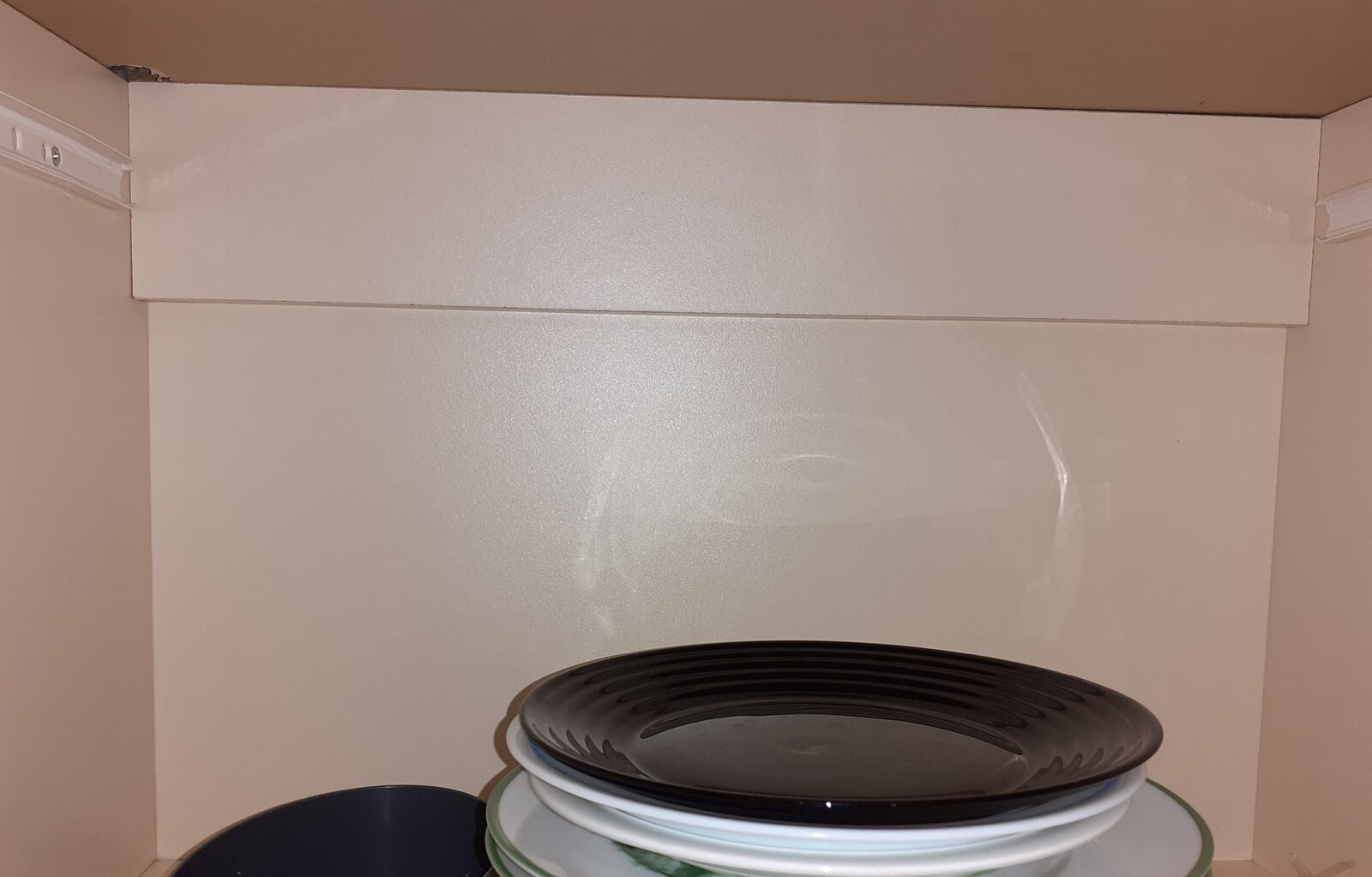

Is your third pic the space with the cooker pulled out?

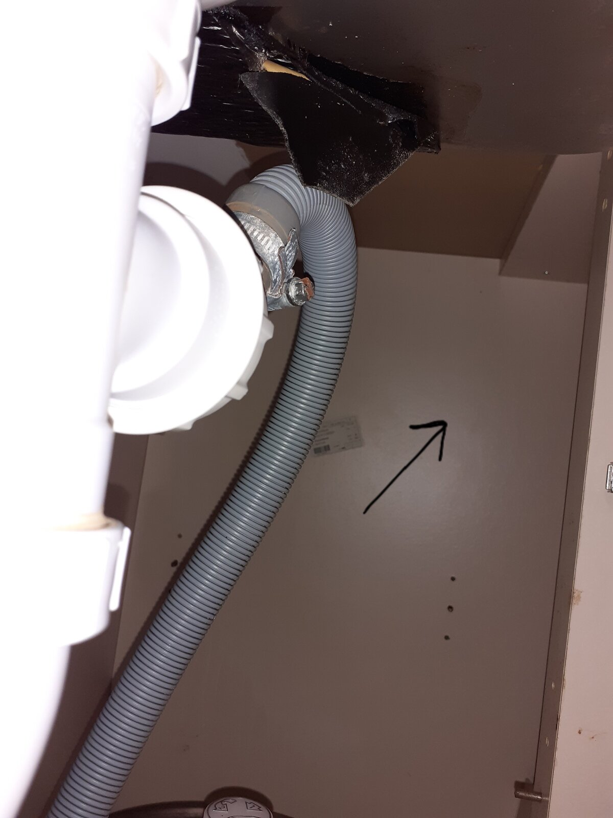

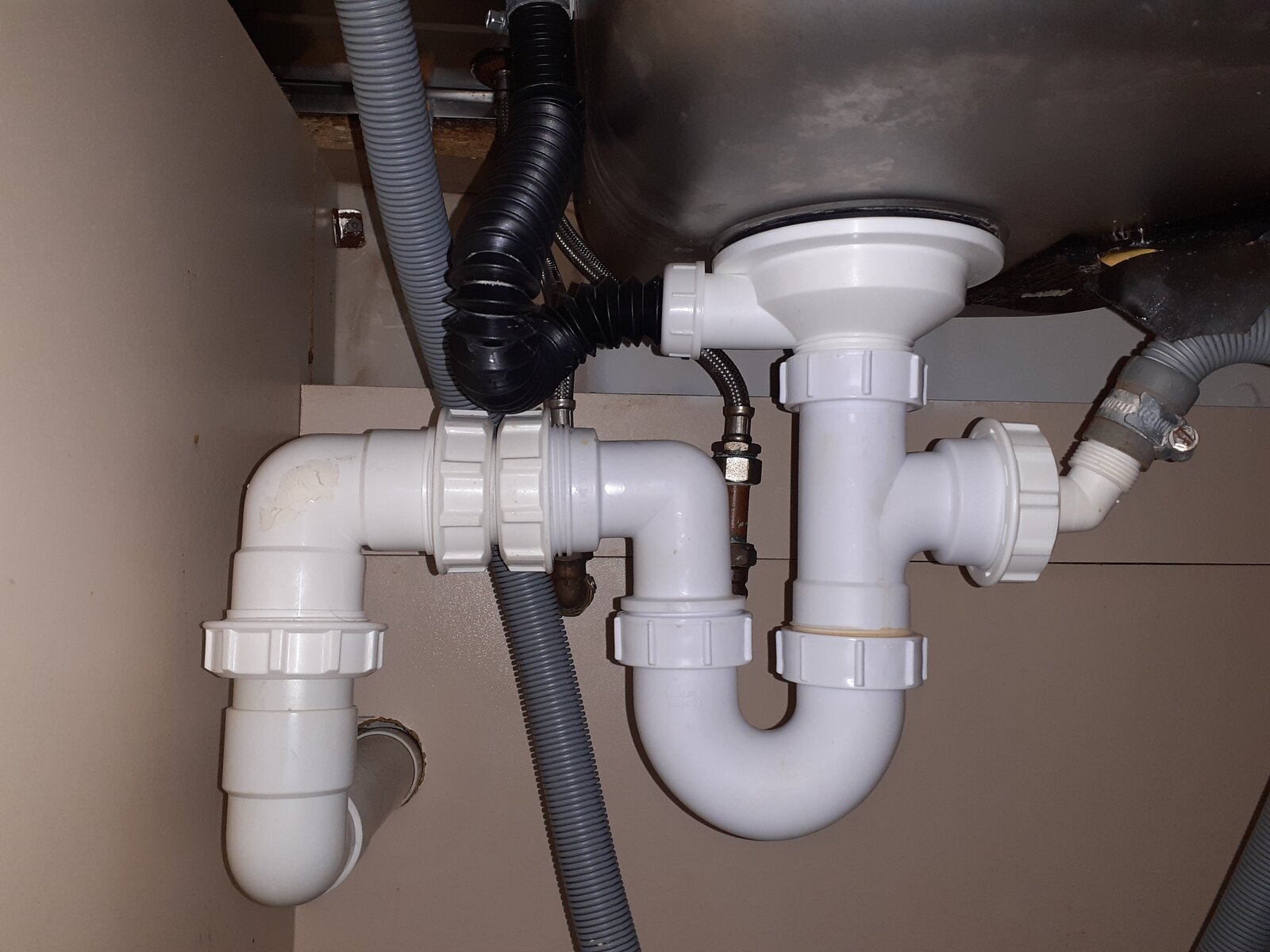

Can you show us inside the cupboard under the sink? Especially towards the corner?

I think the pipe we can see under the cupboard is probably the gas pipe, which rises up behind the cooker. Can you see if that's right? There will be other pipes for the sink.
Ah yes, I can see the washing machine beside the sink.
There will be a shiny flexible plastic (usually blue or grey) water supply pipe to the water pipe under the sink, and a larger, grey, often ribbed rubber, hose for the washer waste. This will attach in some way to the waste pipe. Photograph that, and the route it takes between the washer and the waste. It ought to loop up, right to the underside of the worktop, otherwise stagnant water can collect in it. This is easy.
The one by the cooker yes. There is no musty smell in the cabinet directly underneath the sink.
Yes.
The third picture below, the arrow points towards the upper corner that's nearest to the musty cabinet.
Is there a dishwasher or washing machine?
Only a washing machine. A section of the waste pipe was recently replaced because it looked suspect, although it never leaked.

The joints under the sink look OK
There is a bad water mark on the underside of the worktop to the right of the sink. Might have been a spillage or a leak from upstairs. Is it dried out now?
I can't see any pipes going to the right of the sink towards the musty cabinet.
Put your camera underneath and photograph the gap in the corner please
Please stand back and take a wide shot of that end of the kitchen
