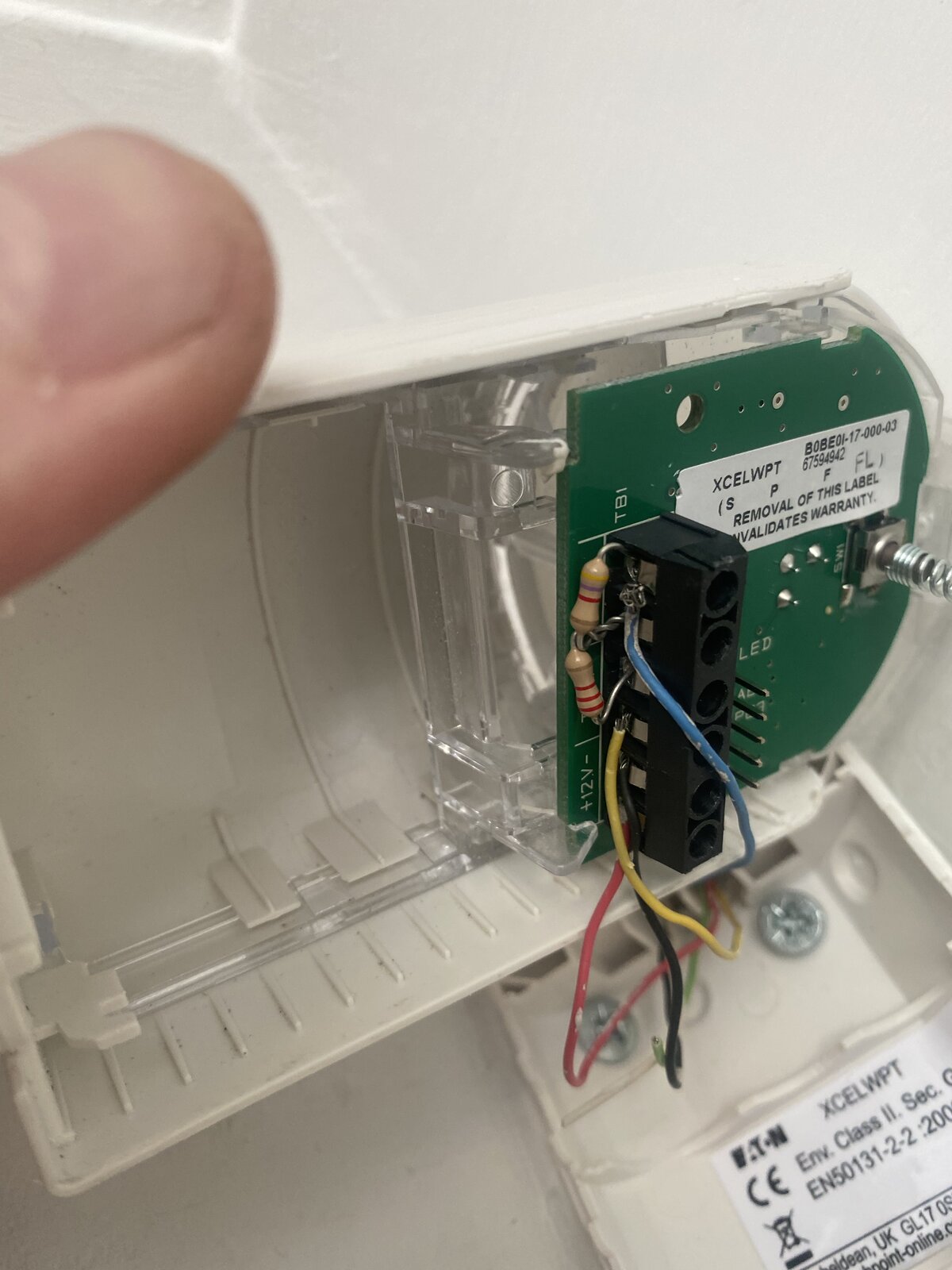

Hi. Does anyone know if it's possible to mute an external sounder on an i-on40H? It's a new installation which I did myself and I want to get familiar with it without annoying the neighbours. I know that I can disconnect the Bell Trigger wire in the panel but would prefer not to do it that way. Thanks.
Appreciated but if power goes off it auto reverts to 15 mins
do you know this system Mark?
because I’m having a mare with the wired PIR
there just not working
pics attached how I was told to wire
your thoughts much appreciated
best Neil

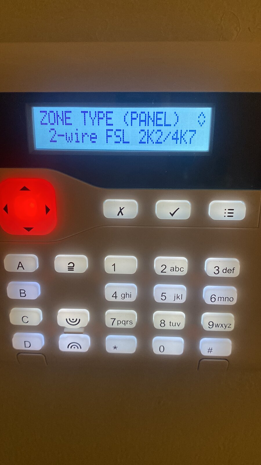

Am using 2k/4k resisters so selected
(FSL) 2 cable 2k/4K7 as my setting
Other options are 2cc or 4cc 2 wire in either
1k/1k
2k-2k
2-4k
4k-4

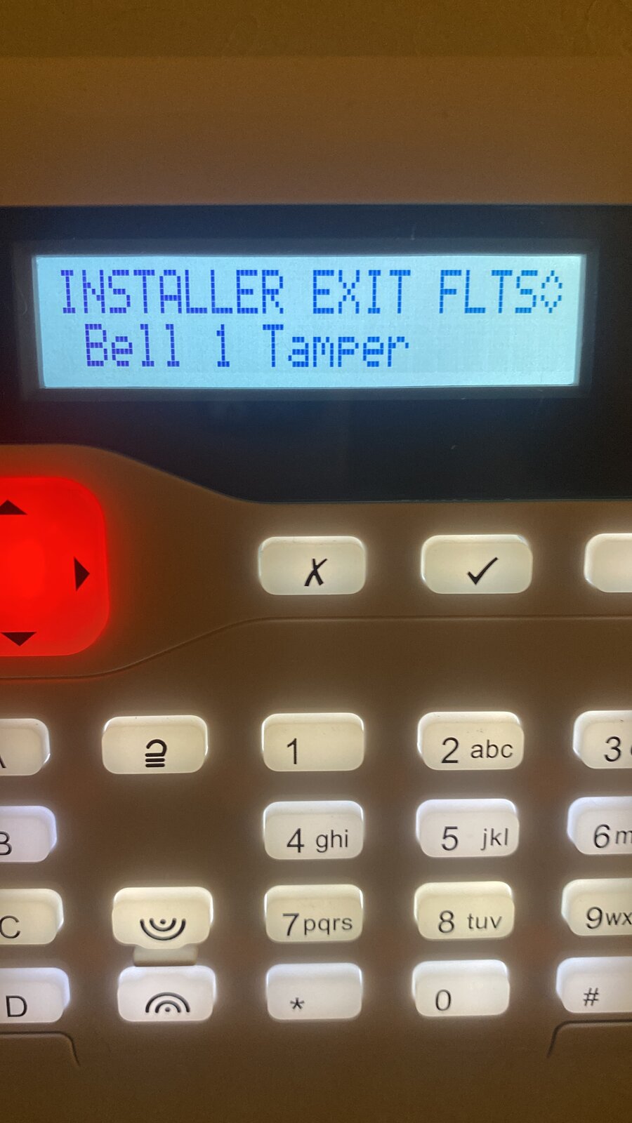

And just as it was getting better, now I have a Bell Tamper fault, which I didn’t have before
Aaarrgghhhhh

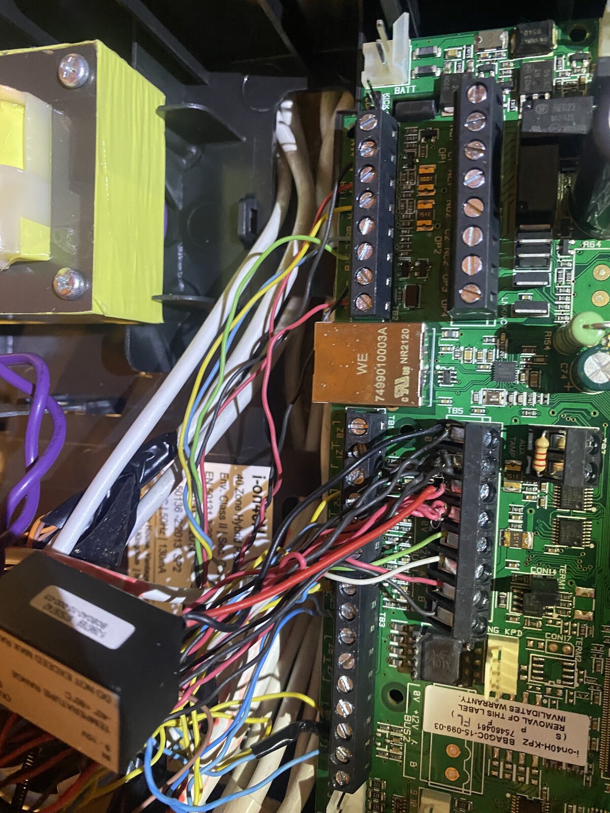

does that all look right.?
must have a wire pinched on the sleve somewhere, a# been over PIR with a fine toothcomb, so willl look closely at panel to row. Unless you have any other ideas.
ty Neil

New bell tamper would suggest tamper switch not adjusted correctly or wiring fault.Due to the recent hot weather is the bell box in sunny position as heat can affect the covers.
I would suggest make all zones not used,then turn one zone on and concentrate on that zone until system works correctly. Then you can move onto next zone.This way you prove that zone programming is correct on each zone.
Your wiring does look correct which points to programming.

wired ones having some issues, plus the wiring on all PIR was different, so had red on one for 12v then Red for T1 then red for C nightmare
somswitched them all over to
red 12v
black 0v
yellow T1
Blue C
So thinking I have those right now

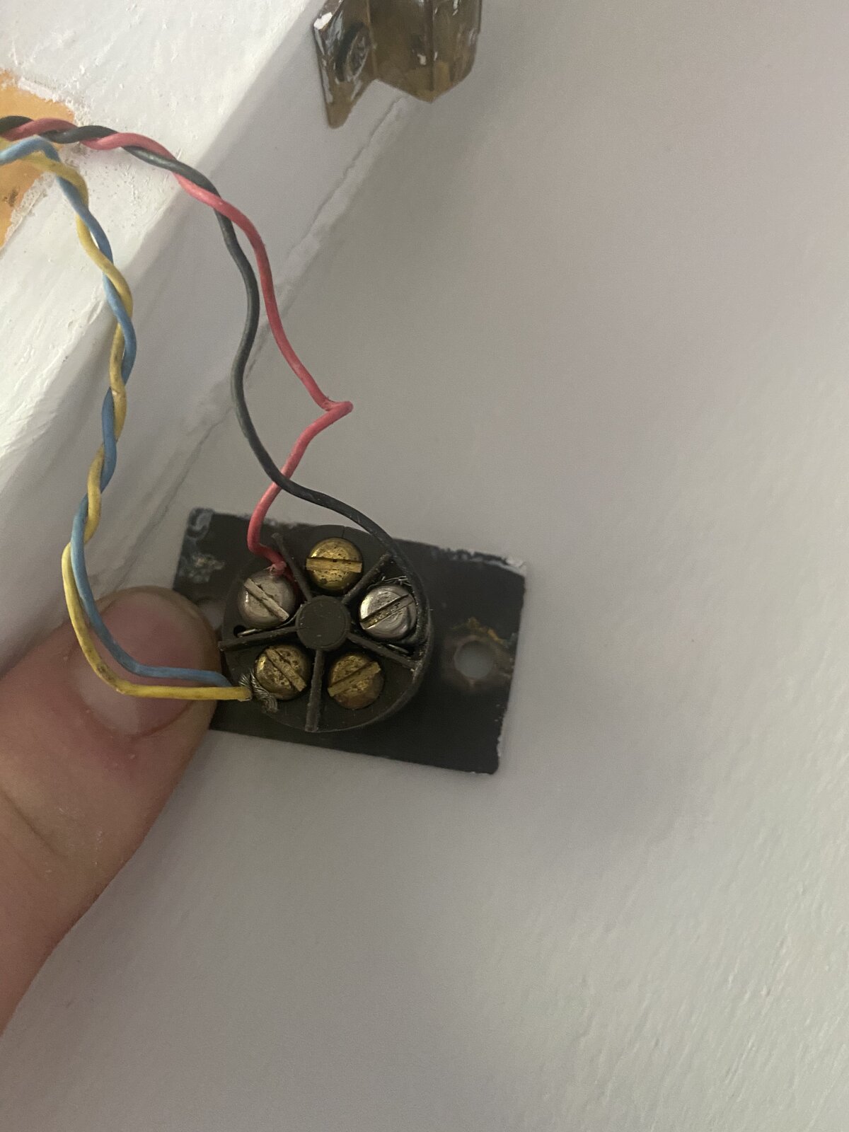

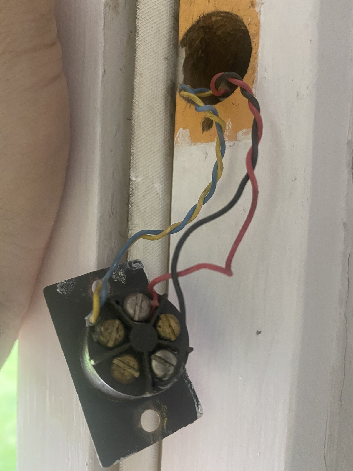

the other issue is 2 door sensors magnetic, you only use the yellow blue for that correct to z1 z2 at panel, however they both have 4 wires wired in red black yellow blue…… you ignore the red black correct?
but at panel join them in with a PIR so they are
yellow z1 PIR
blue/yellow C PIR and Mag DoorSwitch
blue Z2. Mag door switch
ignore red black for Switch and put red black PIR to Aux 12 v/0v
using no resisters on Switch? Is that correct?

Yes box is in direct sun, wasnt having any issue with that and now that’s my only fault to leave installer menu but will check over wiring at Panel, as I haven’t been anywhere near the alarm box outside.

Can you post photo of door contact and wiring.
Can you post better photo of zone wiring inputs on pcb.
All zones 1-8 will be FSL (Eol)
Any un used zones need programming not used and I would put 2.2k in spare zones to eliminate and programming issues.
Door contacts will require resistors.
As I said start with one zone get that right then move on to next.
Put link wire in Tr(tamper return) and 0v to clear tamper fault,then investigate once sorted other issues.
Once you have a clear panel will make it a lot easier to move forward.
switch wiring front door
2nd photo
Switc wiring rear door

The contact in your picture above is 4 wire.
red and black is the alarm pair and blue and yellow the tamper pair.
I can see from the manual, that the panel and older expanders require you to use the same wiring methods throughout.
so any sensor wired to the panel must use the same wiring type ie resistors if that is what you have selected.
If you have an expander you would have to check if you have the expander that is capable iof accepting mixed wiring types.
Ok added resistors and had lost the bell tamper and had front door contact and hall pir working Horrah ….
wired the rest the same and to my utter disappointment a totally new issue, where the keypad now isn’t reading the panel
tried turning system off powe down etc back up but just come back to as if it’s a new keypad with
Eaton V5.1
time 00:00 date 14/04/2001
tried holding down A✅ To get Panel address and just beeps about 10 times and has adr ————-
Eaton said try power down back up holding D X reset but doesn’t help and panel is non responsive except if you hold B✅ Gets you into the backlighting menu but once out back to Eaton V,5 etc
this is all done with the keypad away from the wall.
