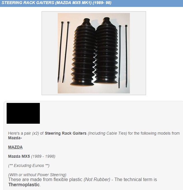

I'm replacing the Steering boots and the tie rod ends oin my Mazda MX5 NA 1993 Eunos.
1/ The large end of the Boot was too tight to fit, so I heated it with a how air gun, till it went on. Has anyone had a similar experience with this car?
2/ With the old Ties rod end removed, and the new one on the tie rod. When in the taper, the nut won't tighten (It has plastic locking) I couldn't even get the old nut to tighten it into the taper. I try twisting the ball trying to hold it, but still can't get the nut to tighten. To me it seems as though the taper isn't quite right.

Hi J,
Trolley jack! Oh how the other half live! A pile of bricks and a plank held the Tie rod end, which is now tight.
I think the Boots are incorrect for the Eunos, which has differences from the MX5. Today I'll measure the other one, and the steering rack end, and see the difference. NOTE: In the image the EUNOS warning.
Thanks.
C

Lol. Thermoplastic boots with cable ties! You’d have been better off buying some universal rubber ones.

Hi M,
I understand what you're saying. As they were still pretty warm after the hot air gun, they yielded to the cable tie, and the molding went into the groove ok.
I'll look out for some universal ones, for when these fail.

I'm wondering what the difference is between the Eunos and the original MX5 - maybe one had PAS or something.

Hi J,
I measured the end of the Steering rack and it was 6MM larger than the gaiter, so the ones I bought definitely need warming.
C.
Yep, that's too much for stiff gaiters to yield - reminds me of Iveco truck stuff :eek:
Anyway, they might last years....or days so just keep an eye on them.
