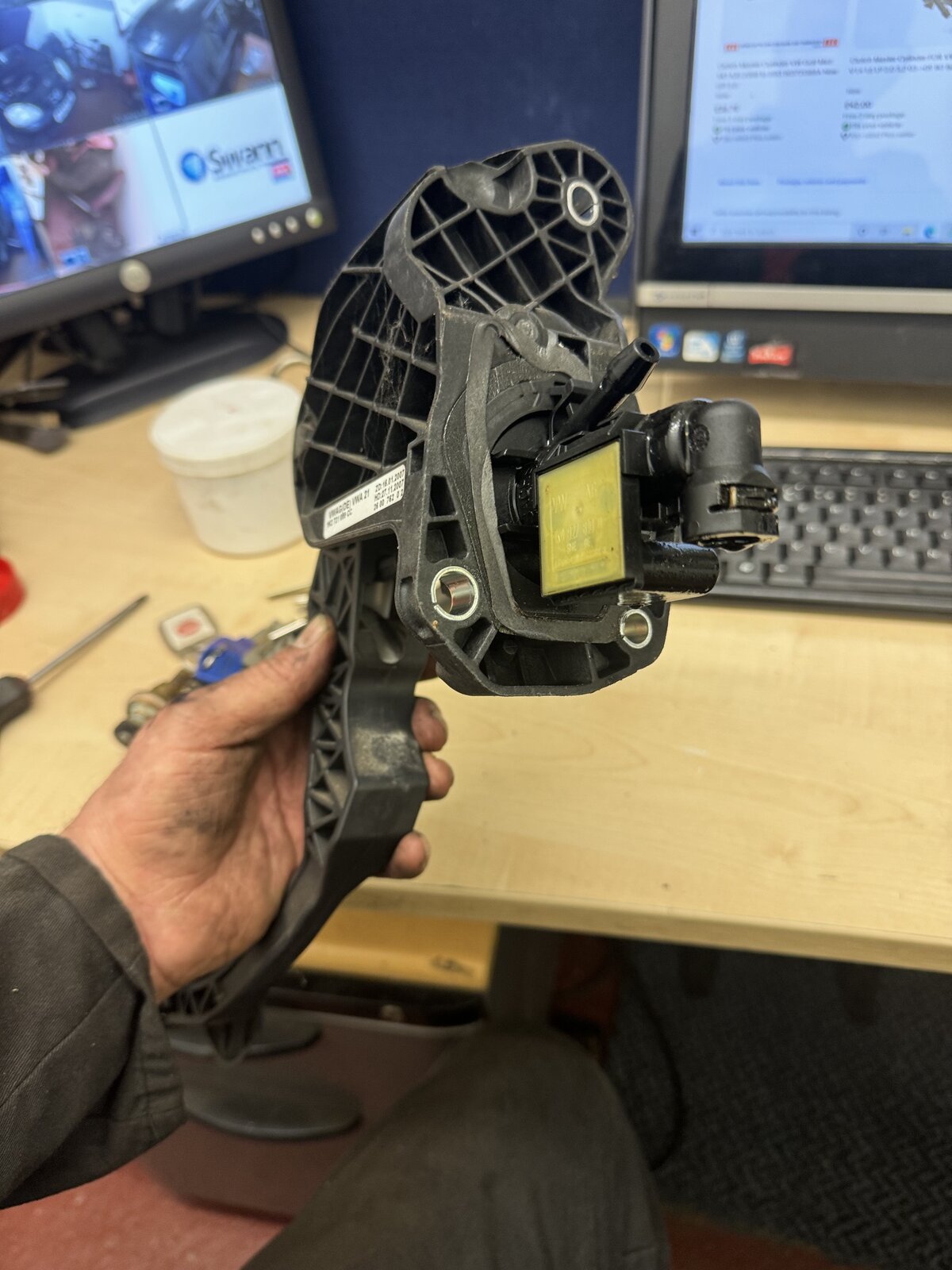

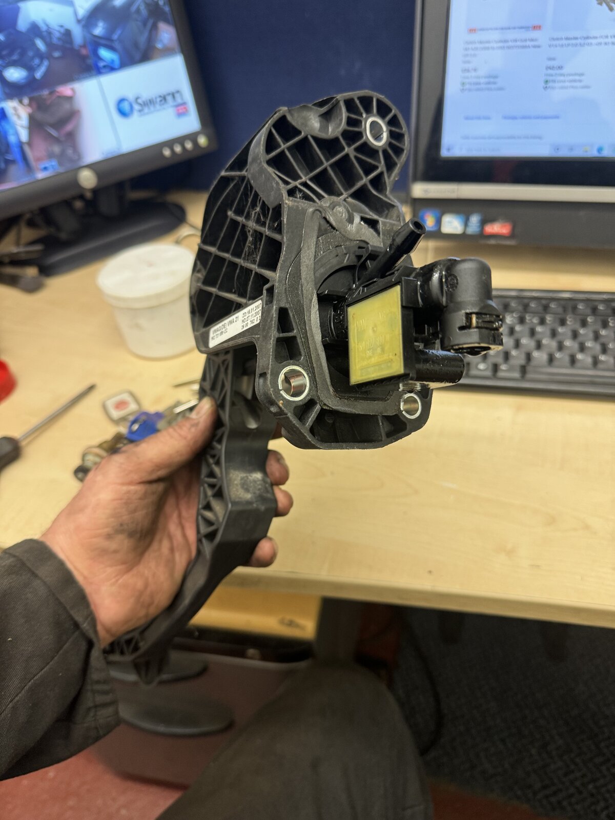

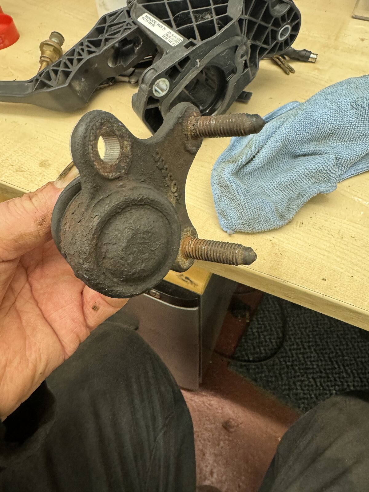

Ended up taking the pedal assembly out. Appears to be a crack in the plastic casing in the cylinder. New one is only £34. Had to move a load of bits out of the way to get to it though.

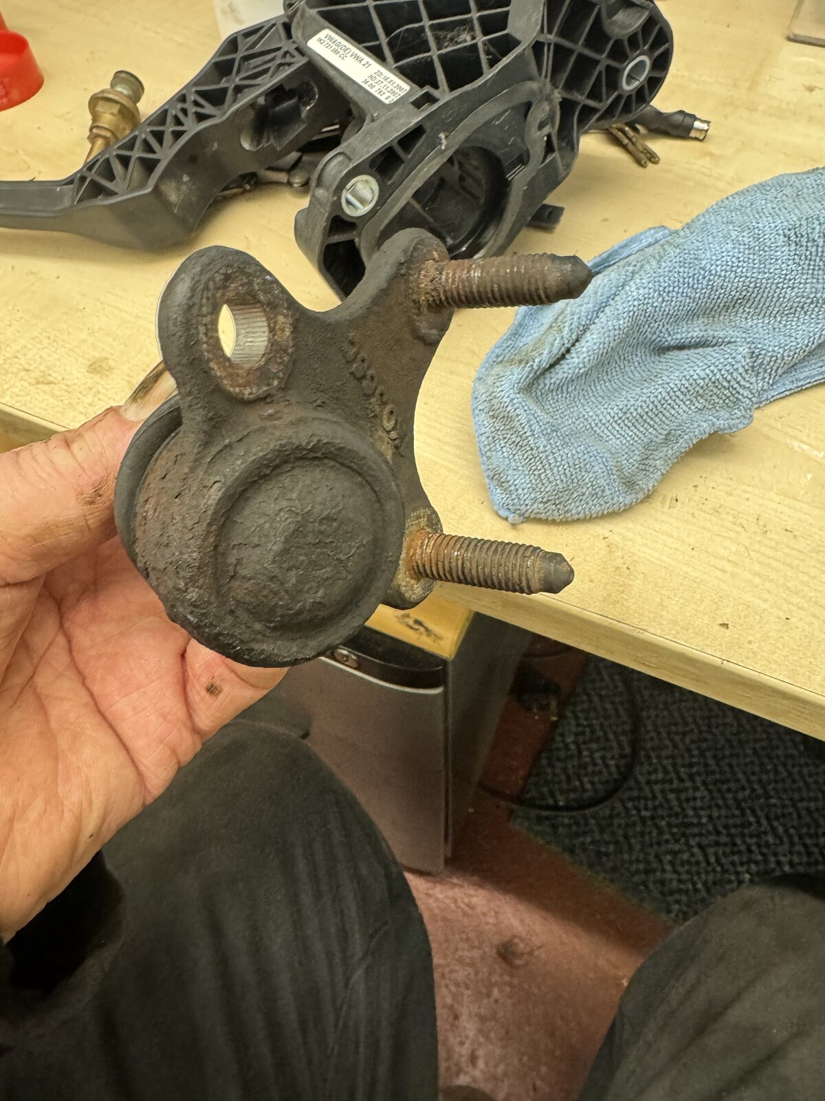

While I was under it, I noticed the CV boot was split so I thought I’d change that too. Broke a f'cking stud on the Bottom ball joint though and, typical, I chucked both of my buckets of bolts out the other week when I was having a clear out. I removed the broken stud but not paying £20 for a new joint - I’ll pop down my mates garage tomorrow, go through his bolt drawers and nut and bolt it back on.

This is why you should NEVER chuck out your box of random crap spares....

And again yesterday. The feeder pipe from the reservoir to the clutch master cylinder was leaking. Of course, I’d thrown all my bits of pipe away too in the great clear out. I ended up cutting 8” of pipe from my airline!

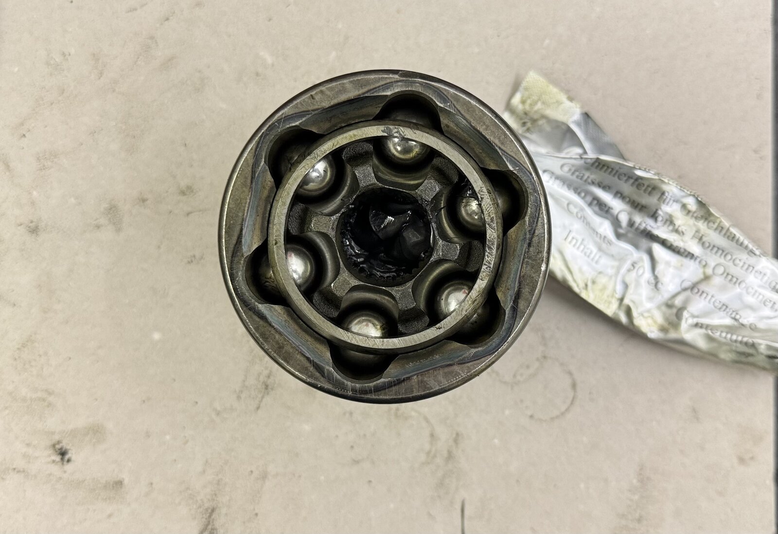

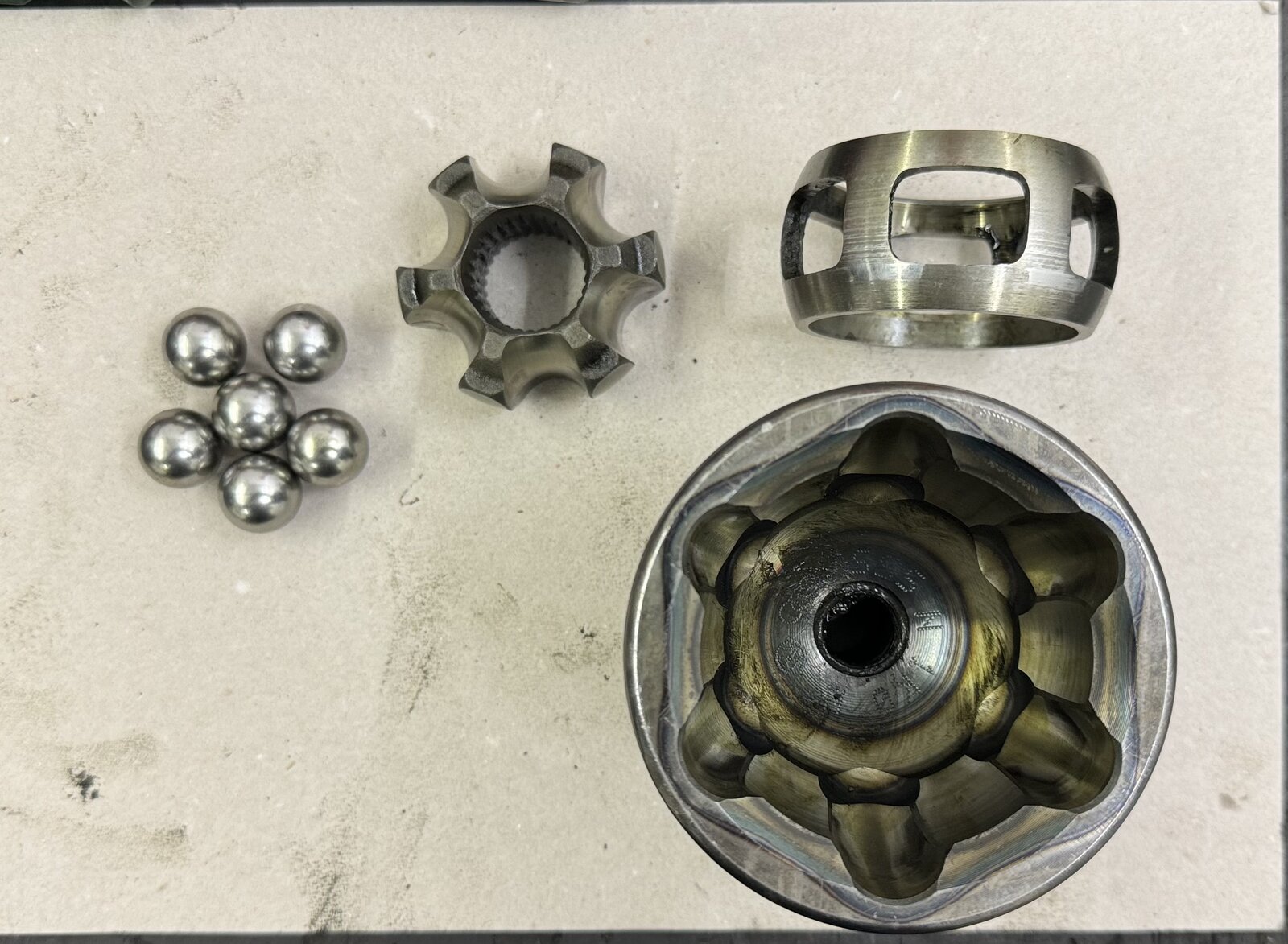

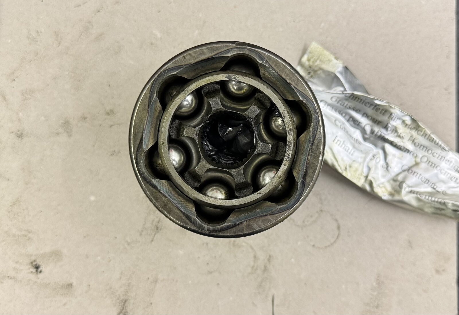

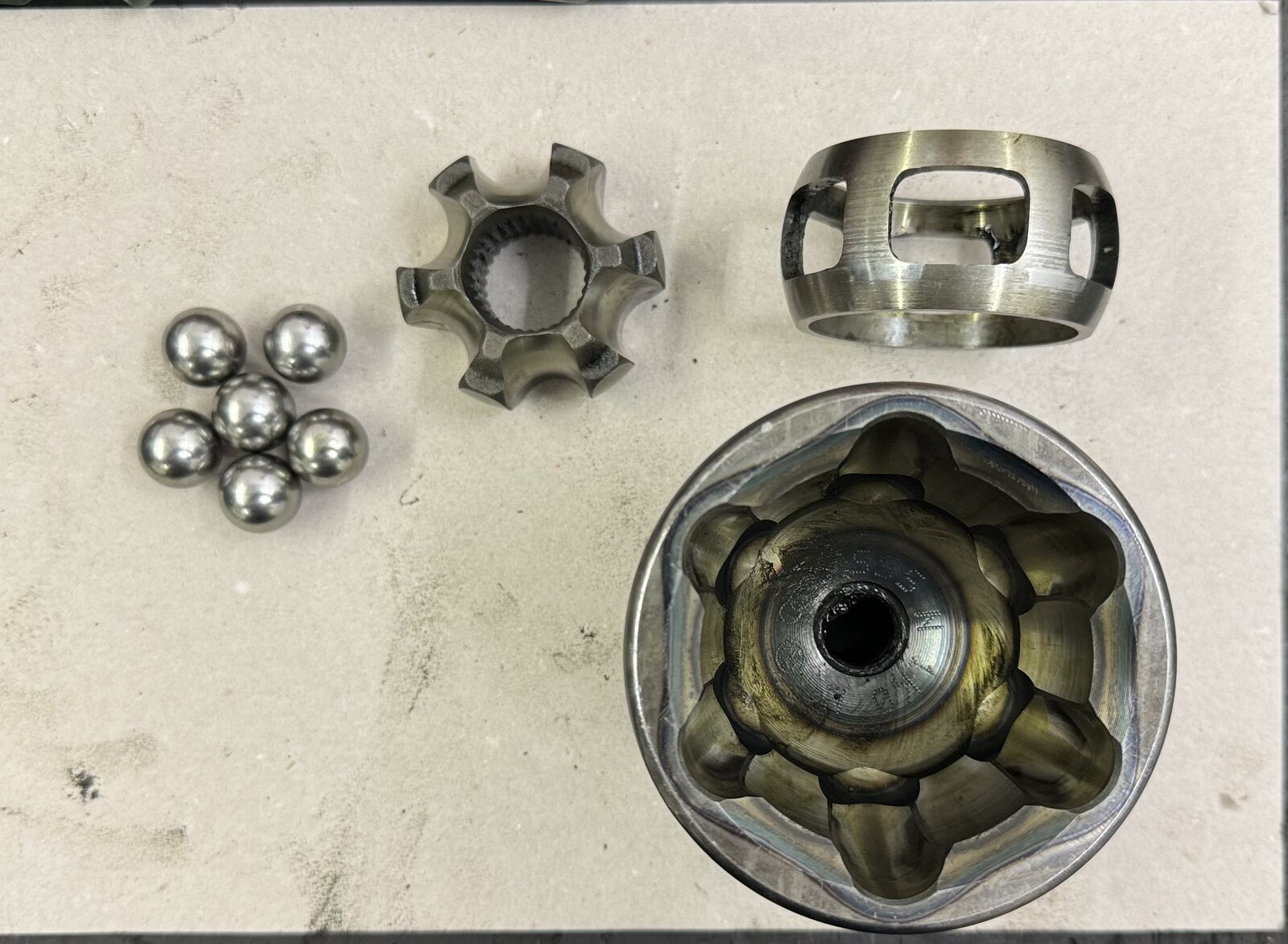

While I was replacing the CV boot, I took the opportunity to strip the joint down, clean, inspect and repack it with fresh grease.

If you are leaking fluid you will see where its coming from (between the engine and gearbox if its the slave cylinder). If you are not losing fluid, it will be an internal seal on the master cylinder. My one was leaking through a crack in the plastic molded cylinder.
