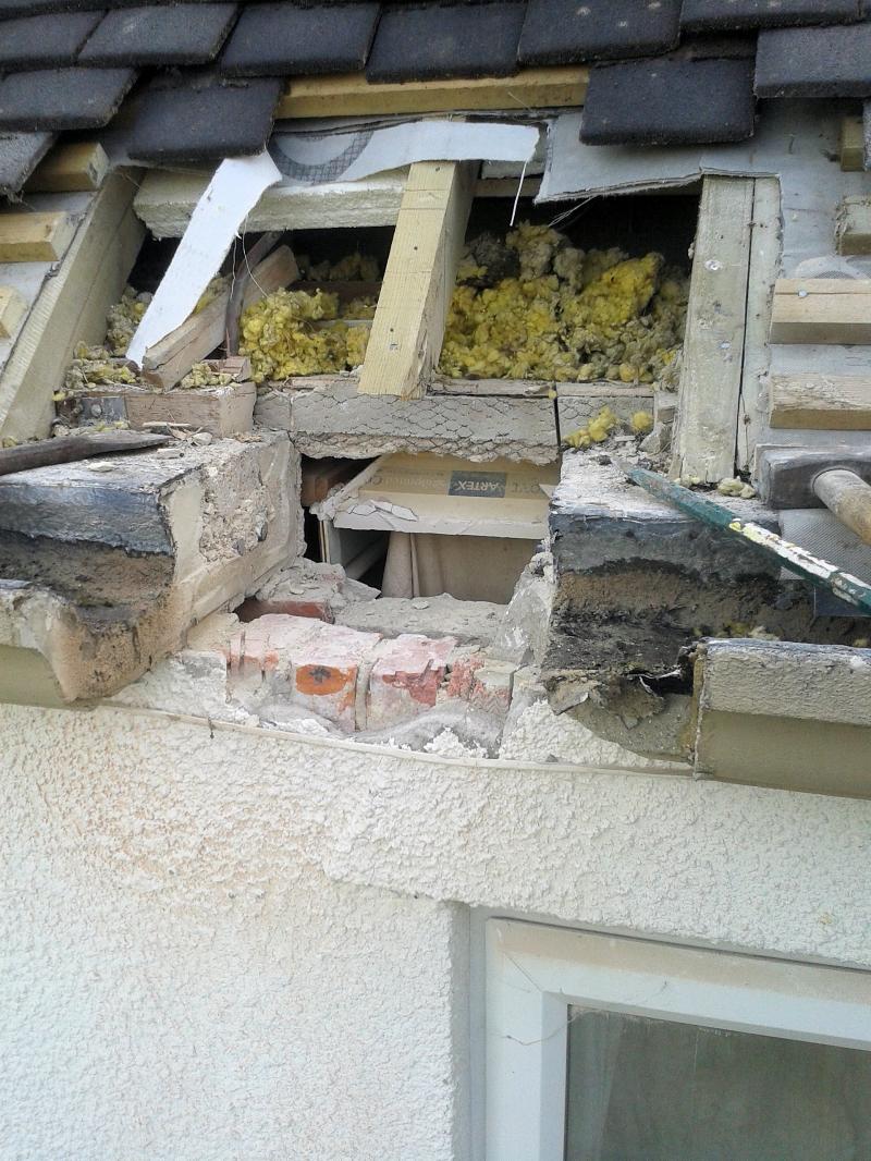

Yesterday spent some time and effort removing the reinforced concrete Finlock guttering. then placed the 'new spec' pad stones in place (as per pic) the other side was easier, i just cup some of the finlock off to the right height and then put the pad stones on top. I used a cheap laser level to check heights not forgetting that the top of the pad is the finished height of the ceiling less plasterboard. I had a 'moment' when I dropped a heavy lump on the gas meter cupboard and another when I suddenly realised that the trusses will not sit on top of the new beam as per drawings ! I will have to use the beam like a trimmer and fasten using joist hangers. It should be secure as the trimmers rest on a structural inner wall created when the loft was converted by a local con man. Sunday- raining and cats don't like water.

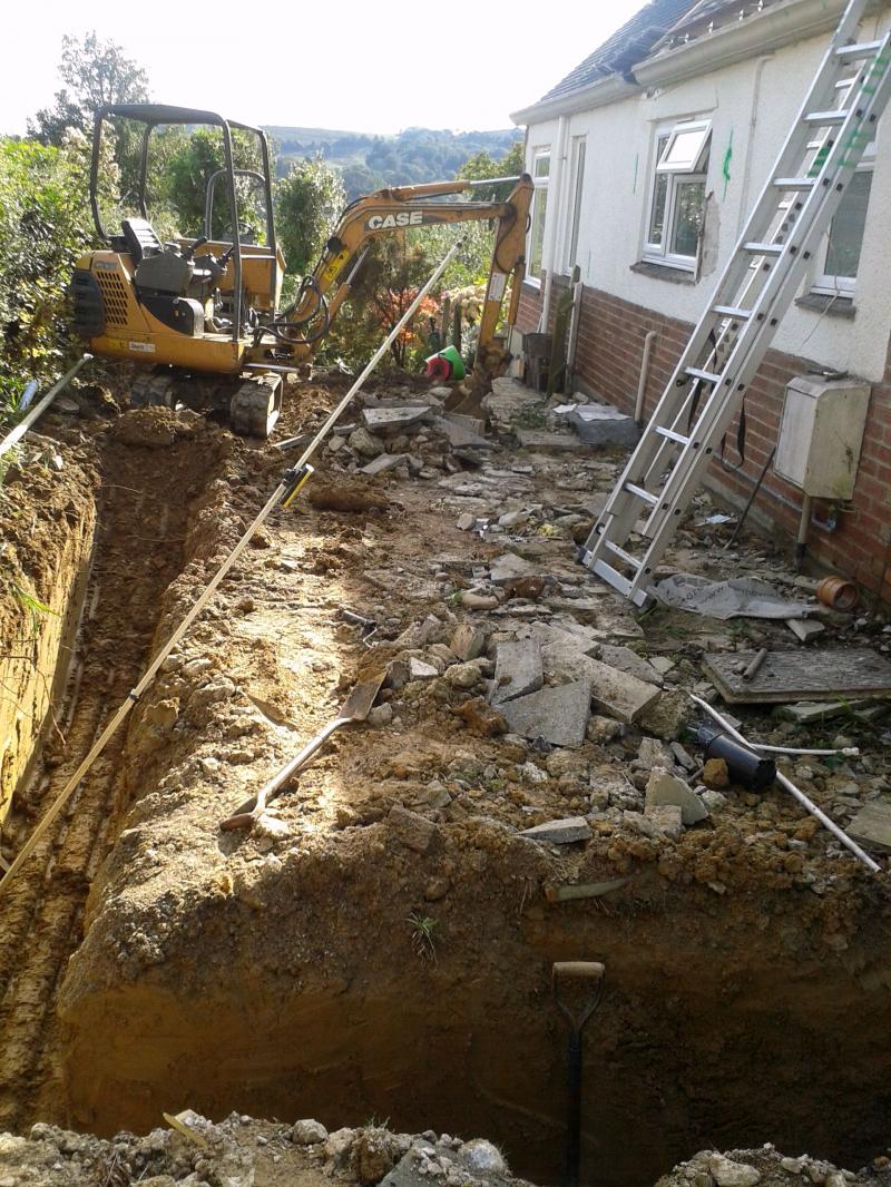

On the 4th the digger arrives , will lift the rsj into place and start digging. will post some pic's to amuse / empower if I can do it so can you. BC

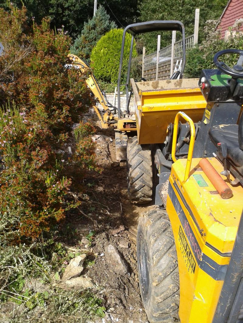

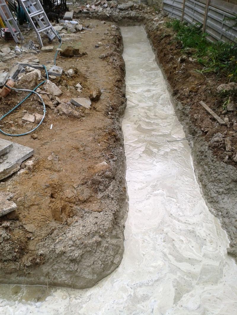

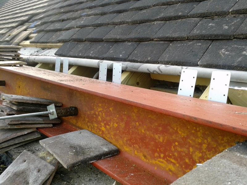

Well started properly on Friday and now have RSJ in position and level and attached to the roof joists. Dug the foundations ( mate with a digger most of my experience is from a visit to Digger land) and today (Tuesday) poured 12 tonne of concrete in, dragged it round using rakes and timber .
Next job is scrape floor area, block work to DPC. Then hardcore sand and insulation and screed.
Injuries = one blister, several small cuts to arms and legs.
Problems = gas was not where it was supposed to be ! no smoking on site.
RSJ needed a push from a digger to make it fit under a timber beam, apart from those minor issues I am not too stressed.
