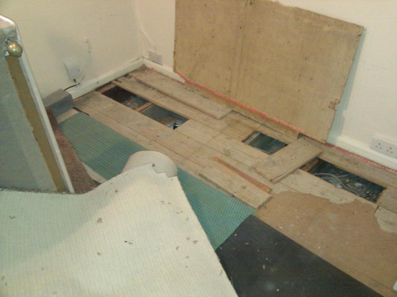

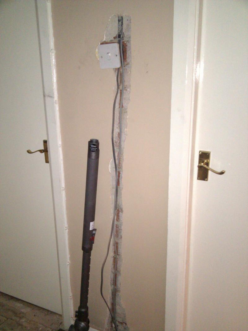

Got myself a first home and already have started to destroy the place (rewiring all the electrics) so while carpets and floorboards are ripped up and running electrical wires in walls it seemed like the perfect time to start my home av/automation project :mrgreen: Although wishing I never started anything after only a month in :?

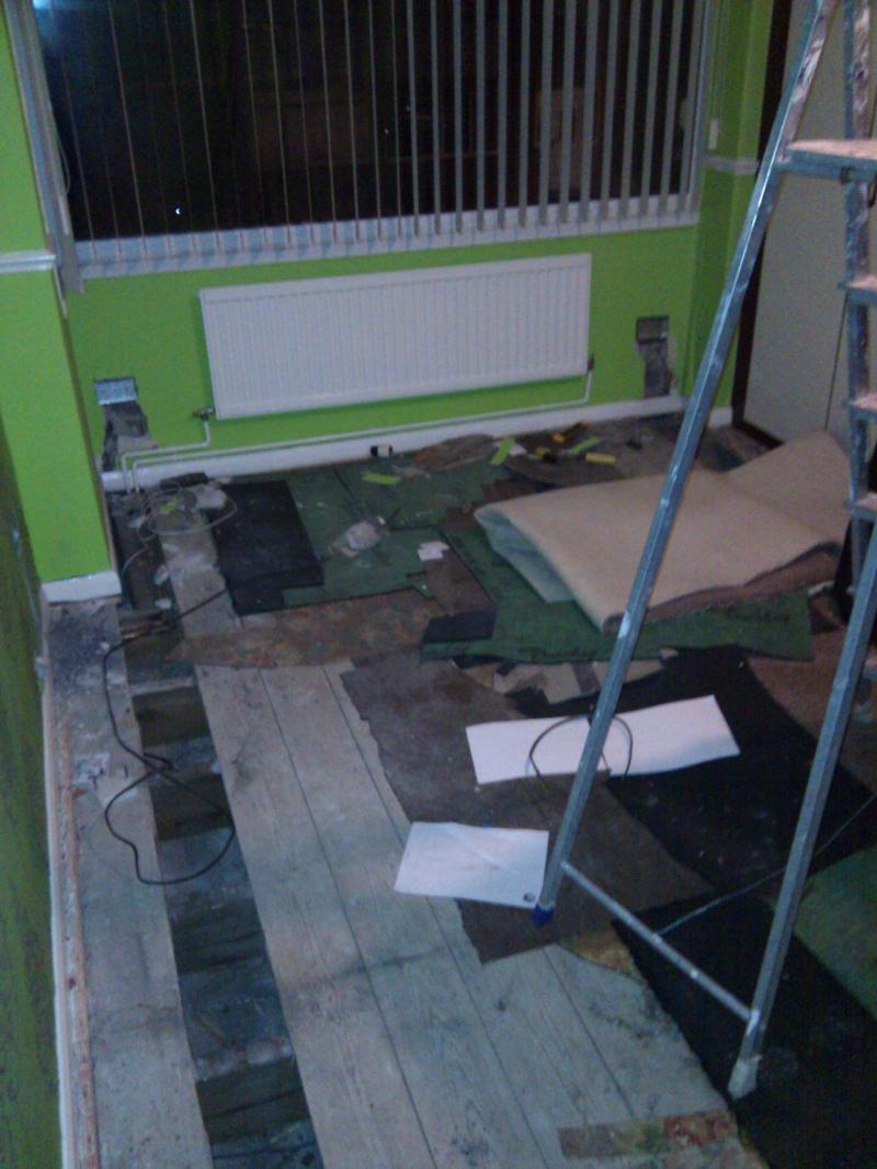

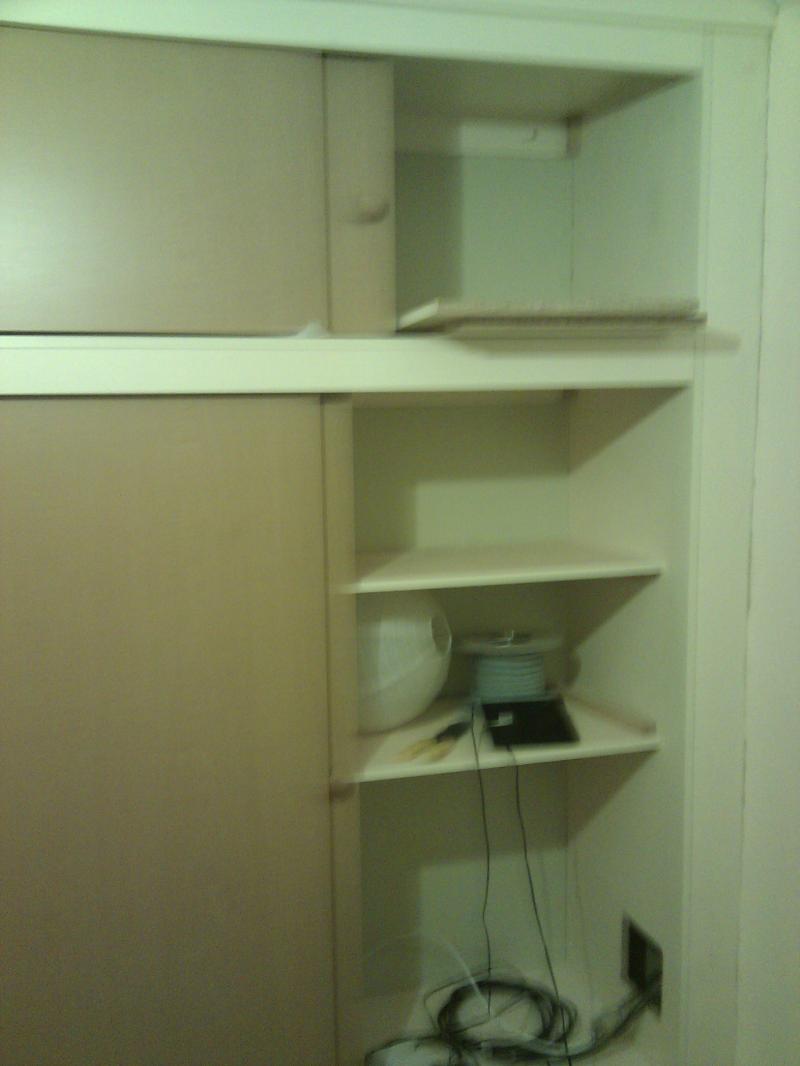

So far I have a perfect spot lined up in the box room for centralising all equipment (sky, microserver, router, NAS drives, XBOX, Wii, etc.... my plan is then to distribute all this throughout the house over various media. as the upstairs electric cables have been done (and plastered before I realised oooops no media cables........) it’s now time for media. my thoughts are to have 1 x 2 gang on various walls of the bedrooms and the same on the wall in the room behind the TV (when its walled mounted). I am thinking of the following combinations for each of the bedrooms not thought about downstairs yet as I am working on the bedroom first so I can stop sleeping on the sofa.

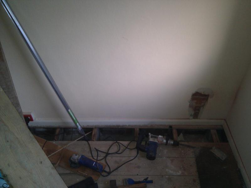

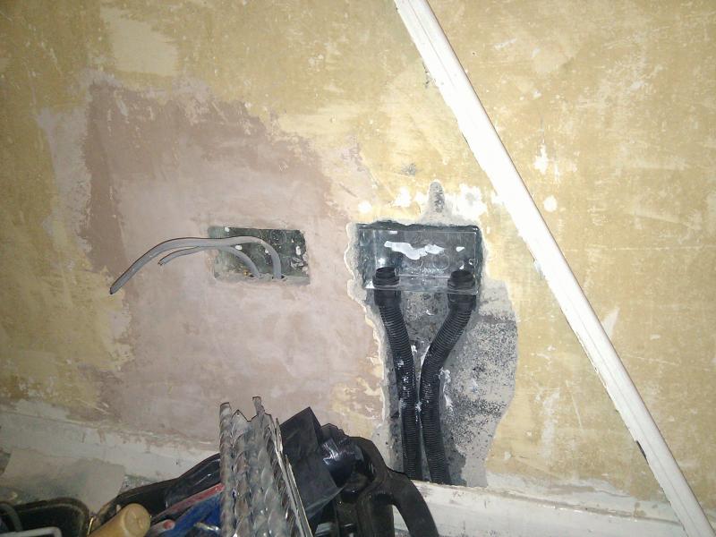

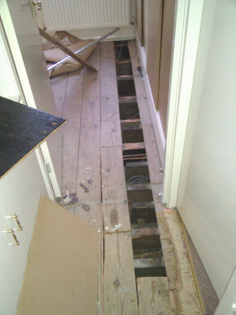

For the bedrooms I am not bothered about any speakers/audio etc.. And thought is I could use a spare cat5 to do something should I ever desire. the back boxes are 47mm deep as to accommodate the HDMI jack (scarily my internal breeze block walls are only 75 thick ......) I am then running 2 x 25mm flexible conduit from the socket to just under the floorboards so cables will not be buried in plaster. I could have run the whole conduit to the central hub but the angles and drilling through joists etc... made this idea a non-starter and I have no issues with moving a little furniture and pulling back the carpet to lift a floor board or two as I will just screw them back down making it easier to get back up.

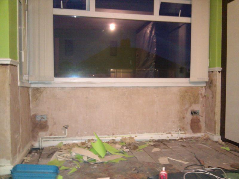

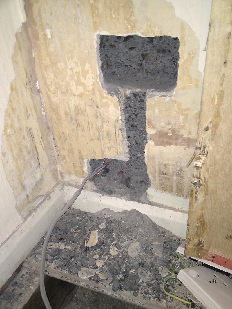

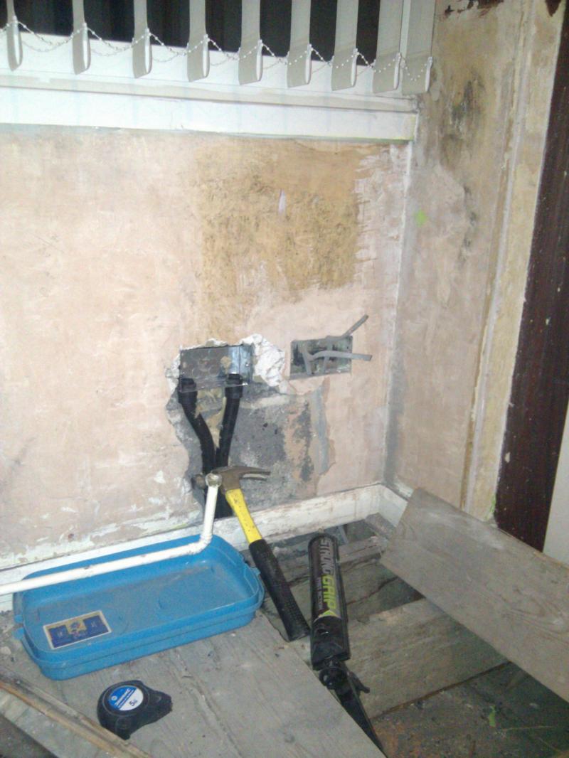

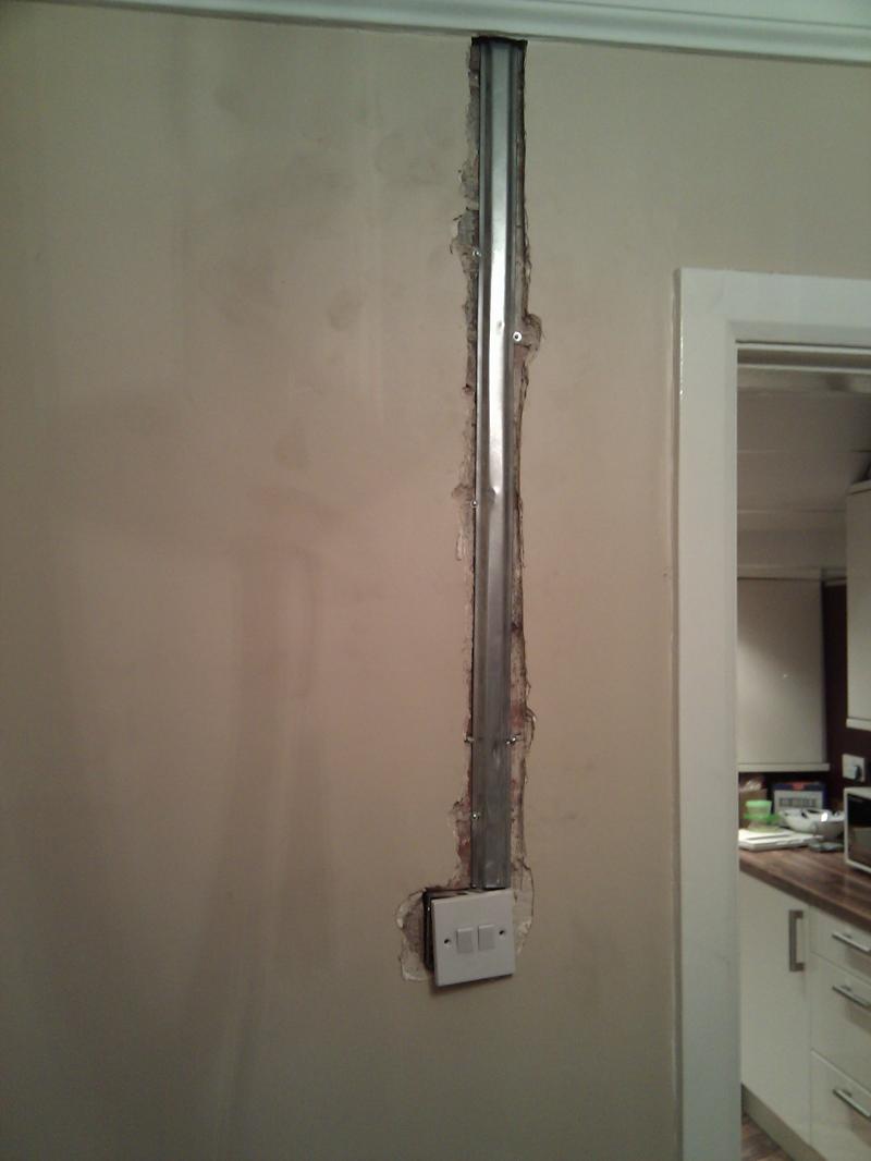

My plan is to wall mount the TV and channel out some of the plaster for the cables. I am not 100% sure how deep I will be able to make this channel as it is engineering brick and quite tough. I am also thinking that I am not going to be able to put a deep back box on the wall as it’s definitely a loadbearing wall and single brick. No idea if it’s a good idea or not to take out such a sizable chunk for a back box. Ideas anyone? For the back of the TV I wanted to have a similar setup to the upstairs with HDMI, F connectors, cat5, usb charging with the addition of a double socket for power. Things like the kinect for Xbox, portal (skylanders), would then be sent over cat5 and probably will need a converter that allows for localized power.
Also to make things slightly more fussy/problematic I currently have coving in the room so channelling behind this and running cables this way might be more difficult. plus my plastering skills to patch the channel might be noticeable so I was thinking to drill right through to the other side and then either chase up into the brick or chase horizontally into the plaster and sink some trunking into this and hide with a shelf (this then goes into a cupboard and I can trunk up into the ceiling to my media cupboard.

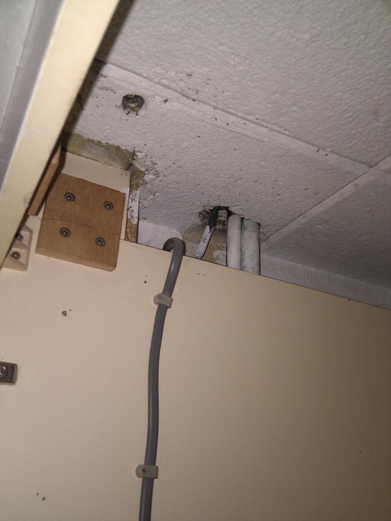

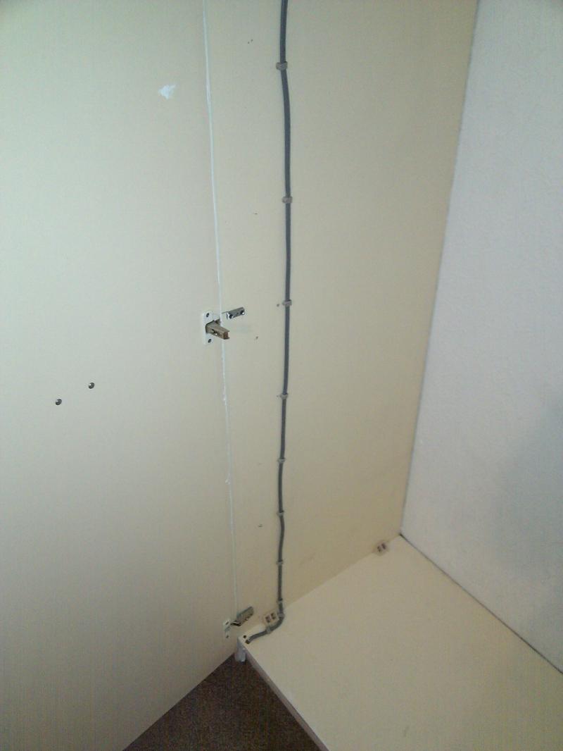

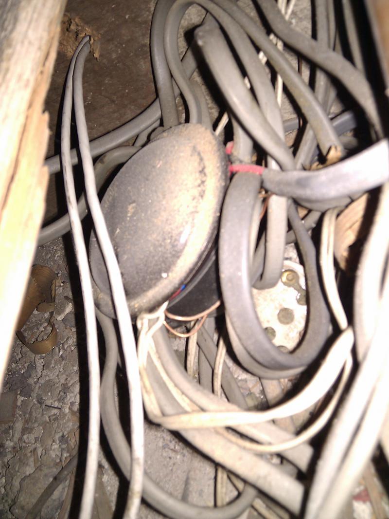

looking forward to feedback, comments, ideas, being told off, laughed at, etc.... from you all :D and pics all in my gallery (not sure if adding them to this post will be too big). Got the feeling that if it wasn't for a suspect electrical cable going through the wardrobe to the loft none of this would of been happening as I wouldn't of investigated and done a rewire :roll:

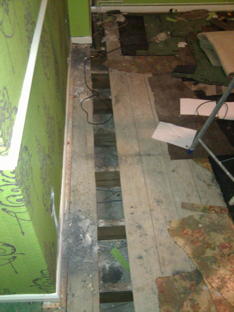

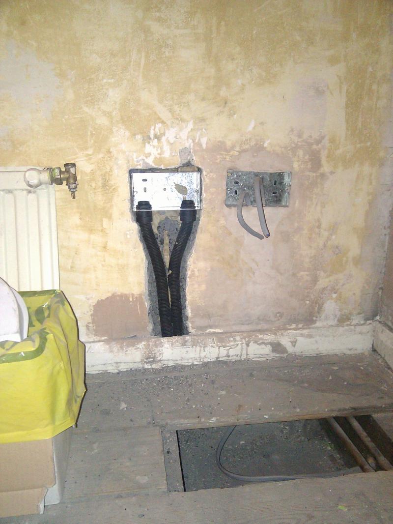

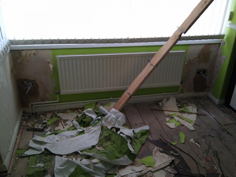

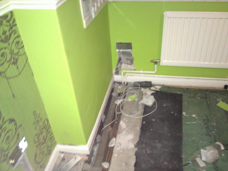

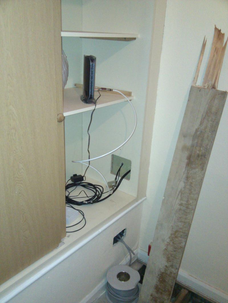

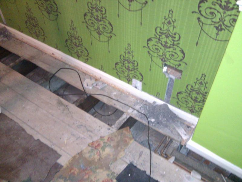

Office/Central Hub Location:
Guest Room:
Hallway, Dining Room
Master Room:

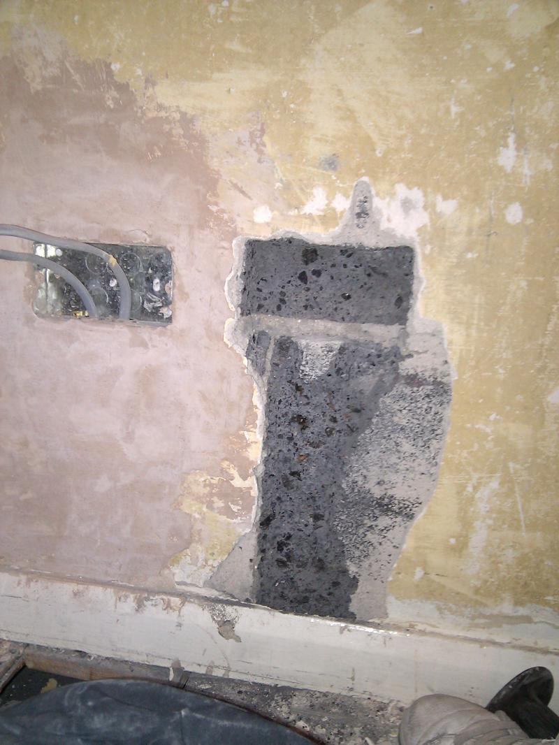

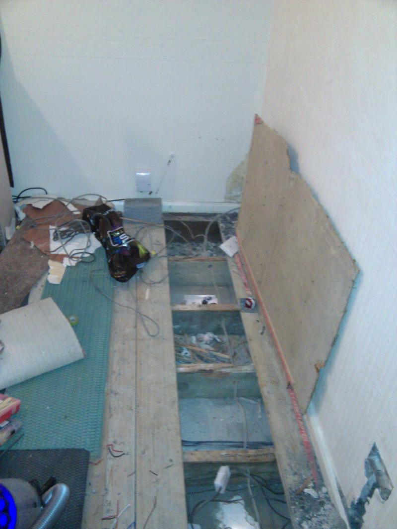

Not learnt to much yet apart from my internal walls are quite thin and I have cavity wall insulation :mrgreen: learnt that by chiselling a brick out and breaching the cavity :roll: ooops quick trip to b&q for a bag of ready mixed mortar and happened to find a breeze block under the floorboard to cut nicely where the brick was meant to be :lol:

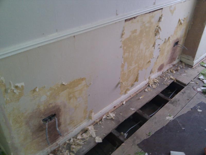

Floorboards screwed back down using some floor-tite screws from local merchants and they hold well and self counter sink.
One bit of advice I can give is don't fold back your carpet when lifting floorboards. I kind of knew this already but didn't expect to leave it like that for so long and now its a bit creased :cry: have to get the other half to get the iron on it :mrgreen:
One room is nearly decorated and electrics and AV in, then can finally get a bed in a sleep. will post some more pics shortly and give an update.
