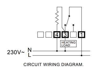

I think you may be correct about the third (Grey) wire being part of the fixed thermostat. There is a Brown > 1 and a Black > 3 but also a Grey to 3 (though this could be part of the thermostat). Based on this, when my MPRT arrives I’ll replicate the positions of the Brown and Black wires to what is used in the downstairs one pictured and see how that runs. If the Grey turns out to be a proper wire and not part of the stat then I’ll aim to put that in with the Black wire because it seems to work in that config right now....
I have found the wiring information for the MRT1, and according to the diagram below, in reality, it should have a neutral connection connected to terminal 4, to operate a small 'heater' known as an 'accelerator' shown as the 'zig zag' in the drawing. This is a feature designed to make the old technology of a mechanical thermostat that little bit more accurate. It will work without it, but not at its best.
The full instructions for it and where I got the diagram from can be found on the Myson website here.
The wires connected to terminals 1 and 3 are the Live switching wires that you would need to connect to the new programmable thermostat. They are the only ones I can see in the photo, I think the grey wire will go to the 'accelerator' and will be an integral part of the thermostat.
I can't see a neutral wire connected to terminal 4 (more poor installation! :rolleyes:) but if there was one present, being a Neutral and should be isolated from the live wires and tucked out of the way when the new battery operated MPRT was installed.
