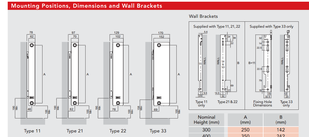

I was wondering if someone could help ?
I have Myson Premier Compact Radiators to fit.
I note that there are numbers stamped on the wings of the galvanised brackets.
On the narrower wing is stamped “Type 11/21/22”, while on the other wider wing is stamped “Type 11 Only”.
I have learned that range of single radiators are called SS, the double radiators are called SD and another which is between a single and a double is called SX.
The SS are seemingly the Type 11, the SX is the Type 21 and the SD is the Type 22.
When it comes to mounting either the SX ( 21 ) and Double SD ( 22 ) Premier Compact radiators should the narrower wing, which is stamped “Type 11/21/22”, be fixed to the wall ?
I have attached a snap shot from the instructions which is causing me some confusion.
I look forward to hearing from you.
