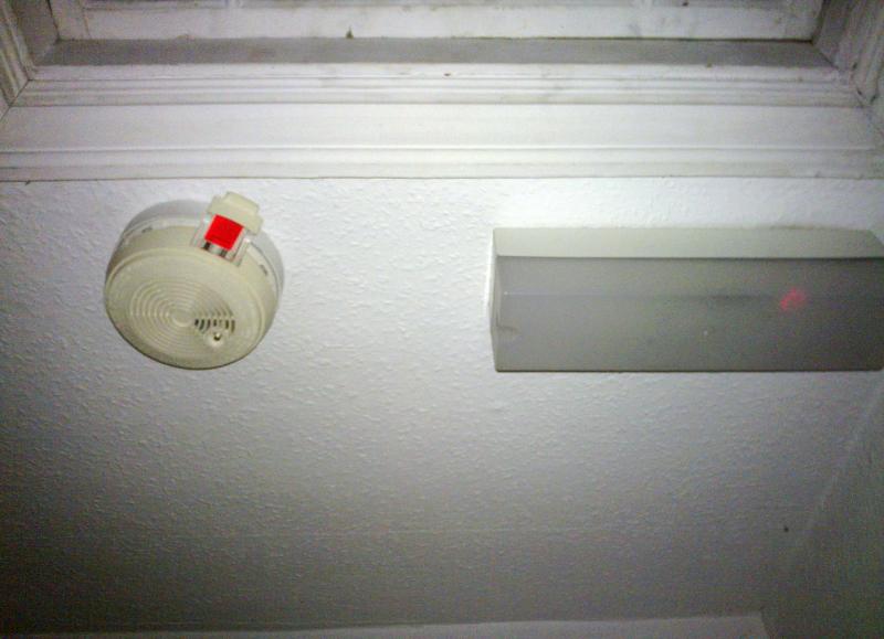

I've a dilemma. We've recently moved into a house that, at some point in its past was bedsits and has emergency lighting on each of its 3 storeys.

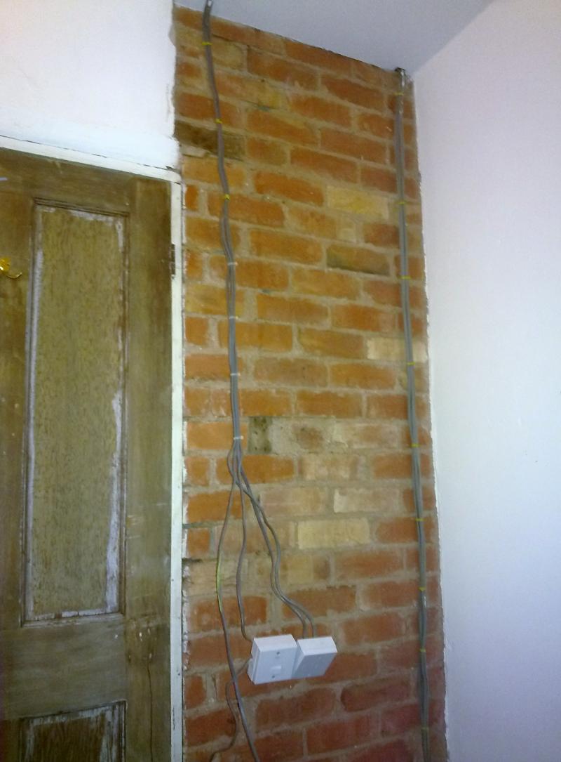

On the top floor, dangling from the ceiling are some rather mysterious electrics.

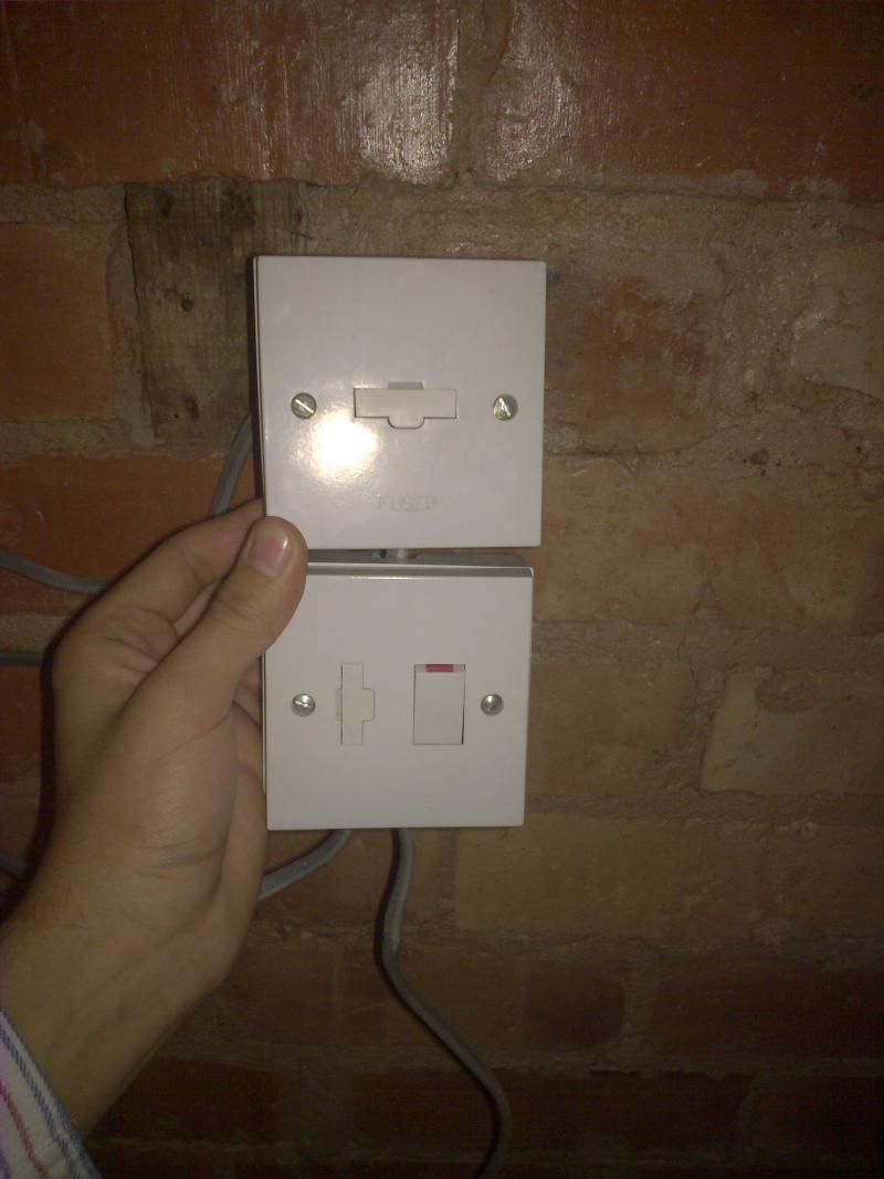

4 grey live, mains cables leading to a 13A fuse and a switch which also contains a 13A fuse. When the switch is OFF, the emergency lights come ON.
I was just wandering if there was a safe way to remove these cables so that I can then remove the emergency lighting around the house.
My main qualm is with the wires and fused switch dangling from the ceiling in a space I'd like to use.
Pictures attached
Thanks!

Thanks for the suggestion, that's a nice idea. I'll bring the wires down and run them with the ones on the right.

they aren't connected to the fuse box. How would I go about isolating these so I can fit a new fuse and switch and move the cabling?

When you kill the power to the lights, the battery WITHIN THEM kicks in. This is how they work. You wont get the lights to go off without applying 230 volts to them.
Isolate the fittings, let the battery run down (3 hours) and remove them.

Sounds, and looks like a bodge job. There shouldn't be an ordinary switch to turn the emergency lighting on. (or test it). Anyone of the previous residents could flick the switch, batteries go flat, thus rendering it useless when there's a power failure. Or a fire, then a power failure. Or a power failure, then a fire.
