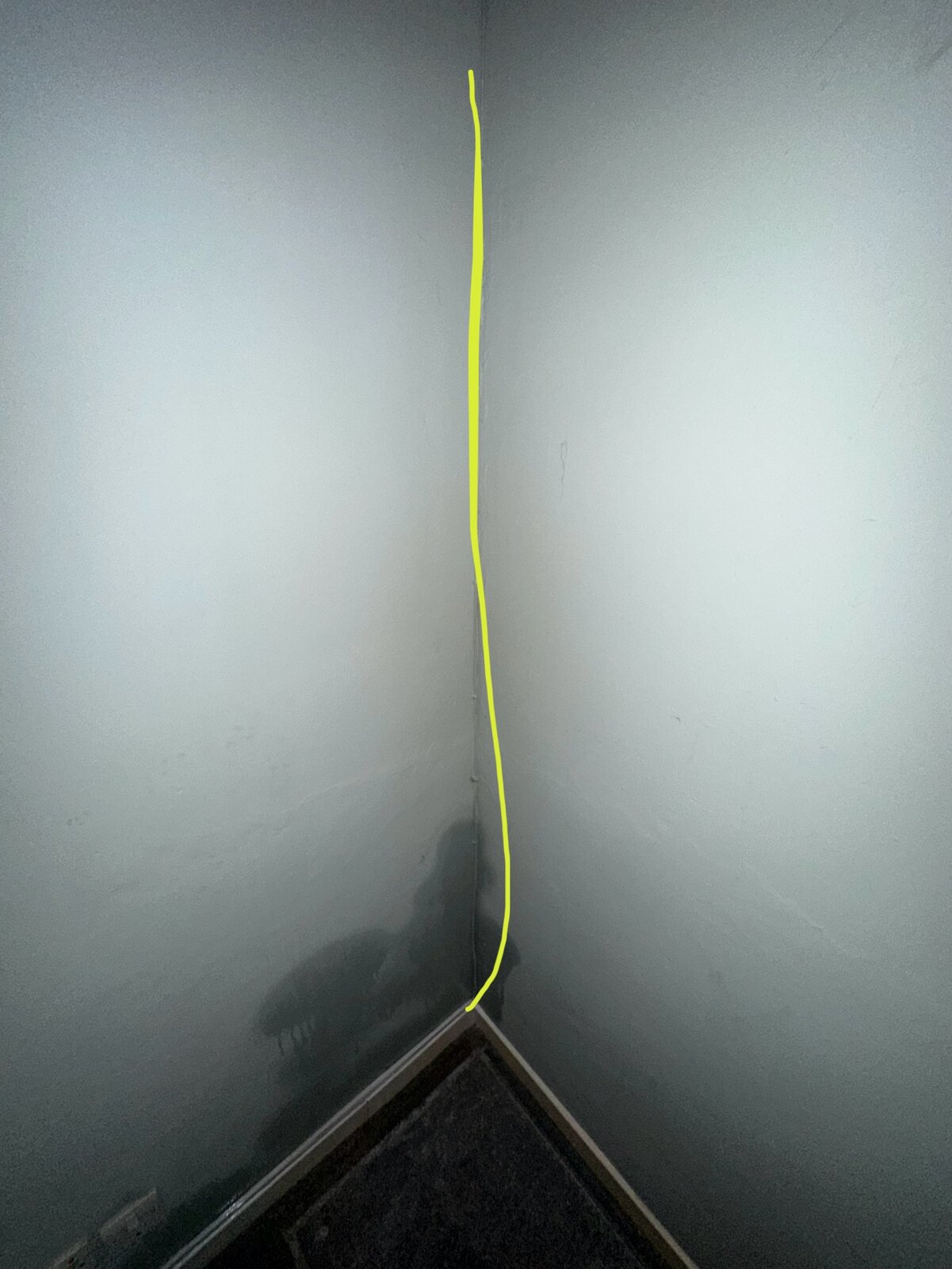

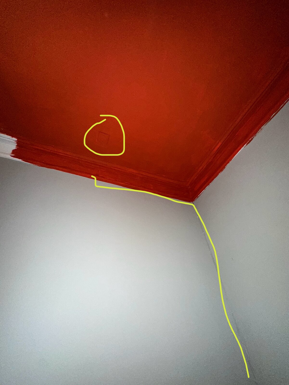

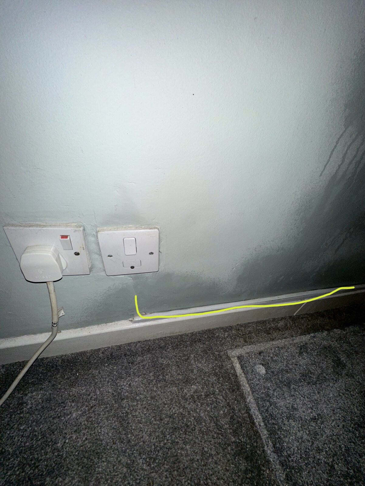

Hi,
In the middle of a renovation and discovered this mystery wire. It goes from a switched fused spur along the skirting then up the wall in the corner of the room then along the cornicing and disappears into the ceiling in line with a blank.
Just want to know how to remove it, what it could be for etc. Assumed possibly for an emergency pull cord system? But nothing on the consumer marked up for it. Would it be coming off the socket circuit given the proximity to the socket next to it?
Have tried to show the route the wire takes.

Might of been for a heater maybe.
As to how to remove it, I don't think anyone will be able to tell you how, you will have have to trace the cable and disconnect it.
Ok, thanks very much.
In theory, if it’s a spur off the socket next to it, could I terminate the cable coming from the socket into a blank which would take the place of the switched fused spur and then remove the cable that runs up the wall?
If there is only a single cable connected to the FCU then just remove that too. Then you can remove the unused back box, fill and decorate over.
The plaster between the socket and FCU looks uneven to me which suggests a patch job and that the socket indeed is likely supplying the FCU.
I would say the next thing to do is to open up (with the power off) the socket, FCU and the blank plate on ther celing and determine what cables are present and what is connected to what.
I guess you need to check to see if the single socket is on the ring or is a spur.
