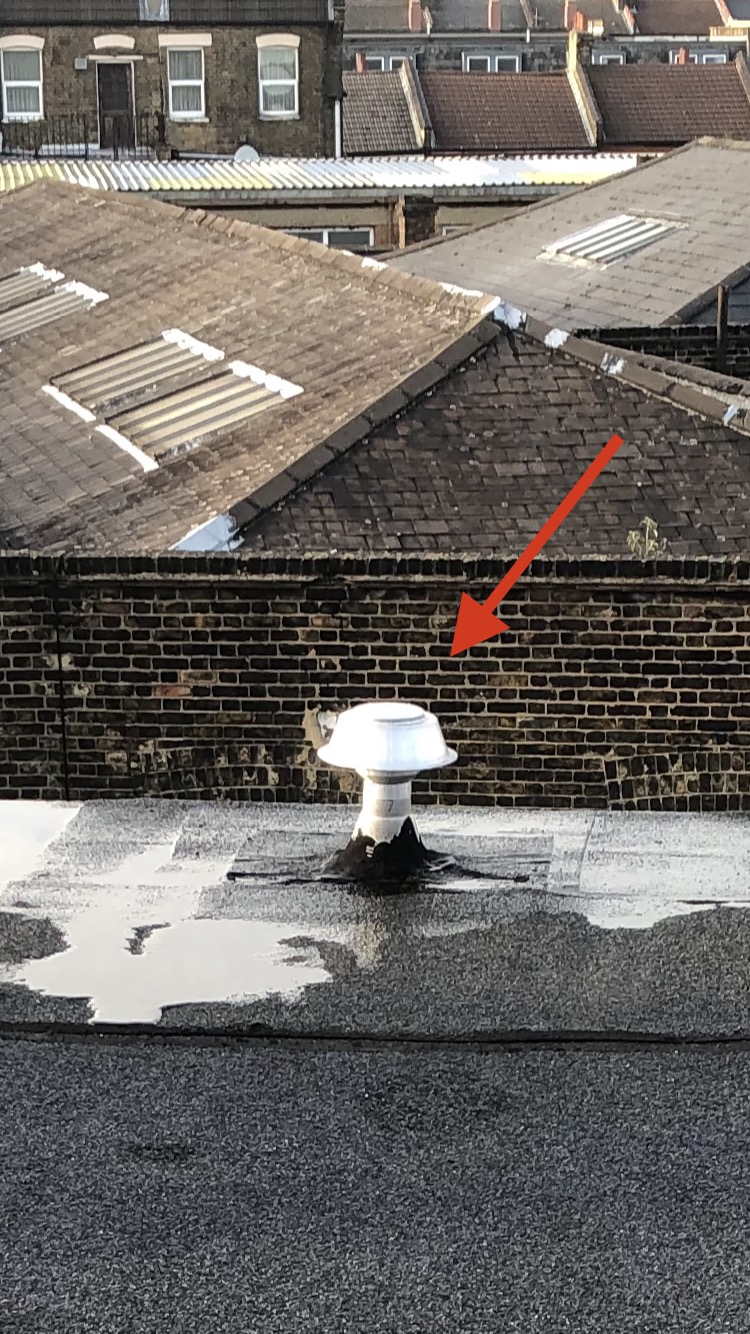

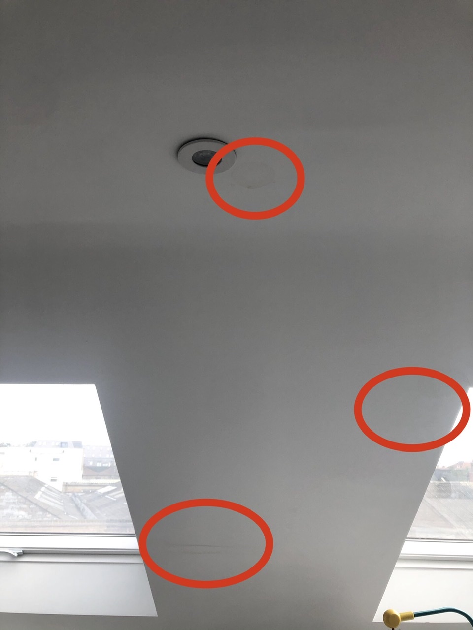

Hello again
I’ve discovered a new damp patch on the ceiling higher up now.
I’m wondering if the issue is at the flat roof above as previously suggested and is running down between the windows to the original patch I found

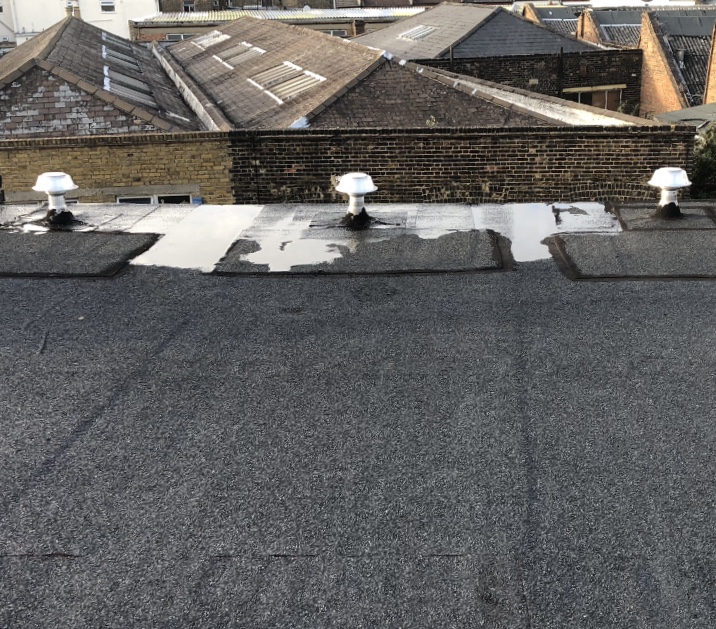

there is a vent centrally above in this area (one of three) and I’m wondering if the issue could be there
when it was installed retrospectively (after a building control request) the builder added extra layers of felt and bitumen paint around it, but I’m wondering if this could be the source
any thoughts?

would you say it’s a big job? Could just the front section of the roof be redone? (it’s only 2 years old)
And how urgent would you say based on the patches discovered over the last couple of months
the builder is away but says he can come back next month
To be honest all the felting looks poor never mind the vents.
Get a good felter to look at it close up

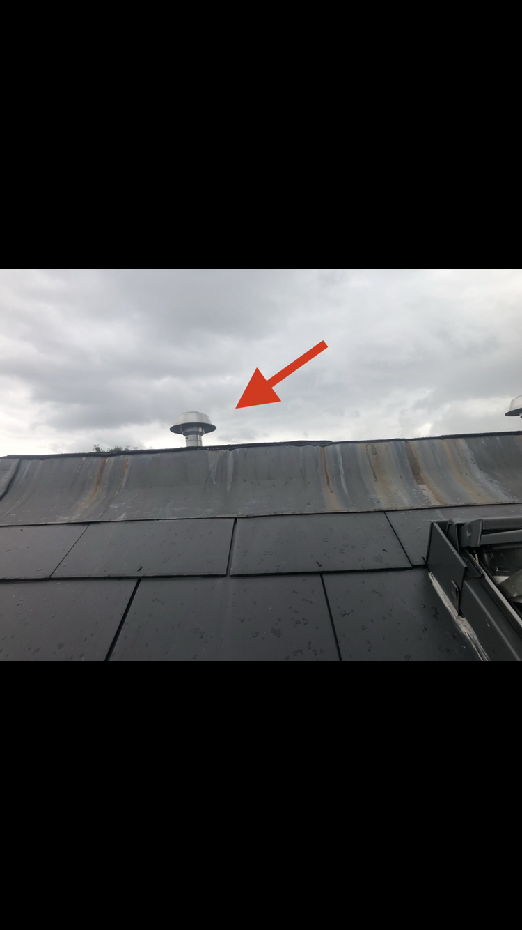

To give an update
the builder has returned and replaced the felt at the front section of the roof
I was on the roof with him and saw that the old felt had not stuck sufficiently at the front and had water underneath when pulled up. So it seems that your initial thoughts about the felt being the issue could well be accurate. So thank you for that
hopefully the replacement felt will solve the problem
as an aside, there was some evidence of water inside one of the vents, so it might be that some water is able to get in via a vent in very windy/heavy rain, but I’m hoping that’s minimal and rare and the main issue was the felt which has now been replaced
