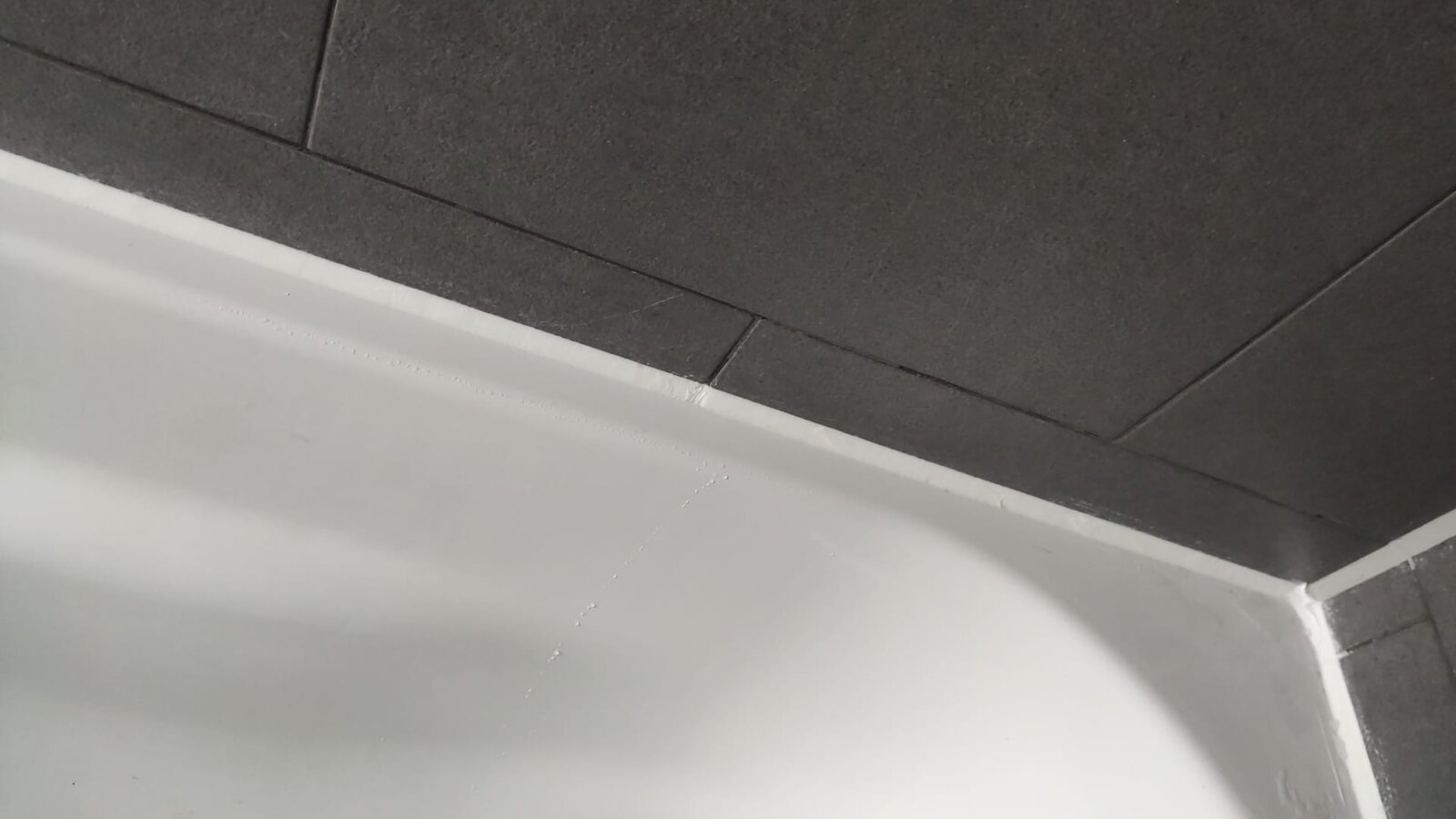

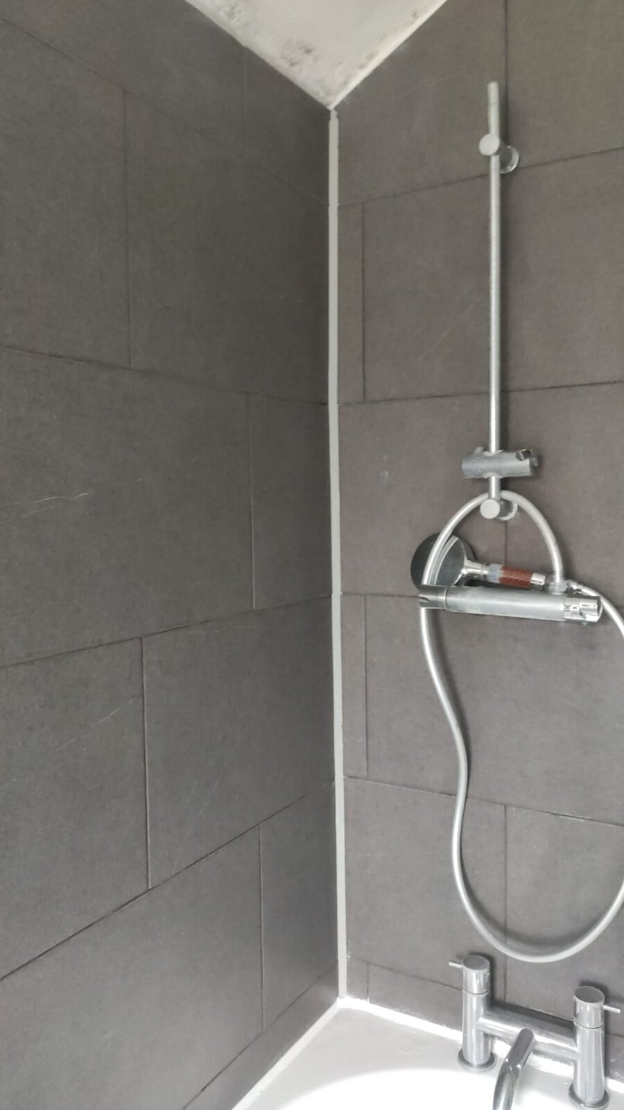

I have a leak in my bathroom, through the tiles.
I have had a tiler come out and re-silicon the bath (twice), Re-grout the tiles and then re-seal them.
They also took the grout out of the corner join
The tiles are un-glazed porcelain.
The leak seems to be coming through up the wall. if we shower near the base where it meets the bath, there is no leak. If we shower up the wall it comes out of the bottom like a stream.
All of the above steps have done nothing or worsen the leak...
Any ideas on steps to take before re tiling the bathroom?

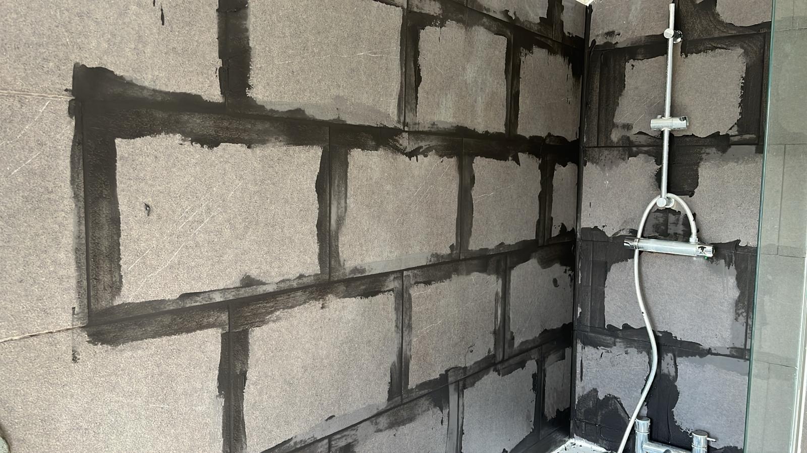

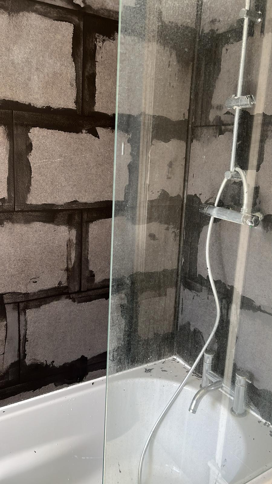

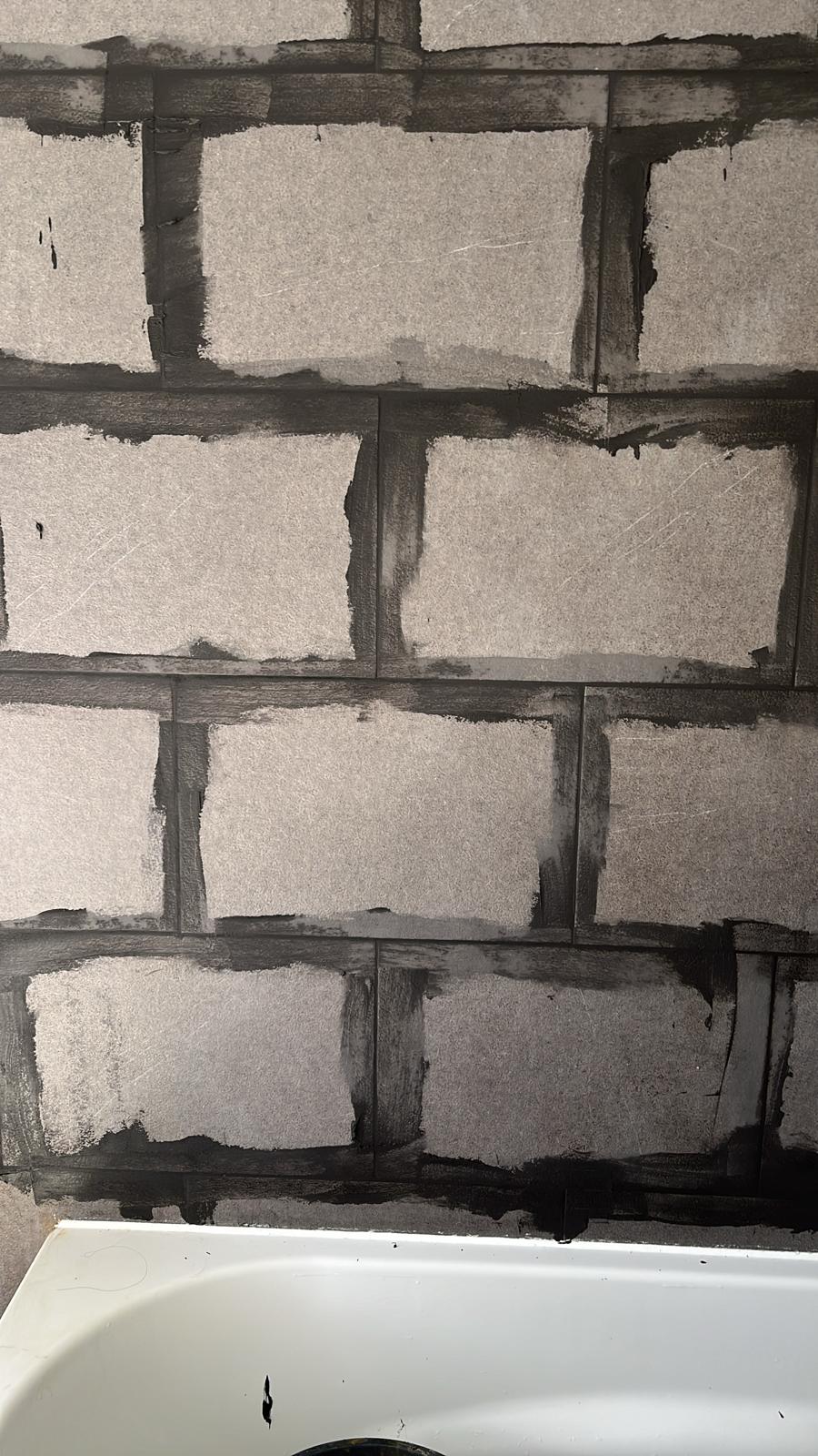

Unfortunatley tiles, tile adhesive and grout are not a guaranteed waterproof barrier.
What are the tiles laid on? Plaster board? Plaster wall? Cement backer board/some other backer board?
Usually only a backer board clad wall with a tanking system applied which seals it to the edge of the bath will be a guarantee-backed way of doing this. If when water hits that wall it may be getting through the grout and/or silicone somewhere and down a void in the tile adhesive, and past the edge of the bath

My advice, remove and replace. Maybe consider boards.

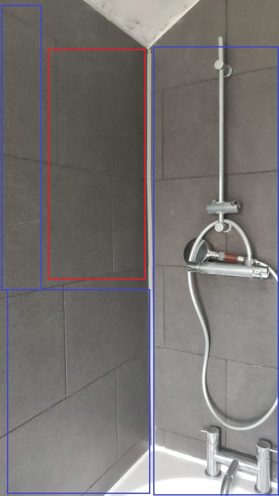

In the picture you can see where the leak starts in red. The second you put the shower on there it leaks straight out like a stream. If I shower on the blue areas there is no issue at all.
This is why I have found it so strange to think it is something like porous tiles as there is so much water so fast. Also, the position is strange as the tiles underneath them are exposed to more water, so why would they be porous?
But if the gutter leak damaged the backing it would explain why there is a leak in that spot at least... Just the amount baffles me, it drips out the kitchen ceiling...

You maybe have cracked tiles or as we said before, incorrect backer board and missing tile adhesive , so water getting through leaks behind and down.
You could try a leak stop tile & grout spray on all the tiles and see if that stops the leak. Look at screwfix/toolstation or amazon, they all have them
If that works its a cheap fix but youll need to keep applying it
Otherwise remove and redo. If tiled onto plasterboard - thats your issue
