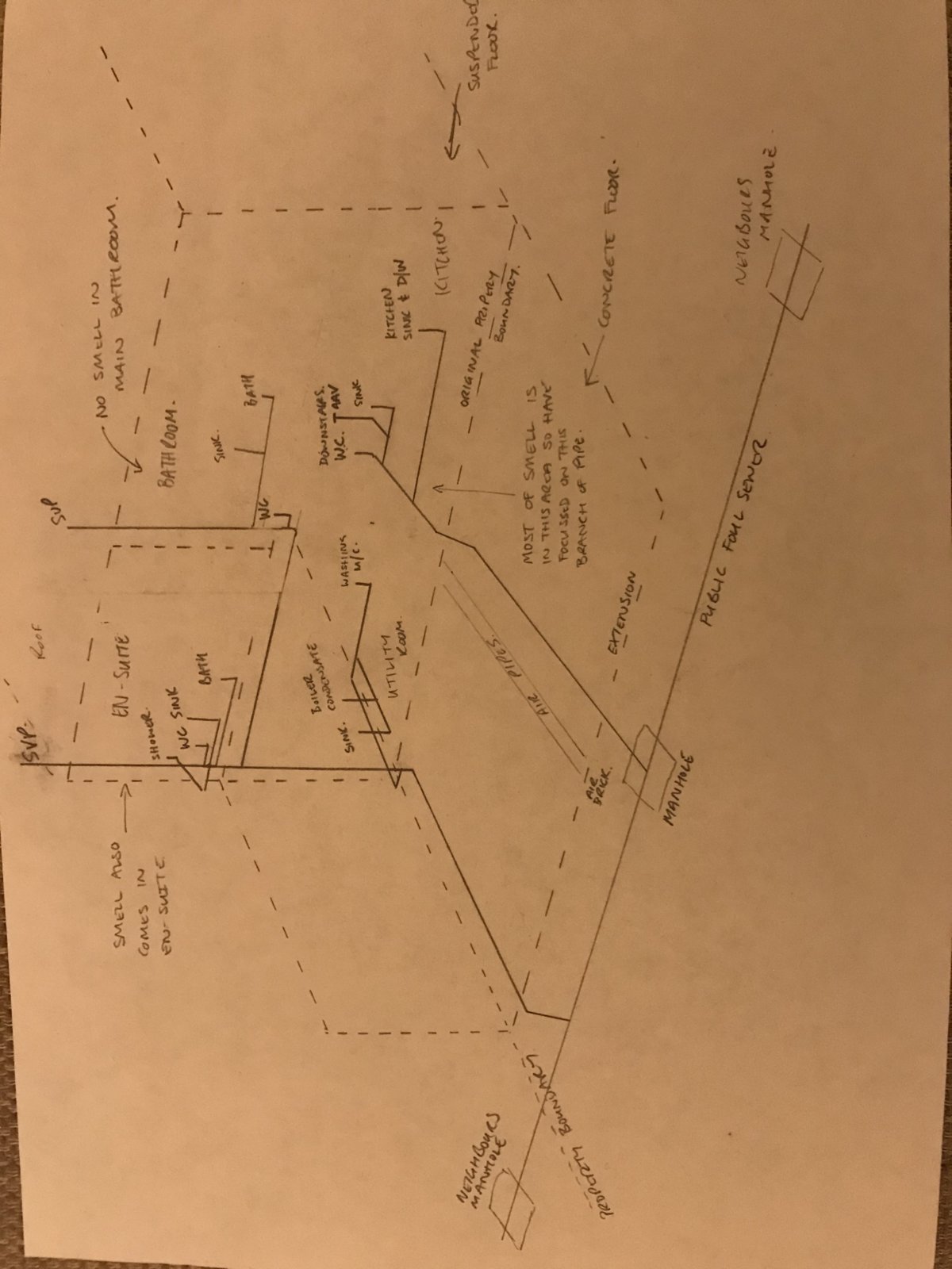

Hi, new poster hoping someone might be able to help me with an issue that has me at the end of my tether! For almost a year we have been experiencing intermittent sewer gas smell in our house. 2 years ago we had a rear extension done, including a downstairs WC, which involved re-routing some of the waste pipes under the house. The smells that we have had tend to be from the area around the downstairs WC, but mainly they seem to just come from underneath the floorboards.
Things I have already done: -
Checked all traps and joints and repaired/replaced where necessary (some improvement made but smell not eliminated)
Had CCTV survey of pipework to exclude blockages and /or damaged pipes (all clear except for identifying a buried inspection chamber we didnt know about)
Smoke test (nothing)
Water pressure test (found a couple of small leaks which were fixed)
Removed inspection chamber that was buried under extension (no smell from chamber when uncovered, took it out anyway)
Had plumbers from 4 different companies come and look
The smell comes and goes, usually worst morning and evening - seems like weather/atmospheric conditions determine weather the gas is flowing away from or toward the house?
Any advice or ideas welcome - the plumbers I have had out all basically said I had already done everything they would have tried..... :(

Some diagrams of the extension and pipe runs may help to inspire.

thanks, here is my best shot at a diagram, hope you can make it out. Solid lines are pipework, dashes are walls
we have air bricks and pipes running between the air bricks and the cavity under the floor of the house, because the extension has a concrete floor

No drawing attached!
And we need one to understand the layout because you previously said...
And then later said...
the drawing is within the quoted text

With a similar problem to yours it turned out that the cavity below the dpc had not been filled properly & when the public sewer cracked on the boundary foul water seeped through the ground & into the cavity below ground level but the smell came up under the suspended wood floor. Took a long time to find as the smell was intermittent.
How did you do the smoke test? Looking at your plan i’d put a pellet in a small open tin and push it slightly up the branch in the manhole.
You might not see the smoke but you should smell it so have a good sniff near everything inside.

Looking @ the diagram - there are 2 places the smell comes + goes - I would get those manholes lifted and look for any partial blockage/water not flowing quickly . Your Water co. should clean and cctv the run, The random occurence of the smells makes me think a partial blockage that gets worse as the main flow rises- @ random times . As said could be a broken pipe also.
I may have the solution. Looking at the diagram i would be checking the two bath traps what depth of seal are they??
Its very common nowdays for plumbers to fit bath traps with extremely shallow seals as there easy to fit. However let the bath contents go and it will suck out the water trap.
