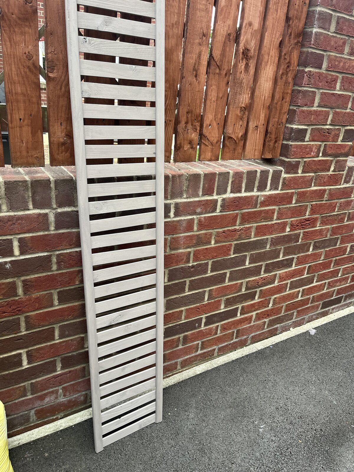

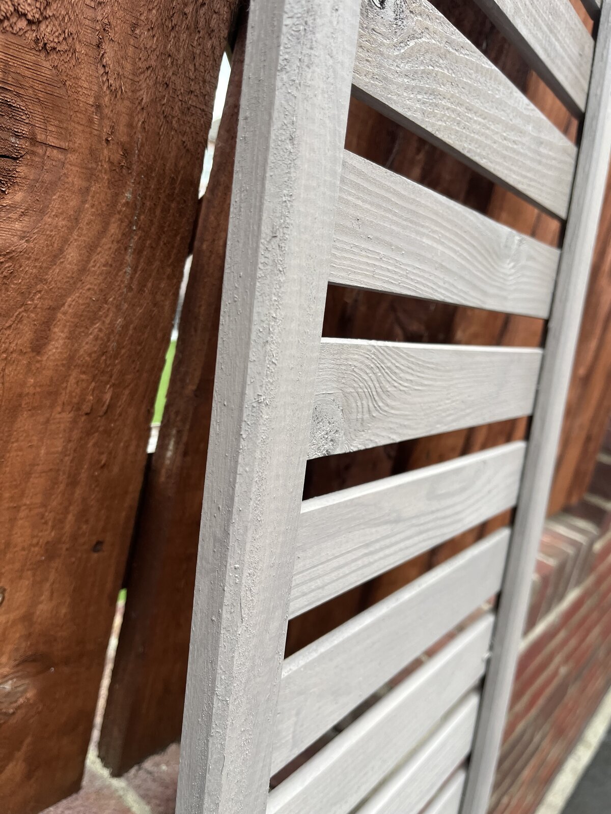

So I’m fitting some new trellis to the top of my fence. Question is am I better using nails or screws? What’s the best size to use ?

Use screws. Don't nail it because when you try to whack them in you'll damage your fence.
Length - it needs to be long enough to go through the trellis, and far enough into the fence to hold it without going through it. 30mm into the fence would be a minimum. The screw doesn't need threading all the way along, it can have no thread in the 30mm or so where it will be going through the trellis.
Torx head is good for driving, if you have a cordless drill with the right drill bit.
