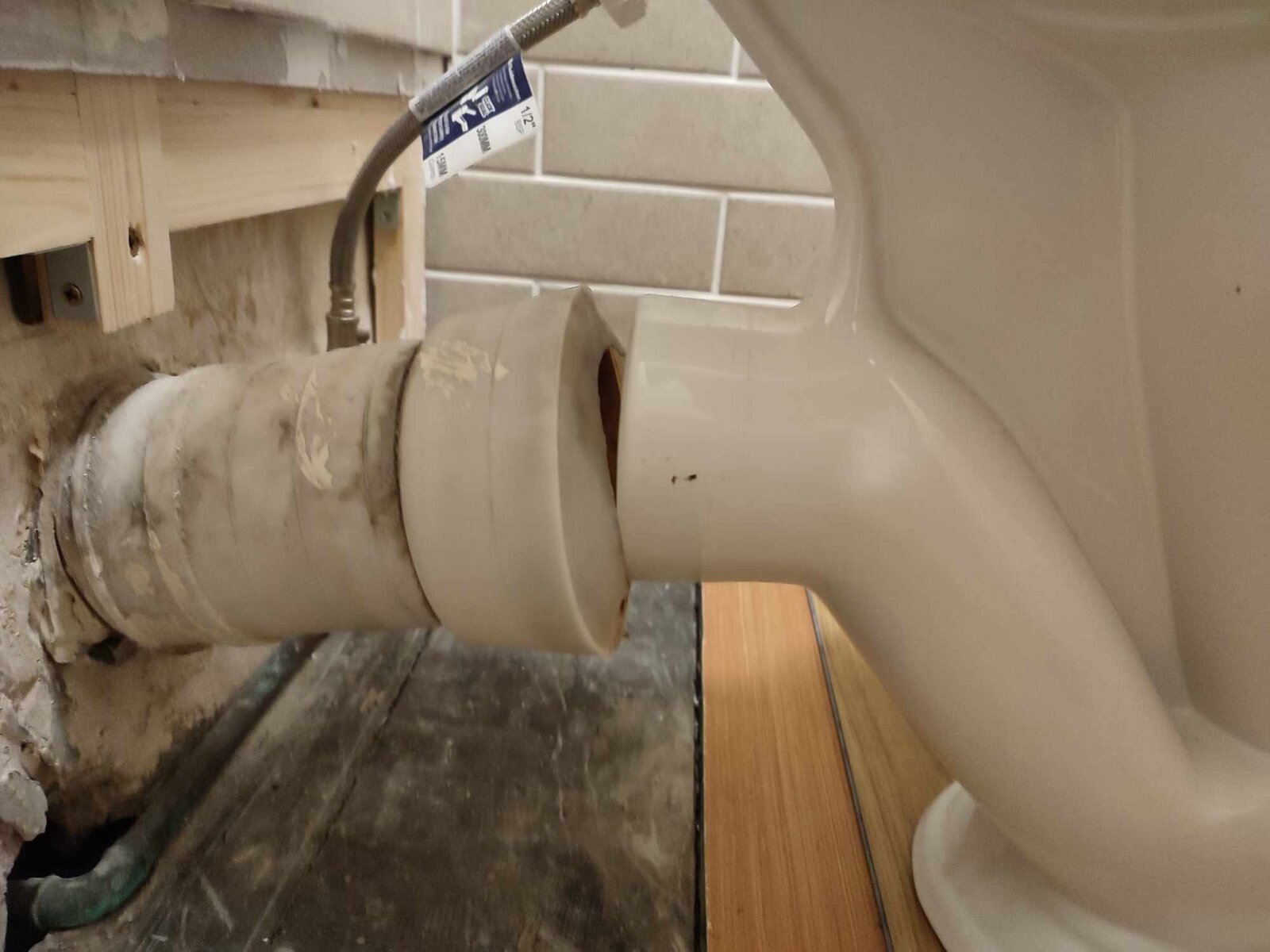

I'm in the process of refurbishing a cloakroom and replacing the old close coupled toilet. The multikwik pan connection is cemented into the wall, and there is a cast iron soil pipe on the other side of the wall. I want to avoid having to remove this connection if possible. I've attached a photo of the connector.
The outlet of the new close coupled toilet I will be fitting will be higher than the old one due to new flooring being fitted, so it won't fit onto the multikwik connector.
I'm looking for advice on the best way to connect the new toilet to the existing fitting. I've seen online that you can get a multikwik multilink fitting and then use an offset connector to connect the toilet.
Would that be a good solution, or are there any better options?

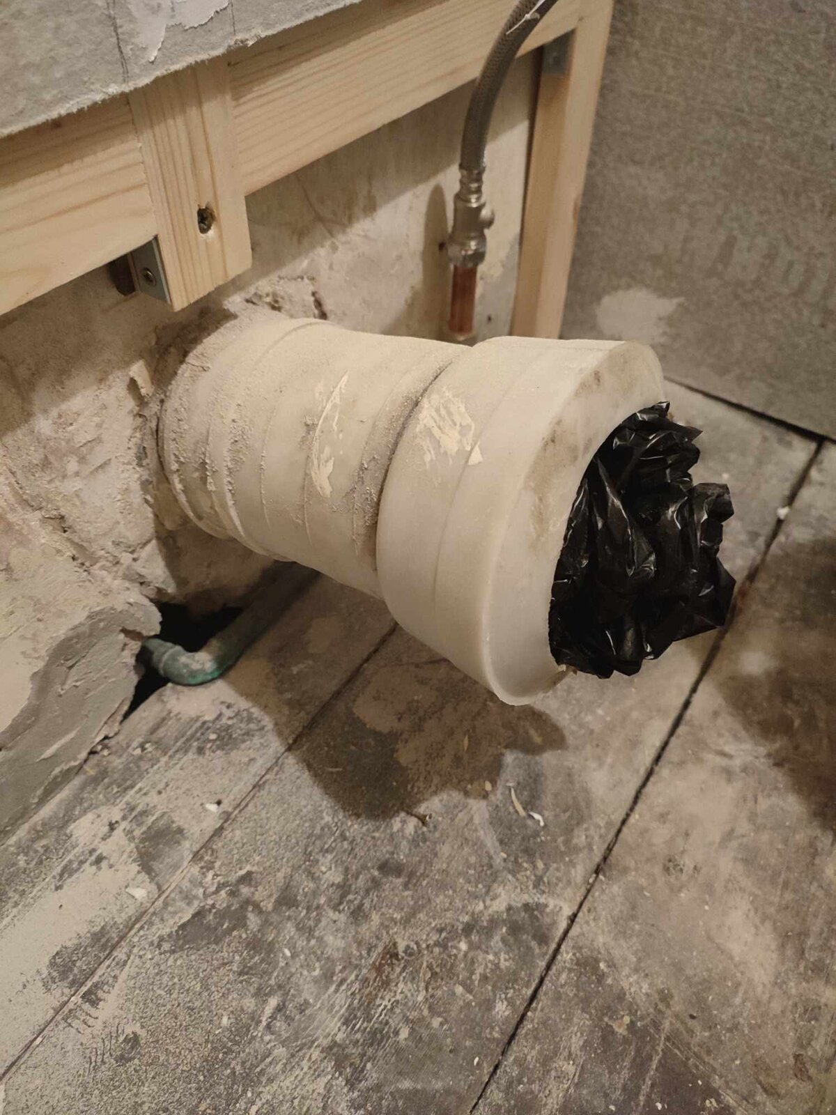

The height difference is around 15 mm and the fitting is at an angle of around 18-20 degrees. I've had another look at the fitting, and its not fixed into the wall and could be removed. I twisted it a bit and pulled it out and I could then see the fins that connect it to the soil pipe.
Would I just need to fit some kind of soil pipe extension, and then a multikwik offset connection to that?
