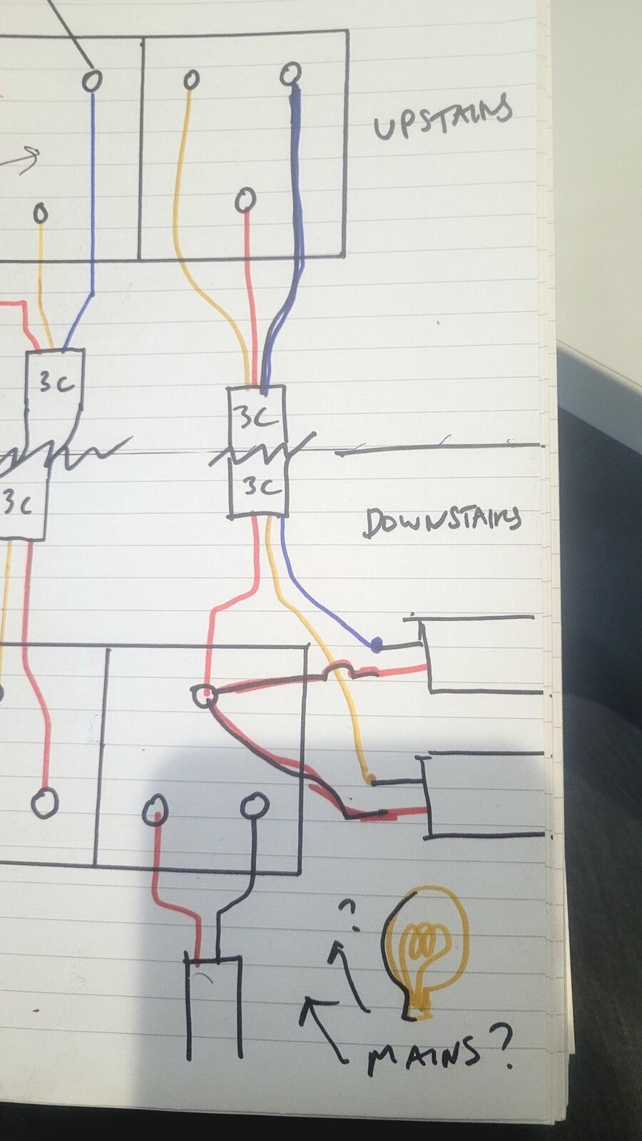

Hello,
I have two, two gang, two way light switches, one upstairs and one downstairs, I have figured out one side, but the side that controls the light downstairs from upstairs and downstairs, I can't figue out what's going on.
Upstairs, it's just the termination of the strapper three core cable, but downstairs is a mystery.
As well as the strapper cable there's three twin and earth, but I can't make head nor tail of what is happening.
The lighting rose doesn't have a loop in it, just the live/neutral, so I suspect there's a juncton box somewhere.
If I knew where the cables went then it would help alot, but I can't figure out which one is a live feed or goes to the lamp.
Hopefully someone can help me figure it out, thanks.
Did it work before? Have you changed the wiring?
Looks like you have feed in, feed out, supply to light and the 3 core at the downstairs sw.
I think.....
Have you got an actual picture of the switch wiring?
It does work, I haven't touched anything, I will try and get a picture but it's a bit tight in there with a jungle of wires.
If it does work there will a JB somewhere which will clarify the circuit.

I was wondering if the American method had been used, where the neutral was used at the switches! Lets hope not.
I was wondering if the American method had been used, where the neutral was used at the switches! Let’s hope not.
Live in L1 and neutral into L2 with switched live into com?
Based on the OP’s drawing it doesn’t look like that.
However, they aren’t uncommon with the old type of switches.
