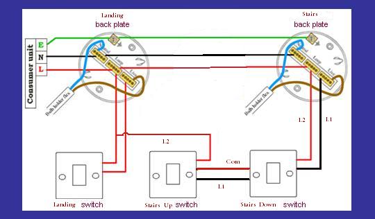

Hi guys,
Hopefully you can help. I am renovating a house and have just switched my hall and landing light from a rose downstairs and a three spotlight light upstairs to standard decorative ceiling lights. The switch unit downstairs has two switches, one switches the downstairs light on and off and the other switches the landing light on and off. There is a switch upstairs on the landing for the landing light. For some reason I just can't work out how the cables should be aligned in the downstairs light in order to resume the correct operation of the switches and light. As I pulled the rose down the cables became mixed together. Can anyone please help? In the downstairs light I have 3 Neutral Cables (black), Live Switch Cable (Black with brown tape around) and 4 Live (Red) cables. Naturally I have 4 Earth cables too.
Many thanks in advance.
Chris.

I think this
is what you had?
I would not recommend continuing with that method of wiring. If the landing light and stairs light are from different fuse/MCB then a borrowed neutral can exist which is dangerous.

Thanks for the replies guys. I'm still a little in the dark. I understand 2 way switching etc and the landing stairs diagram supplied below was helpful but in my setup I have more going on at the downstairs light rather than upstairs! I also have 4 sets of cables coming to the light not 3 which complicates matters further. :(
In theroy each cable with twin and earth will relate to a single lamp and the triple and earth will be the link between switches.
In practice as I tried to show often line is linked from one switch in pair to another. Since this should not really be done one can't follow any set out system and it's just a case of ringing out the wires.
This may help... The best I've got it to work currently is the landing light switches on and off from downstairs only when the light downstairs is also switched on!
Try looking at each item as separate.
Basically you have two way switching x 2 at the switches.
For the ground floor light you would have main switch at ground and a cable from ground to next level to give the 2 nd switch function for the ground light.
For the 1st floor light you have the main switch for the light at 1 st floor, and a cable at ground for the 2nd switch function for the 1st floor light.
If all else fails disconnect all wires and find the 1 way switch for the relevant lamp, once you have one way switching then the cabling function should be clearer.
Please stop just connecting things up in different ways hoping to hit on the right combination by chance.
Go back basics - identify which wire(s) is/are permanent live(s), which are switched lives, which are switch to switch strappers etc.
Draw out what you have, and you'll then be able to see how to connect it up properly.
Thanks Holmslaw - I've done this but the upstairs light will only operate when the downstairs light is on with this combination - why does the downstairs light need to be on to operate the upstairs switches and light? -
Chris. :unsure:
