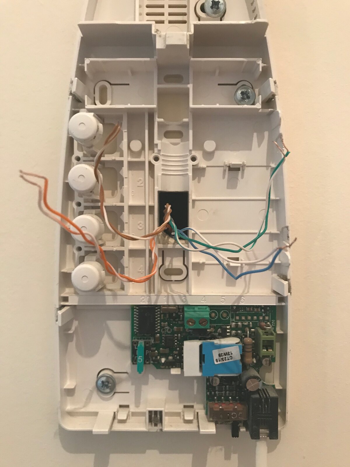

Hi all, hope you are doing well.
I live in a block of flats and I am trying to replace a BTICINO handset.( I am replacing it with an identical one - same make and model, no changes whatsoever)

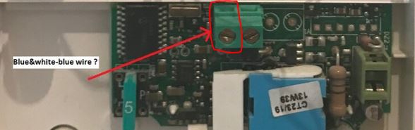

I took a photo of the wiring before removing the old handset but unfortunately it was deleted by accident and I can't remember how to wire it properly. The only thing I remember is that the blue&white blue were probably connected on the left (see pic nr.3) but I am not sure.
The handset has only audio and door lock function, no video. I am mostly interested in getting the door lock to work, don't care about the audio too much.
Can you please help? I can upload more pictures if necessary

Quickest thing to do is knock on a neighbours neighbours door and have a mooch at there's
Failing that see what wires go where in the panel by the front door
Blue and white would be my guess as the others are twisted together indicating they are not used , you have a 50/50 chance of getting the wires the right way around, they do go into the green connector block
Thanks for your reply. Blue and white blue went into the same socket (if that is the right word)

what makes you think you have the correct handset, they may look the same but are not. They do different technologies and the handets would look identical to look at just different inside. Why have you got all those cables if you only have a two wire system with two terminals and no pollarity if i recall. Very clever system controlled electronically using the little configurators which will be in the distribution blocks so you should not need to be concerened with that either.
The two wire systems litterally runs using two wires positve and negative so would many you have many unused cables. Why are they all stripped back if only two wire system unless it has been retrofitted from the 8 wire system, but if so they should have cut the cables back to make it clear as they will not be in use, just spare.
So basically if its the two wire system installed you will require the two cables in use and connect one to each terminal.

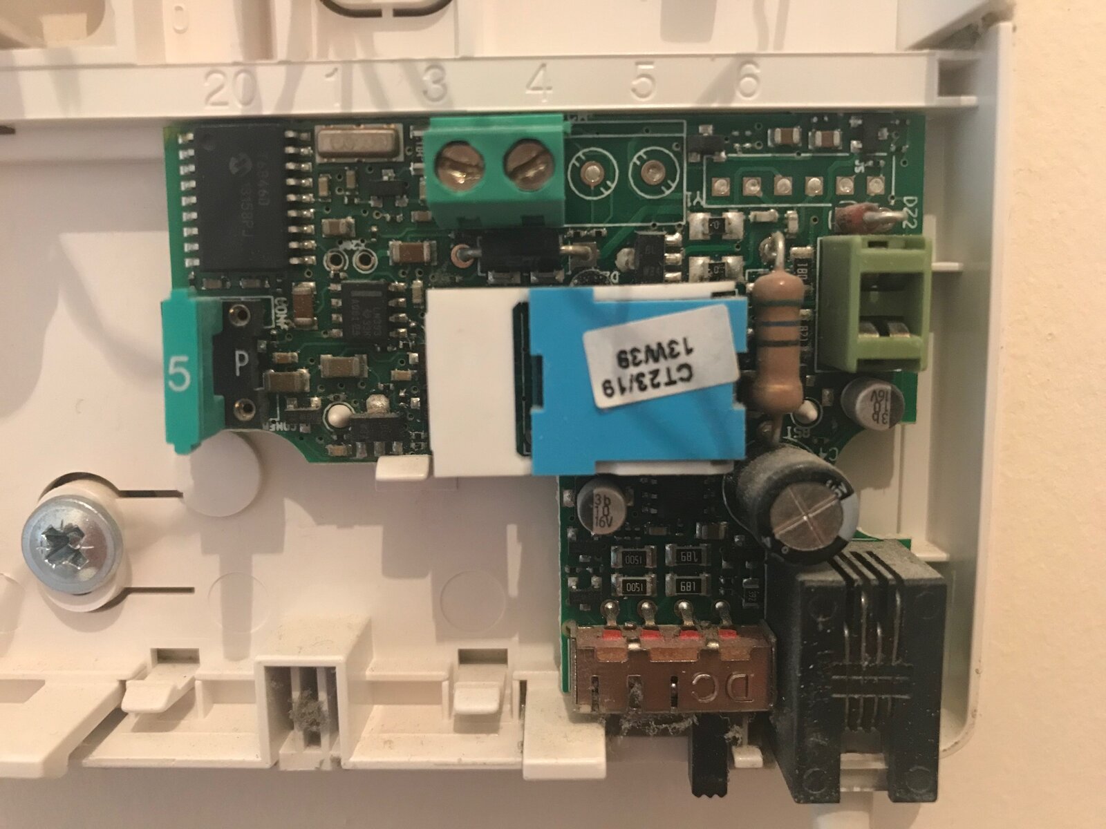

Quote the numbers on the label ( CT23/19 13W39 ) which are probably the software identity for the unit.

catherine as long as you have the two wires that are connected to the digital system then it does not matter which one you connect to which terminal on a two wire system. That is what made this system easy to install. Identify the two in use and connect one to each terminal. Clip the others back to save confusion but do not cut them off as its always handy to have spares. I take it you are in a block if you are able to track back you will see a blue connector which will show you the two cables connected, just use those and keep the others as spares. As long as no one has changed anything else in the system you shouldnt have no problem.
Do not worry about the two from any of your neigbours as who ever installed may not have used the same pairs. All you need to worry about is the two from your handset that are connected to the system (Bus) the rest is done with a configerator which will be something resembling a green coloured car fuse with a number on it. If any has been removed it need to go back in the correct number in position. If you do not have the correct configurator in it will not recognise you on the system.
You can see you are flat 5 on the system as you green configerator has the number 5. You must make sure that is in the replaced handset.
