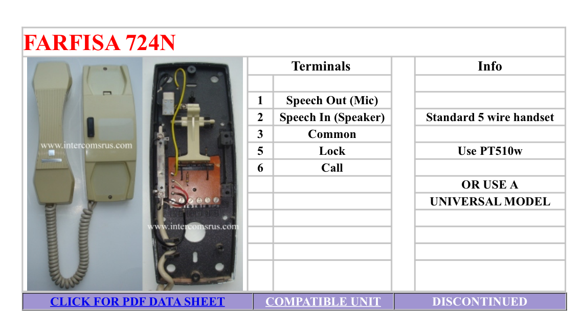

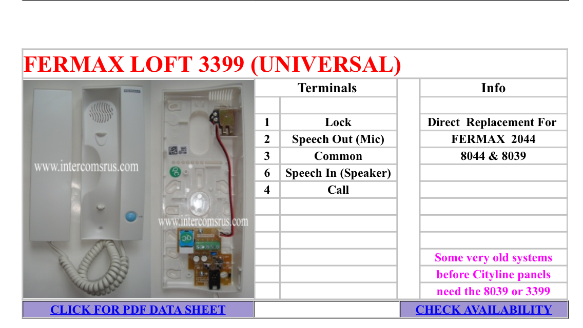

Hi hope someone can help please. My old Farfisa handset has finally given up and I need to replace it. I have bought a Fermax Loft Universal handset. I’ve searched the web and everything I’ve found only show 5 connections to the Farfisa however I have 6. My additional connection is to terminal 9 which on everything I’ve found is shown as having nothing wired to it. Not sure how to wire up the new handset which only has five connections. Can anyone help?
FYI: The system is a single entry door lock and multiple flats with handsets.
Would allways use the correct part but here are the wiring configs
Thanks, the handset is obsolete so I’ve had to get an alternative. I do have the two diagrams for the old and new phone, my issue is that the old handset has six wires not five. It has a wire connected to terminal 9 and the diagrams don’t show this.

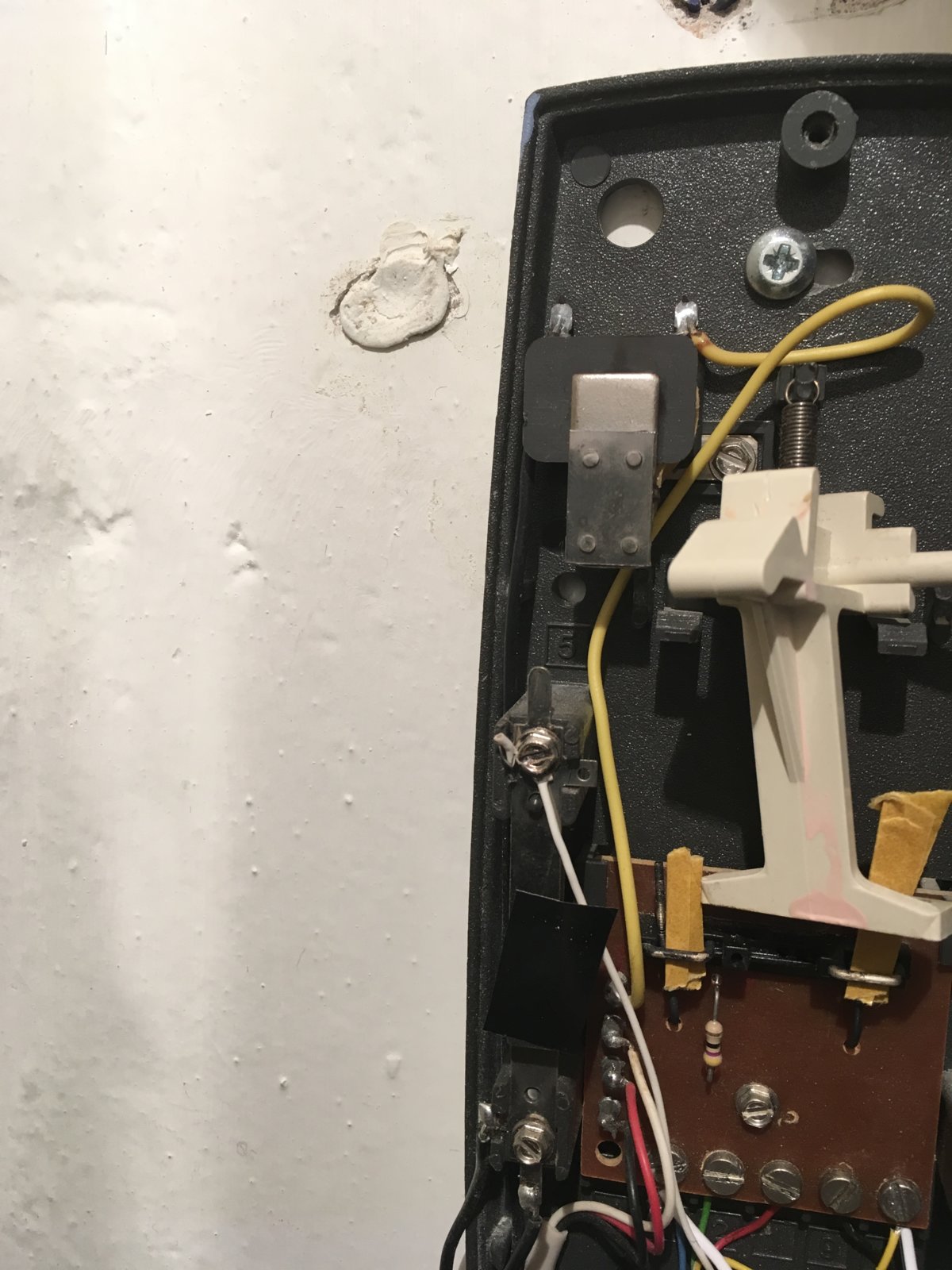

The switch that is broken is the one that operates when the handset is lifted. When the handset is on the base the switch breaks contact and isolates the handset. The plastic on which the switch pivots is broken. It’s easy enough to override the switch but not a practical solution.

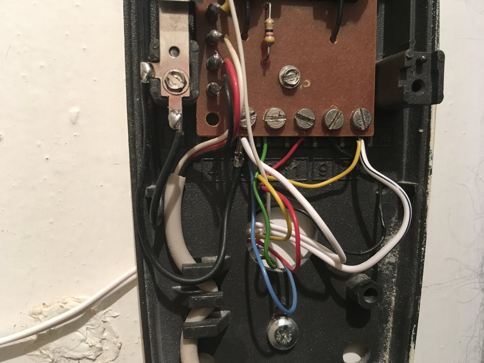

Two pics, one showing wiring, other switch.
I have disconnected the wire at terminal 9 to see if it has any effect. It appears that flat buzzer and handset speaker work as does the door lock opener. Only thing not sure about is if anyone can hear me at the door. I need someone just to double check at the door, will have to ask a neighbor
