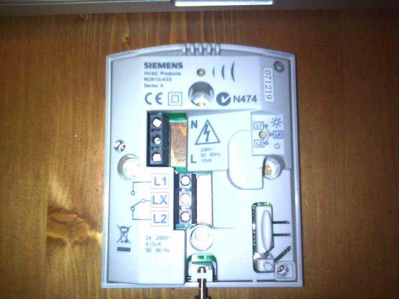

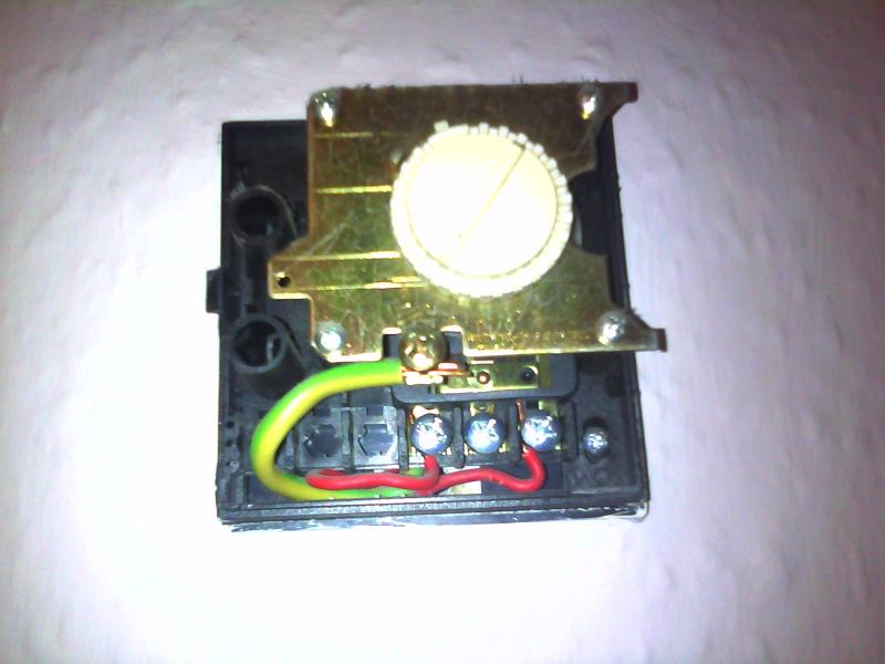

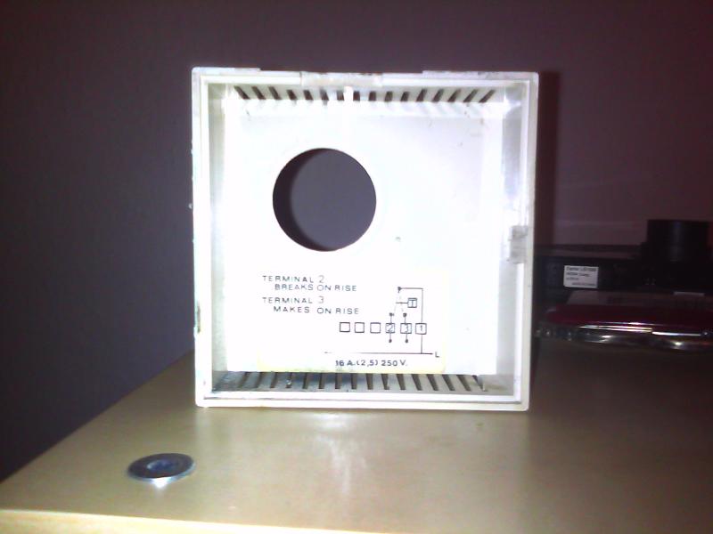

Need Help Wiring Wireless Thermostat
Seperate live and neutral from fused spur or wiring centre to L N connections.
And the red wires in room stat go to l1 and lx best done where wires originate.
No need for an earth
The diagram shows exactly how to do that.
If you can't see instantly how to wire that up, you need to get a pro to do it for you.
