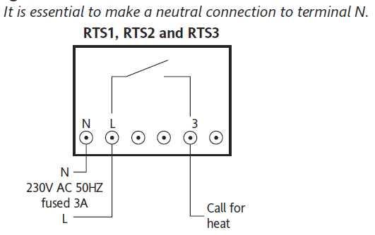

My mother moved house recently and it's turned out that the Room Thermostat is in bad location where the temperature is not "representative of the general house temperature." Initially thought I'd have to arrange a significant bit of wiring to move the Room Thermostat somewhere else, but having looked at the Internet it appears that a Wireless Room Thermostat may provide a simple solution which I could do myself.
The house currently has a Drayton RTS1 (branded as Iflo) room thermostat.
I wish to replace with a Siemens RDH10RF wireless room thermostat.
It looks like it could be a simple job, if I understood the wiring. So I need advice on where the wires will go in the new Room Thermostat.
Below is the existing wired backplate of the Drayton RTS1, with the wiring instructions from the manual.
So I have the three wires that match the wiring guidance, plus an earth.

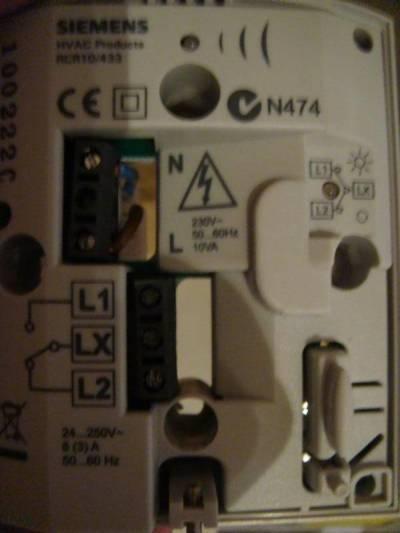

Below is a picture of the Siemens RDH10RF backplate (I've copied the image from another thread because I haven't bought one yet), plus a copy of the wiring plan from the manual.
So I'm can anyone help me with some guidance with what goes where (that's if its possible to swap these models)

The Live and Neutral connections on the Siemens are to provide power for the receiver and would come from the wires now on the L & N terminals of the Drayton.
The Live must also be looped to the Siemens Lx terminal.
The Wire on term. 3 of the Drayton is swapped over to L1 on the Siemens.
Thanks for the info.
Bought one yesterday and just installed it. Everything work well.
