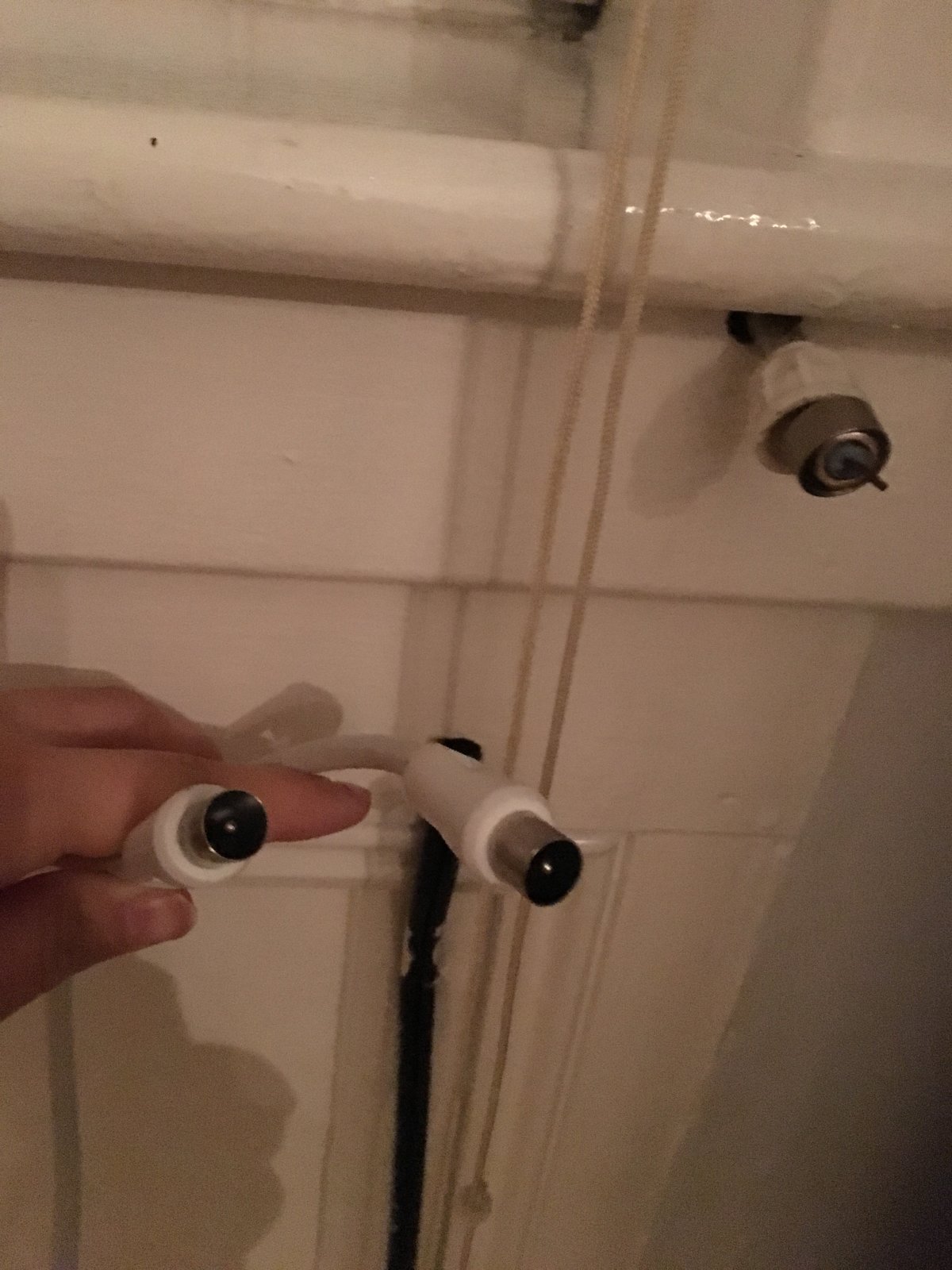

Sorry if it’s the wrong place to post here! But I’ve recently moved in to a rented flat and I’m struggling to connect the tv aerial to my freebies type box.

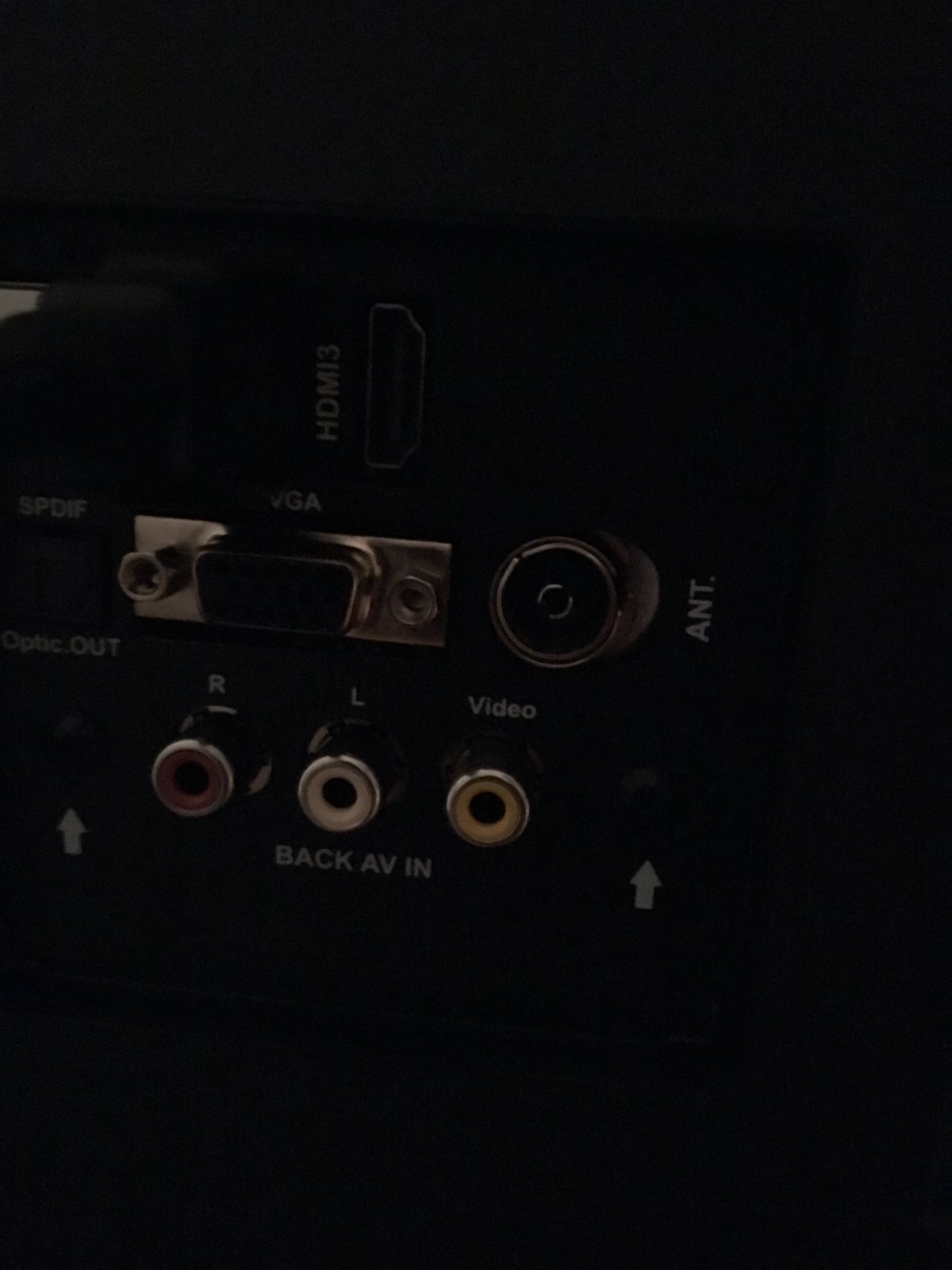

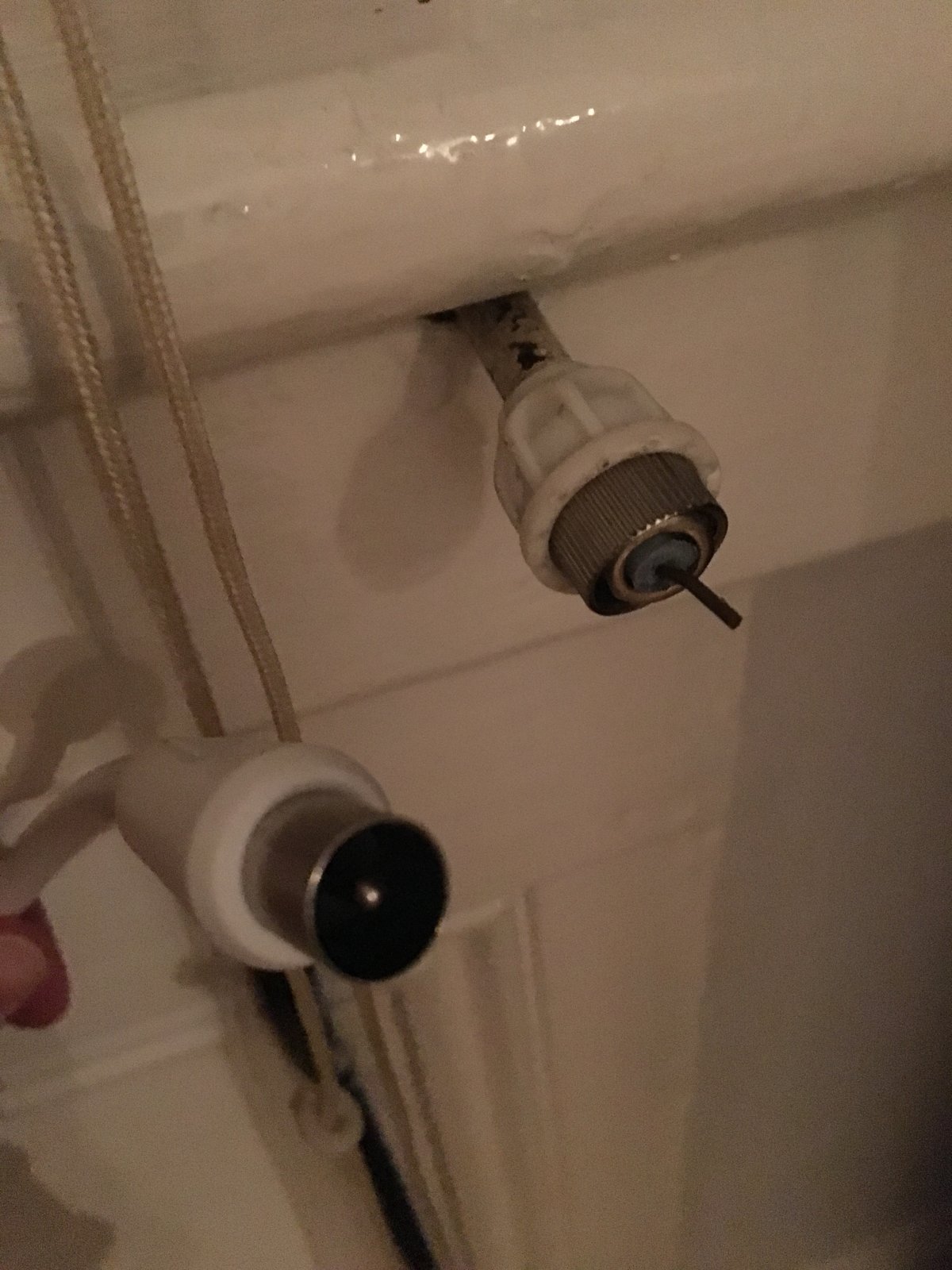

There are 2 wires coming out of the wall, one is black and has 2 ends coming out of it with thin wires at the end (pic 1) the other is white with a thin wire and looks like it should be connected to another longer white wire but isn’t - and the 2 parts don’t seem to join up (pic 2). My tv box (pic 3) doesn’t seem to fit these thinner connectors and will only accept the other end of the longer white wire - but I can’t connect the part coming out the wall to this?
Does anyone have any idea if there is anything I can try to get this set up? And why the wires are different sizes in the first place?

There is a dish outside, I can’t see an aerial. Hopefully I don’t need to get one fitted.

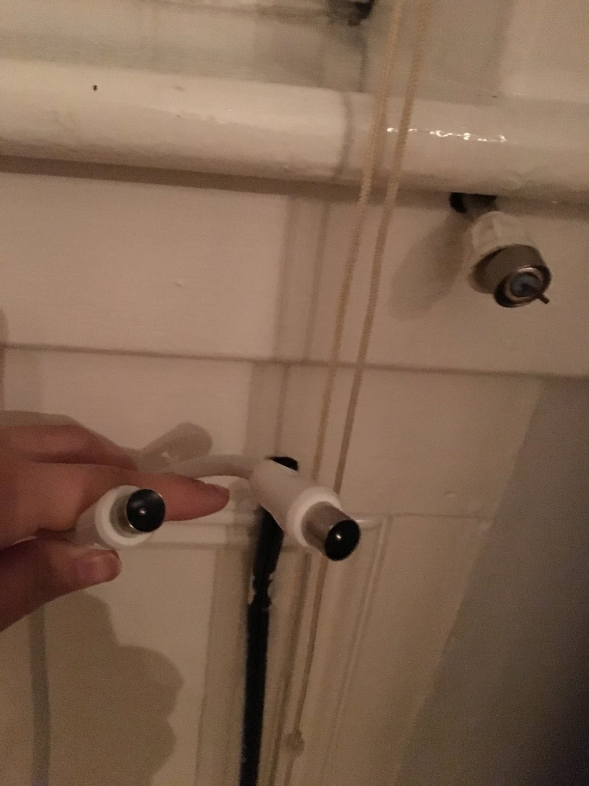

In the 3rd pic, it’s a long wire going along the skirting and there are 2 identical ends like the left hand side, I plugged one in to the tv and thought that would be fine, but then nothing happened so I followed the wire along and found the 2 parts that are in the photo so it’s not really even connected to anything.

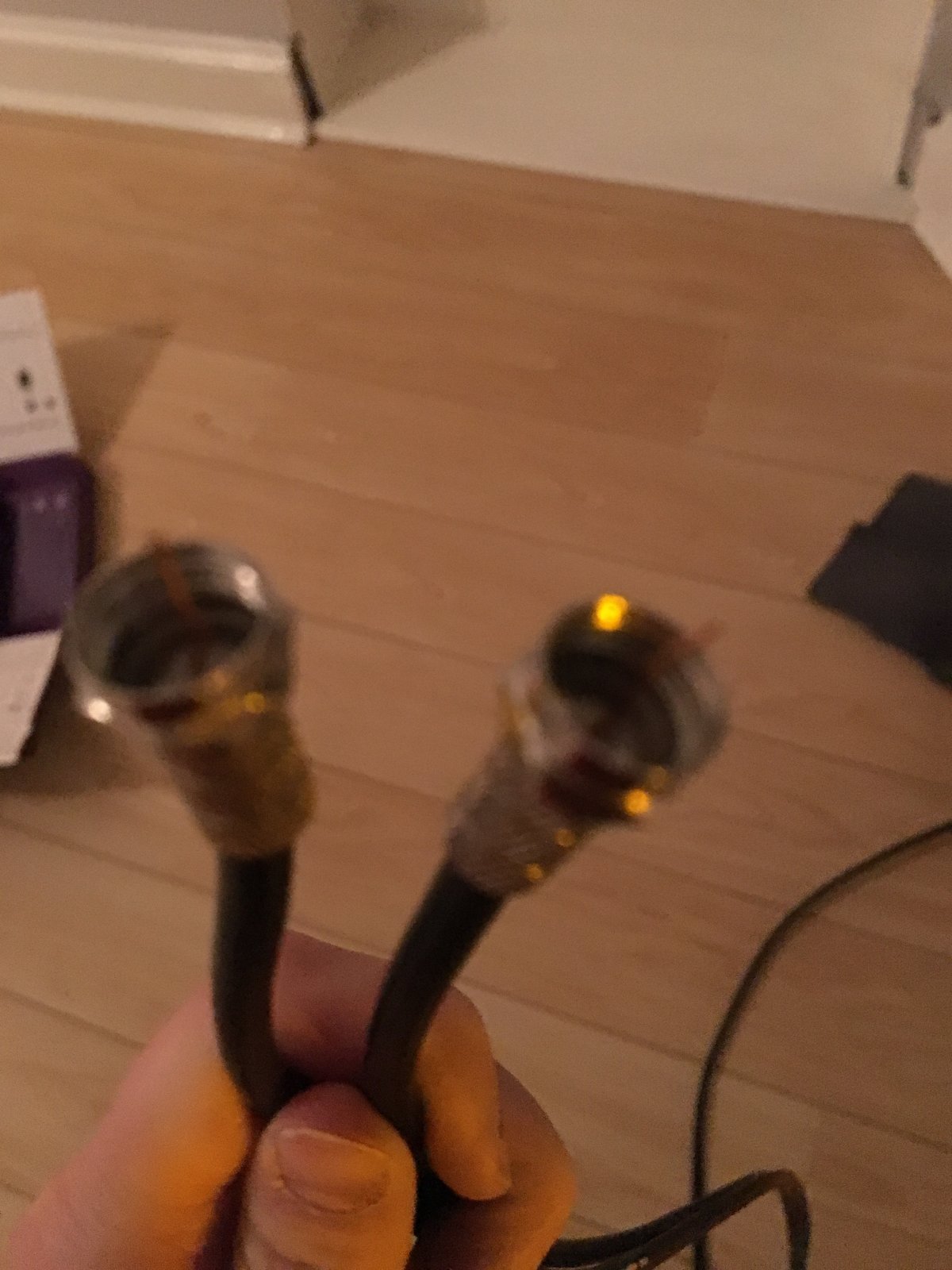

I current have a talk talk tv box but I can’t m get it connected due to this white aerial. I have attached another picture. There are 2 white ends which don’t connect to anything, I thought one would connect to kinda small white thing coming out the wall with the thinner wire but they don’t fit together (you can probably see that from looking at the photo). Do you know if there’s some kind of middle part this is missing so they attach together? Then I can attach the other end to my talk talk box?

It's an educated guess, but a good one based on installing aerials and distribution systems for more than a decade; I would say I'm 95% sure that the two new-looking white coax cables are going off to TV points in the house. It looks to me very much like the previous occupant had a Sky box, and used the two aerial outputs on the back to send the box signal to two other rooms for remote viewing.
I can't be certain if they bothered or not hooking up the outside coax cable. It would depend whether there's a functioning aerial on the other end of it. Certainly for Sky box users it's not essential unless they want a Freeview signal as well as seeing whichever Sky channel the Sky HD box is currently tuned to watch. You see, a Sky HD box (and previous generations) has an RF modulator built in. That means the box generates a signal that the analogue TV tuner can be set to receive.

We don't know what bits of gear such as splitters and power supplies might also have been attached to the cables at this TV point. However, I can definitely tell you that the short wire coming out under the windowsill is missing part of the plug end. It needs a new coax plug fitting. This means carefully removing the remnants of the old plug end, and then fitting a new one. This will give you a functioning plug end to which you can attach an extension to go to the TV or a Freeview recorder.
See here for a simple fitting guide: https://www.aerialsandtv.com/wiringup.html
As an alternative, you could fit a "satellite-type" F-plug screw-on connector instead. This doesn't make the signal in to a satellite signal. It's simply a different style of connection that is also commonly used now for aerial connections.
Where you're in rented accommodation, even furnished, it's not the landlord's responsibility to provide a working aerial, but have a chat with them anyway to see if he/she knows if the aerial works.
