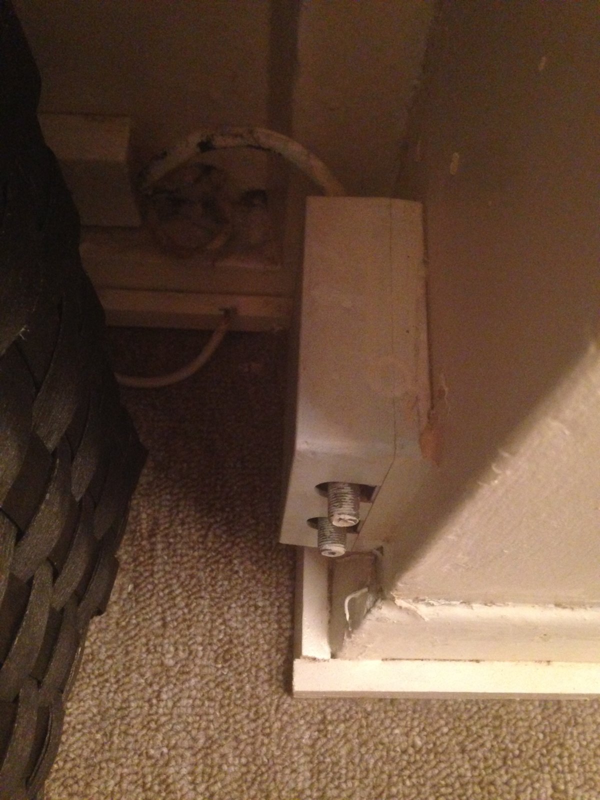

We have an aerial in our loft that looks like it is wired up but I am not sure where it comes out. The only thing I can see is this box in our front room. Is this the roof aerial outlet? If so what cable would I need to connect it to a freeview box/now tv box?

It may be a Virgin box, one outlet for broadband, the other going to the Virgin TV box.
That is definitely a virgin isolator. Guessing from the age I would say 1 port is old FM and the other port standard for tv/broadband.

Thanks for posting the picture. That's always useful. At first sight I wondered if that box in your lounge might be a power supply for an aerial amp, but looking at the thickness of the cable going in to the back, and the fact that it appears to go to another wall box rather than a plug socket, then I think the guys who said it's a Virgin cable isolator probably have it correct. If you're not on Virgin already then connecting to that box will do nothing. If you were on Virgin then their installer would have already taken care of hooking up the right connections. Either way, I think you can safely forget the white box with two sockets.

I'm starting to wonder maybe the white box is something to do with the aerial.
There is anther small white box next to the one I showed earlier. However I think it is just something to do with an old telephone connection.

As suspected the white box didn't work. I had already purchased the connections online when I read on here that it probably wouldn't work. But as I purchased the wires I tried it anyway.

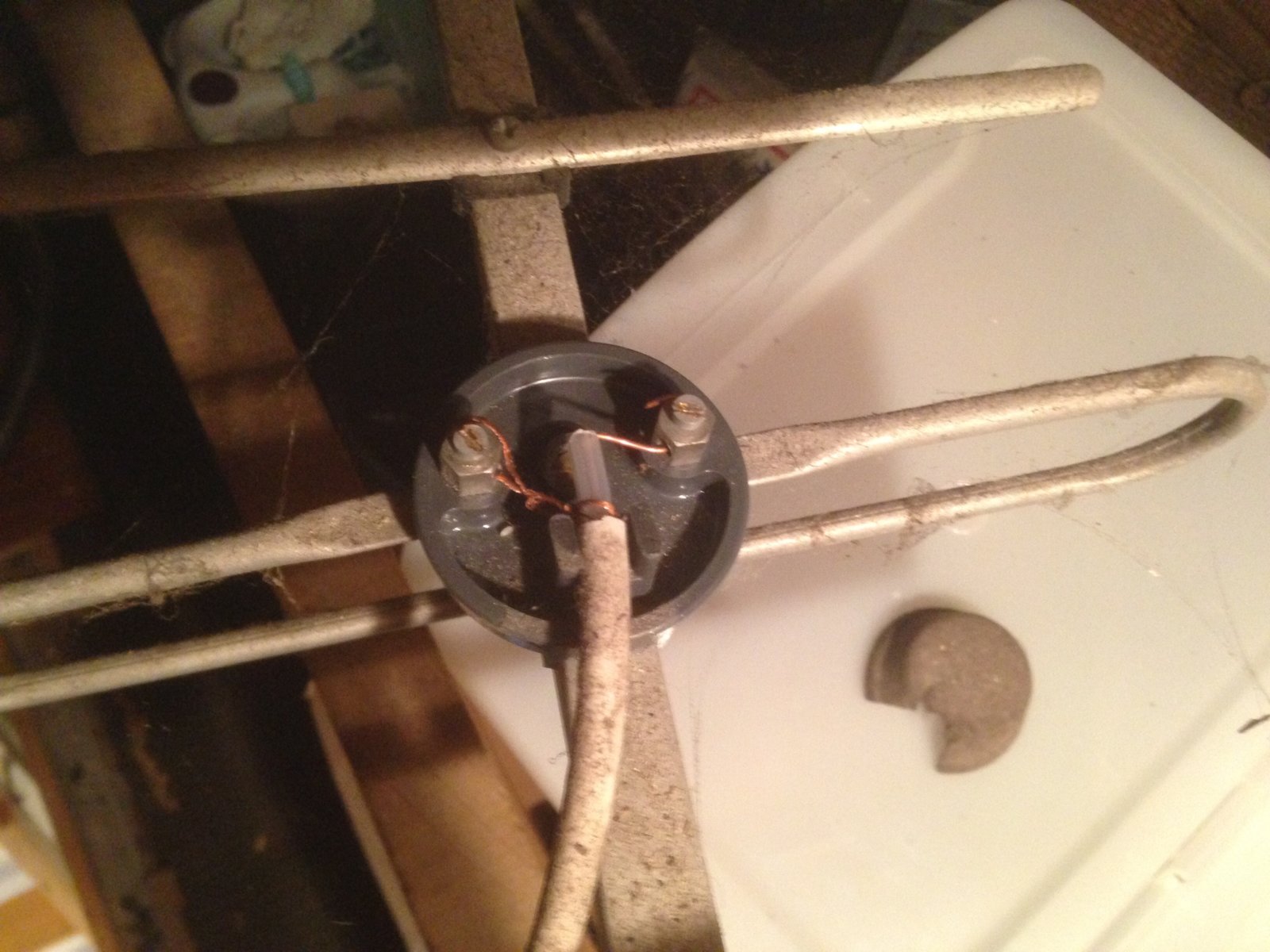

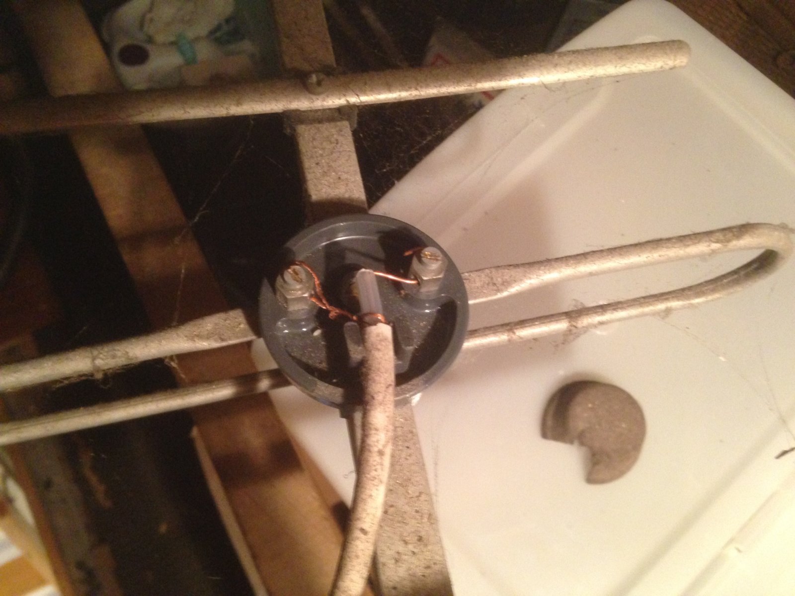

This is how the old coax looks.
Do I wire the new one up the same? Use the inside cable to go into the right socket and then use the copper braiding to go into the left socket?
