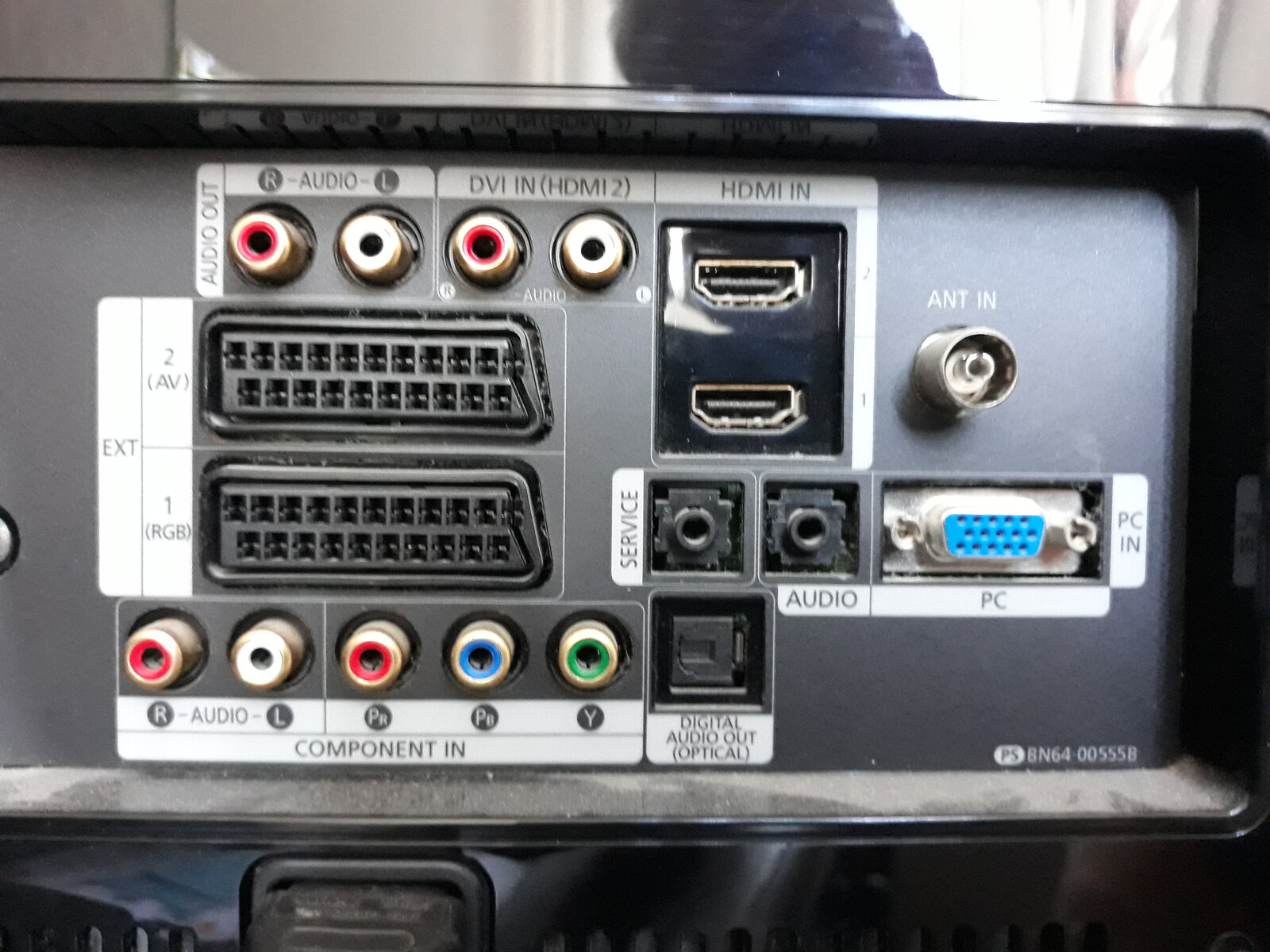

Thank you for your reply. It's a Samsung TV, Model LE32R87BD, Model Code LE32R87BDX/XEU, Type No. BP32EO. I attach a photo of the sockets at the back.
The aerial is pretty old, probably more than 15 years old. It's on the roof and it looks like I've cut the cable a couple of metres from the aerial itself, so whether attaching new cable to the aerial or joining to the existing cable I'd probably have to go on the roof, which is ok, although not sure about the corrosion problem, which is probably the case.

Thank you for your reply. The run of cable would be from the roof aerial (of a two-storey house) to the ground floor living room. Not sure if TV
was manufactured in the last 20 years, I'll have to check on that. Its model code is LE32R87BDX/XEU (Samsung).

Sorry, here's the picture of the sockets.

DVB-T vs DVB-T2
Your Samsung has a non-HD TV tuner (DVB-T). This means you'll get the standard definition versions of any Freeview channels from your local transmitter. Those that are either HD or that use the HD transmission encoding won't be receivable. That's because reception requires a DVB-T2 tuner. (This would be the same situation if you were still using the PC for TV reception. The PC tuner card would need a DVB-T2 tuner to pick up the HD channels etc).
Getting access to the Freeview HD channels (about a dozen of them if you're on a full service transmitter), and about 10 or so SD channels that require a DVB-T2 tuner can be achieved siply by adding a HD-capable external tuner or a Freeview HD recorder.
Connecting a new coax to the aerial:
Typically there's just two methods depending in the aerial. It's either going to be a bare wire connection or a satellite-type screw-on connector.
The bare wire involves opening a cover cap under which you'll find something similar to the screw-down terminals and cable clamp found in a mains plug. As long as the original cable was installed correctly then just follow the same method.
The screw-on satellite connector (F plug); there are plenty of YouTube videos how to fit the plugs. Personally, I always use compression plugs. The plugs I use have a little rubber grommet inside that helps create a moisture-resistance seal between the aerial and the downlead.

Thank you for your reply. Sorry but I'm a real ignoramus on these things but can I ask: When you say it can be a satellite-type screw-on connector, I presume that doesn't mean that if I use that method I'll be able to get more channels through a satellite connection?
The question comes up a lot. Don't worry. You aren't the first to ask and you certainly won't be the last.
The signal from a satellite dish LNB isn't compatible with the aerial input on a TV. This isnt a question of changing the shape of the plug at the end of a bIt of cable. The reason they're not compatible is the signal itself.
Some TVs have both a Freeview and a Freesat tuner. On the TVs you'll find two sockets; one will be the normal 'TV ANT' / 'RF IN' socket like your current TV. The other, the one to feed signal to the satellite tuner, that will have a screw-on type F connector.
