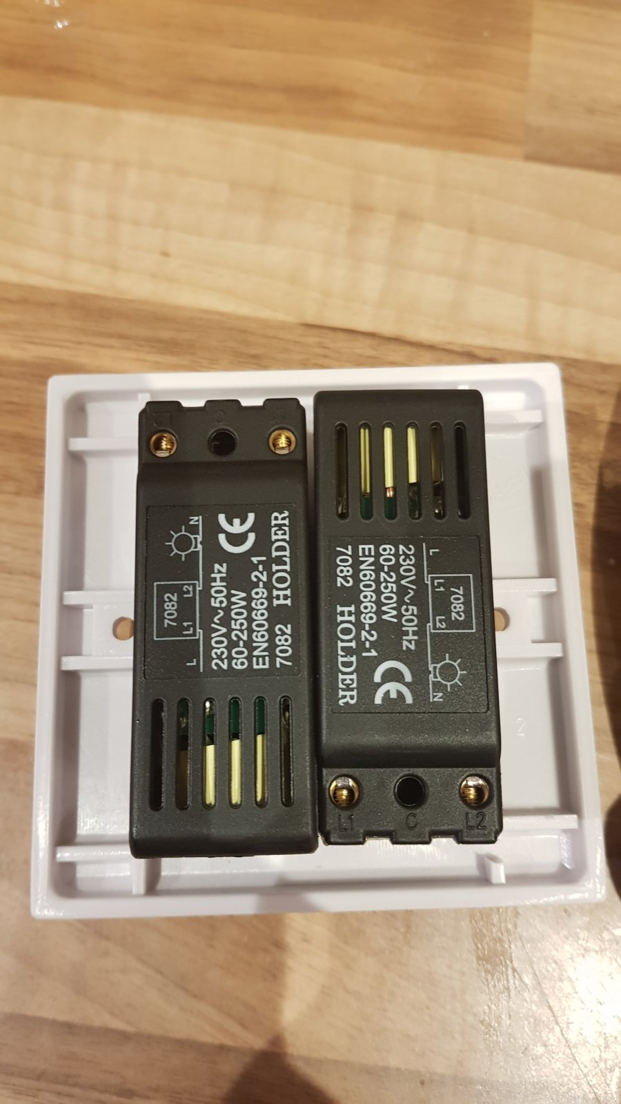

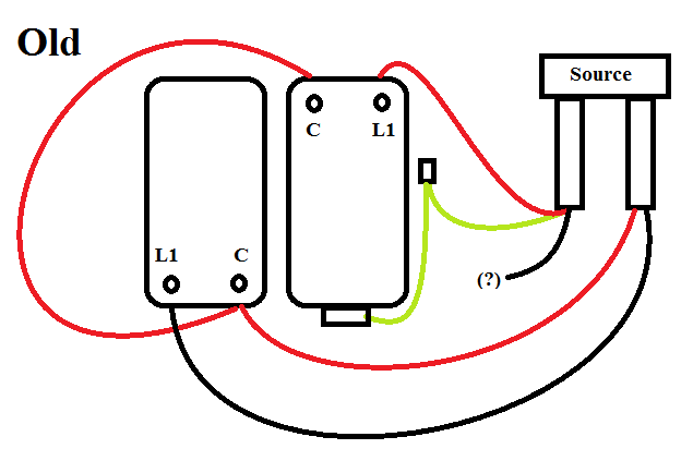

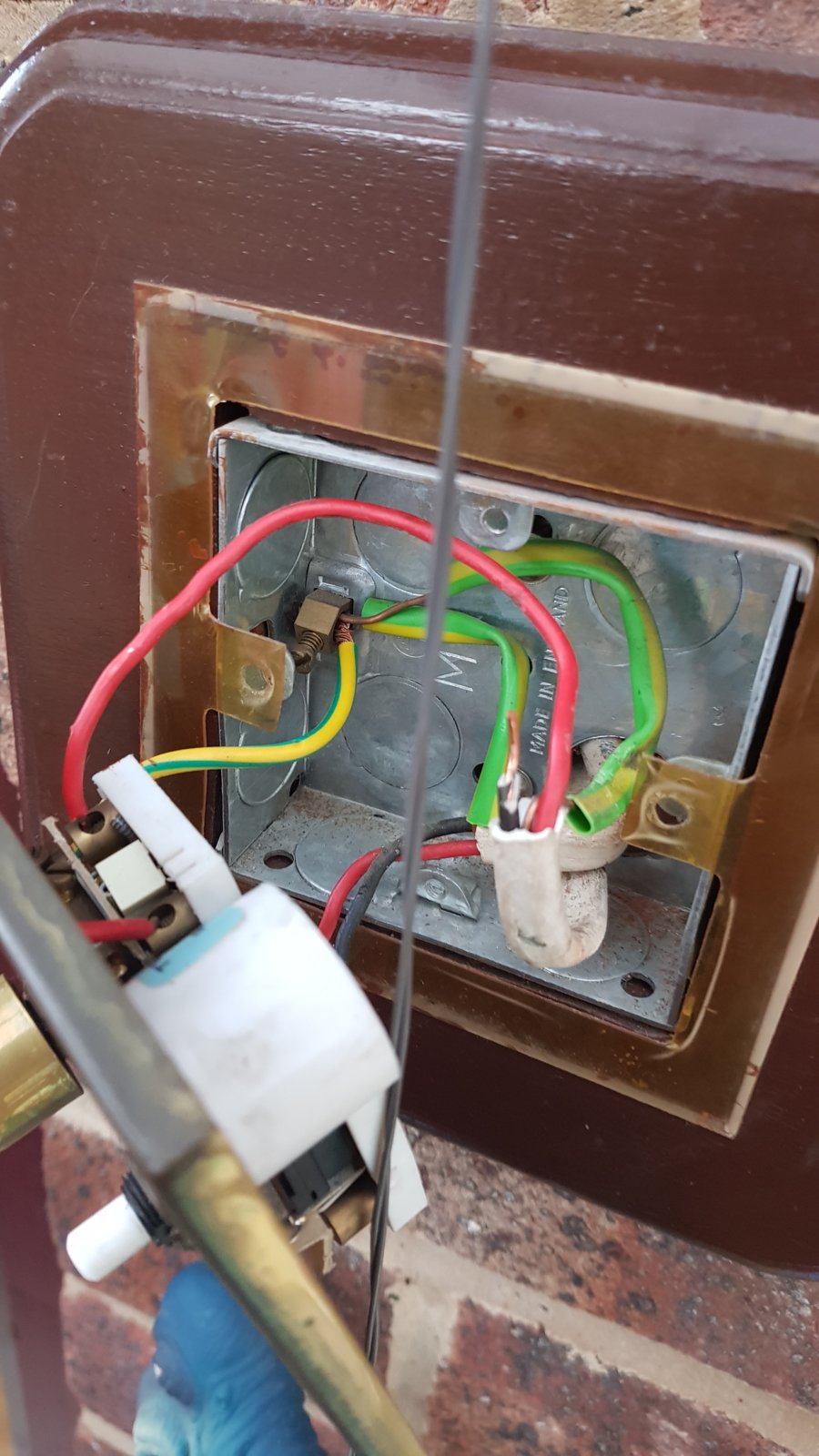

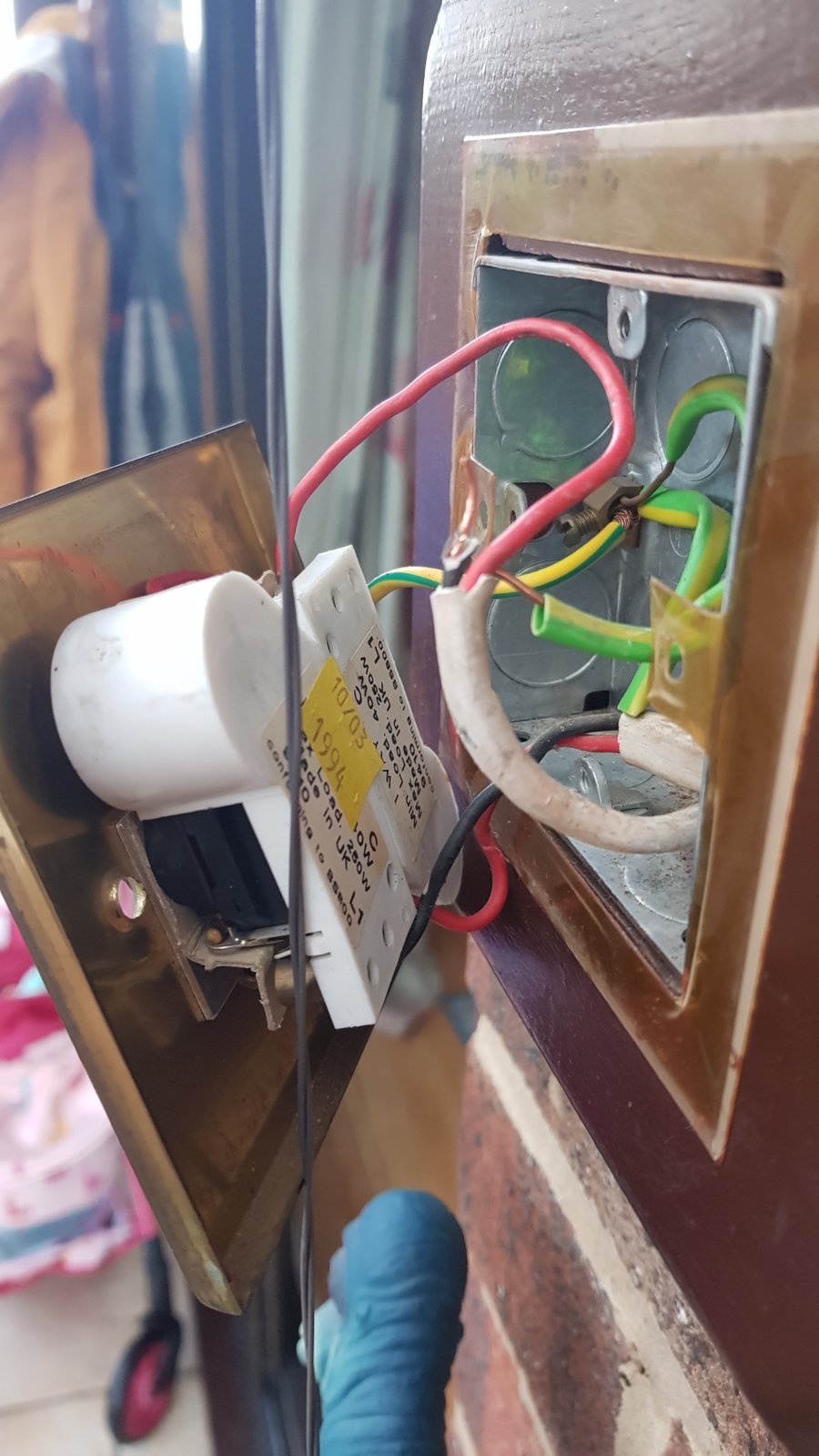

hi all,
I've tried googling this but cant seem to find all the info I need.
Im trying to replace an existing 2 gang dimmer switch with a new one I bought.
I cant wrap my head to why the existing connections are like this and how to rewire the new one.
All i know is that I can remove the extra eart wire as the new switch is plastic?
Another quesiotn I have is why the com terminal has no screw for me to fix the wire in. Is it needed then?
Ive attached photos of the existing wired unit as well as the new one I bought.
Thanks in advance

The conductors that are in " C" ( common) terminals on your old switch ,would go into the L1 terminals of the new switch. The L2 terminals of new switch would receive the conductors from old switches L1 terminals .
The black insulated conductor that is not connected to old switch ,should not connect to the new one ,but terminate it in an insulated connector block.
The new switch has a simple wiring diagram on it.
The markings are different.
So;
old com = new L1
old L1 = new L2
You need to fit a small connector block onto that unused black wire.

is there a chance that the ceiling light doesnt work is because that loose black wire was not connected?
You have two switches ,what does each switch supply ? Is it one light fitting for each switch ?
Did the light fitting that is currently not working ,work perfectly well with the old switch ?
I take it the short black was not connected to anything?
If the centre light does not work, maybe it's not compatible with the new dimmer.
You could fit the old dimmer to see if it works.
Or you could remove the wires from the dimmer and put together in a connector block just to see.
Either way, work safely, and make sure the power is off when you experiment.
thank you all for the help. Some more info:
there are two wall lights (both operated by one switch (left one in the first photo - right one in my diagram)). This is the one that works fine.
the other is a ceiling light which is operated by the other switch - this is the one that doesnt work.
I havent done anything to the wires yet. only unscrewed the plate.
