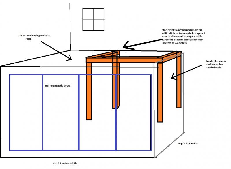

I would like to extend into the lean to and put some velux rooflights. But i also want to add a storey on top without building any load bearing internal walls. Basically the kitchen will be the full width of the house by extending onto the lean to. I will also extend into the garden by about 3 meters with full height patio doors.
I have drawn a mock up before i choose an architect. i was thinking that the storey ontop should be able to support a bathroom and maybe an ensuite coming from the attic???
Can the brick walls be built directly ontop of the joists? or are there special procedures?

Brickwork will need to be off steel beams spanning across walls or columns/piers, not off timber joists

I ws just wondering if a brick wall can be built off the steel frame and what the process is. Any ideas? is it like the normal way of building up from footings. and what thickness should the wall be?
Also the orange frame is going to be steel beams and columns not timber?
You can lose half of that frame, namely the 3 sections on the far right if you build the upper extension flush with the downstairs exterior wall.

Is the proposed rear extension going to be 7-8 meters from the existing rear face of the terraced building? Isn't 3m the maximum allowable?

Yes brick can be built of steel beams, you may need piers + / or columns as per woody's advice.

i think there is a slight misunderstanding. Currently i have a 50 foot garden which isnt over looked. The kitchen currently extends out by 5.5 meters. My lovely neighbour (landlord) extended out by a further 3 meters or so. So the full length is 8 meters. When i come out into the garden i have a lovely brick wall (poorly pointed) to stare at. All i want to do is match his length but go with a full width kitchen garden.

Deluks ''You can lose half of that frame, namely the 3 sections on the far right if you build the upper extension flush with the downstairs exterior wall.''
I guess i have to check if the foundations will hold the weight by digging an inspection hole?? thanks for your input.

Structurally (in terms of requirements for beams, foundations + columns) you will require calcs for Building Control from an Engineer.

an identical planning application to my proposal got rejected on my road due to materials and design which would 'unduly effect the character and style of the terrace' Also the plans included a first floor storey projecting out more than 3.5 meters which could block the light for adjoinng neighbour. I plan to do a first floor extension which would project out 3 meters keeping in line with 45 degrees from neighbours property.
