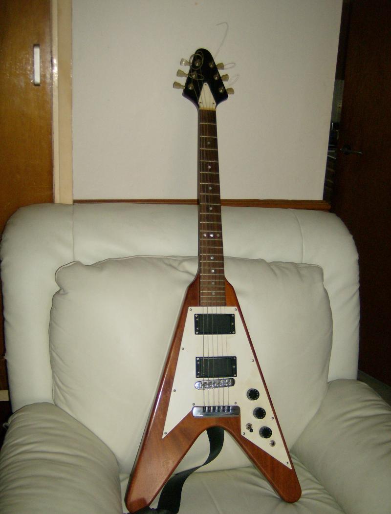

Before you spray your guitar with anything, you need to fill the grain of the mahogany. I used some Rustin's woodfiller for mine. Rub the woodfiller across the grain so it fills up all of the pores in the wood. Leave it to go hard then sand it down with something like 320 grit paper.
I considered a spray lacquer for my guitar, but not having the confidence to do a good job, looked at the cost of a professional job. (Way too expensive)
I settled on a hard oil finish. My guitar received around 8 or 9 coats of danish oil. It was left for about a week or so between coats. Given a very light rub over with 1000 grade wet&dry paper. Then had 4 coats of Colron , Antique Oil
Guitar made of Brazilian Mahogany with Rosewood Fretboard and Ebony head face Neck is glued on to body (no screws or bolts !!!!)
The fretboard just gets cleaned a couple of times a year and receives a light coat of olive oil rubber into it. ;) ;) ;) ;)

You'd still have to fill the grain of the mahogany, otherwise the finish will never be nice and smooth. It doesn't take long to fill the grain though. The maple is probably fine grained enough to not require filling. The mahogany on mine was filled using a coloured filler.
