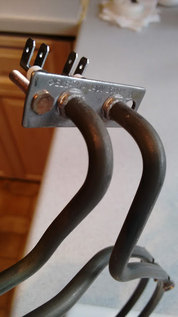

I have bought a replacement element (the one surrounding the fan at the back of the oven) but I can't get the old one out.
The problem seems to be the hexagonal shaped bolt on the left - see picture of new element. It is the last thing holding the old element in but I can't remove it. It looks like a bolt but is almost flush with the housing so a spanner is no good, and checking on the new element the 'bolt' doesn't seem to unscrew anyway. My only guess is that there is a nut screwed onto it on the other side holding it in and I will need to go in thru the back of the oven.
Is this correct or does anyone have a better idea.
Thanks in advance.
Yes it'll unscrew from the back, and you need into the back for the wiring anyway.
Should be, just ensure you have the power isolated. Oh & make sure you take a pic or make a note of where the wires go on the element so you know where to connect them to once you have fitted the new element.
Further - pulled the cooker out from under the units and took the back off. No surprise there was a nut on the hexagonal bolt that had to be undone. The earth connection is looped round the rear side of the hexagonal bolt and obviously pings off when you remove the old element. It's buried under insulation so it would be quite easy not to realise that there's an earth connection there and replace the element without reconnecting the earth. Fair to say that to mess around with cookers you should really be 'a competent person'.
