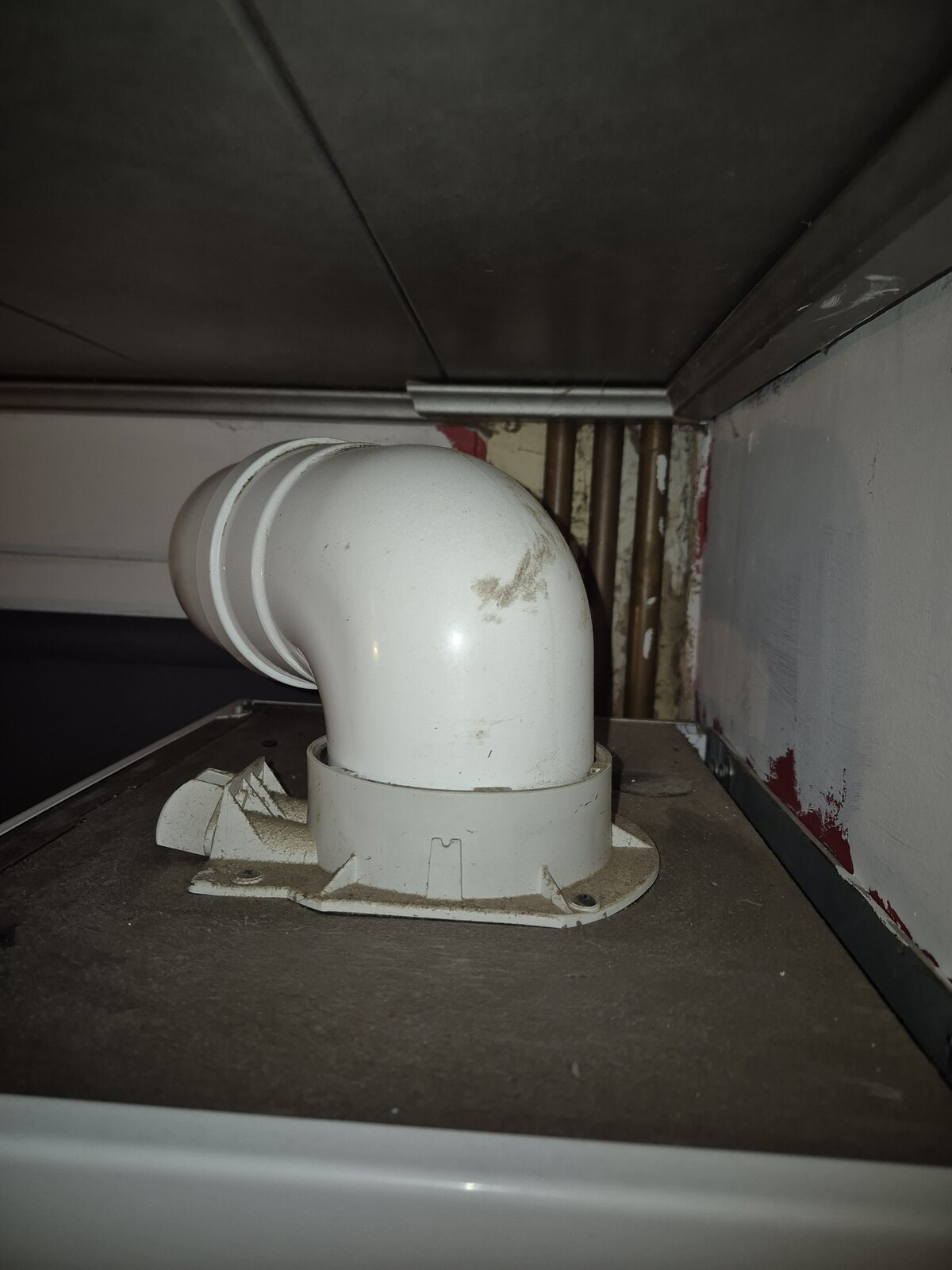

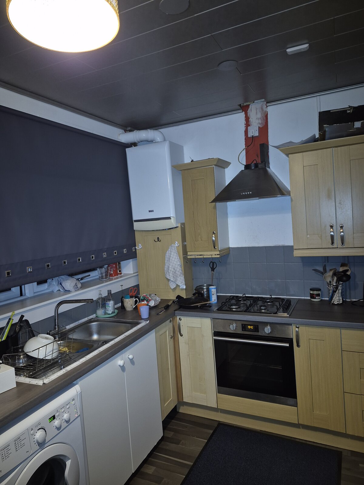

We have had 3 electricians who have cisted and also have confirmed It CAN NOT be extracted outdoor due to there not being space to run ducting because
A) the boiler pipes take up all the space to make another extraction pipe, please see photos.
B) the only other options are would involve a huge amount of work of running the ducting up the ceiling, take up the new put down floor boards in upstairs bedroom etc.
Or run the ducting through the middle of the kitchen ceiling to about half way then turn to then go out the kitchen window but means cutting holes in the supporting joists to run the ducting throuhh in the ceiling which is not recommended.
C) or get a seperate extrator fan vent in the wall, not connected cooker hood vent.
is it possible to vent the cooker hood out door, no, not practically and would involve a huge amount of work and there maybe other issues that are not known until doing the work.

Finally the most helpful pictures!
But it wouldn't surprise me if a square section pipe would fit behind the exhaust pipe out of the boiler - that could then nbe converted back to round section to pass through the wall.
What do you mean I haven't taken any advice? I HAVE taken all the advice given which was to get it externally vented.
And simply accepted, that it cannot be done. It is the only way to effectively prevent such smells, so a way simply has to be found, to discharge outdoors. Why even bother replacing a recirculating fan, which you know causes you issues, with a new one installed in the same way? You are gaining nothing, solving nothing....
There is always a way....
Could you fit an extract system, which extracted down, below the work surfaces, and through the cupboard, to discharge below the window?
Could you run a pipe along the ceiling, and have it discharge to the left of the window?
Why are you talking to electricians to install this for you? An electrician usually deals with the wiring, rather than the installation you need - what you need it a builder, or perhaps a general handyman.
Do the joists above run perpendicular to the long edges of that ceiling boarding? Can you sketch your house floorplan, including an indication of the locations of any attached neighbours ? How thick is the floor, from the surface of this boarded ceiling to the surface of the floor boards above? What does the room above look like?
But I it wouldn't surprise me if a square section pipe would fit behind the exhaust pipe out of the boiler - that could then nbe converted back to round section to pass through the wall.
The pipes block a square section pipe fitting doesnt it? If you see the picture , this is what we were told anyway that theres no space because of those pipes.
