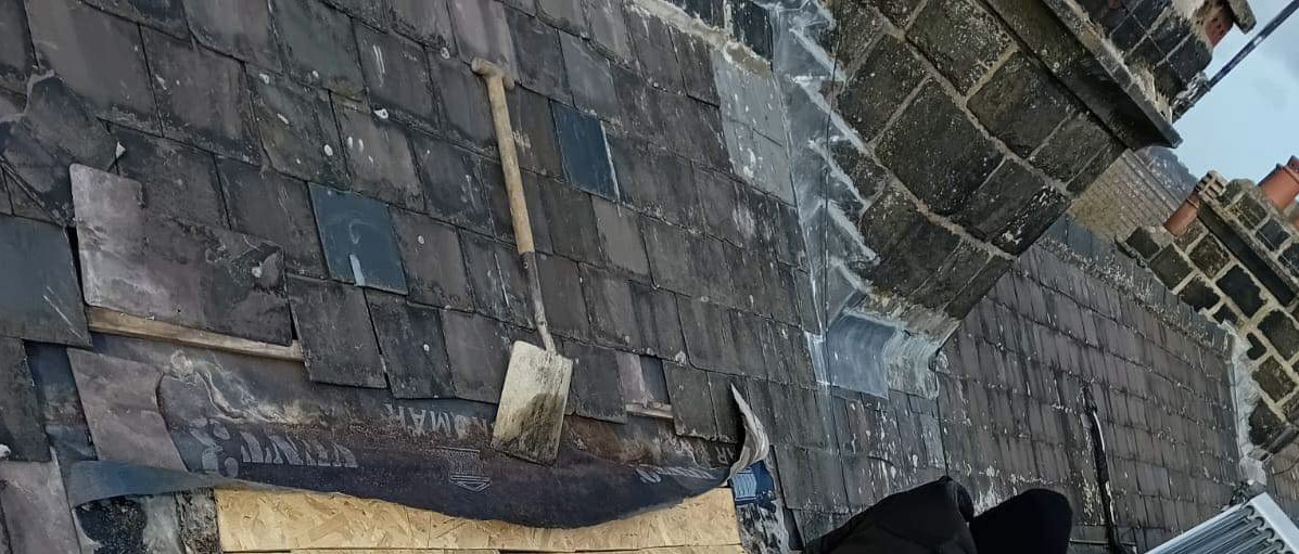

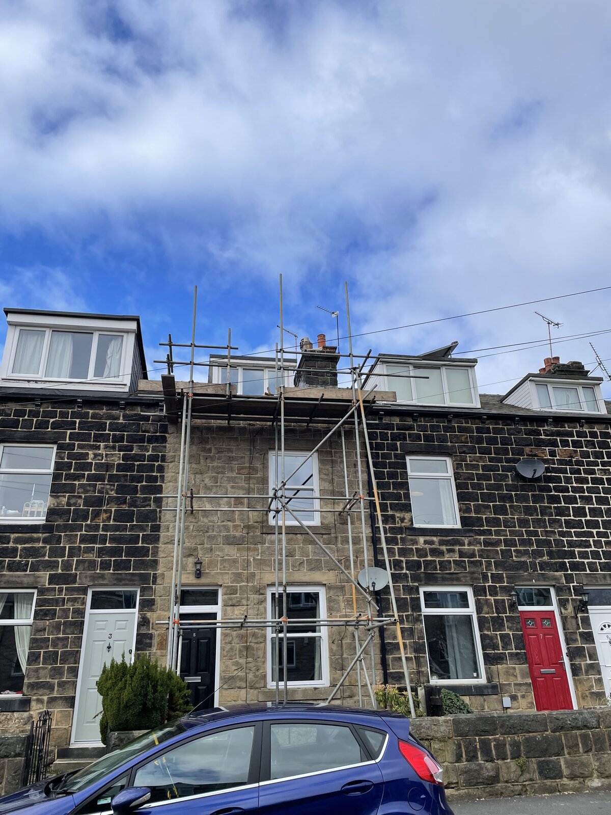

Chimney to right of scaffolding which is on my house atm.
Also this is my chimney side and it’s. Best pic I have atm.
Legally speaking, it will be far cheaper and less hassle just to repair their bit of chimney and flashing when you have scaffolding etc. up to do yours. Morally and legally, they should pay, but if they won't, pragmatically it may be best just to get it done and move on.
It’s just cost me £2k. Plus £2.5k for the dormer. Got several quotes and all were the same. Paying for theirs isn’t an option for me… they aren’t short of money either.
