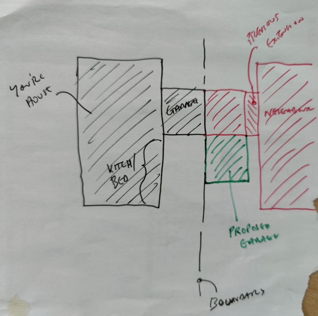

My neighbour and I live in detached bungalows.The front of their house faces the road, but my house is at a right angle to the road because the developer had a long, narrow plot going spare! This means that my kitchen and one bedroom face my neighbour's front garden .The driveway to my bungalow runs between my kitchen wall and boundary fence to a detached double garage.
1,This garage shares a wall ( two brick deep at the boundary) and a flat roof with the neighbour's double garage which drains to separate gutters/downloads to the rest of the property.The neighbour's garage was built detached from the side wall of their house by an open passageway to access their back garden.Our current neighbour enclosed this passageway when they moved in three years ago, attaching their garage ( and ours) to their house , making a utility area.Part of the roof of the bungalow was extended so that it design into our shared flat roof.
Did they need planning permission? It didn't bother us at the time but now we are it could be a 'Seth's for further development.
2,The proposed double garage would be built in front of the existing garage from their bungalow wall right to the property boundary. It will be approximately 5 meters wide by 5 meters long and 2.8 meters high from our ground level.It will have a flat roof. The plans do not show how this will attach to the existing shared garage roof , the pitch or how the rainwater drainage will work. I say that the height of the garage will be 2.8 meters at our ground level because their land is approximately 40cm higher than ours at our current garage door and is retained by a wall two-year brick feel which the neighbour's plan suggest they will use half of to build their new garage wall off.

So has the planning application been approved? Or is it still being decided? Some pics of the plans would really help tbh.

A planning application is assessed against the council's local planning policy and any supplementary guidelines. Read them.
You can only object to an application if it materially affects your use or enjoyment of your property, not what may or may not happen with the neighbour's subsequent building, or why a garage is built in a certain place. So you form any objections based on [any contravention of] the council's policies and the impact on you.
The technical aspects of building and potential impact on your property are dealt with under common law - ie the neighbour can build as long as damage is not caused, and if it is he will be responsible to put it right. Building Regulations look after the neighbour, not necessarily your interests - other than that the building is built to a safe standard
The Party Wall Act deals with how some work is carried out. This Act, if it applies with give the neighbour certain rights to do certain things in a certain way - including building onto or against your property - even building from your side of the boundary. You can't stop these things from happening, but you can be protected in how the building work is carried out.
If he detaches it from his existing, and its 5m x 5m and under 2.5m from his ground level, and it was a separate outbuilding he could build it under permitted development right up to the boundary, provided it is in substantially non combustible materials - no PP needed. It's not in front of the building line, and I guess not in a conservation area.

The plans show them building to the borderline but they've told the appeals officer that they will build about a foot within the border.
I doubt he even knows that the Party Wall Act exists and probably thinks it let's him off, anyway.
There is a retaining wall at part the boundary, varying in height from 1 to 2 feet in height. It was built by the original builders in the 1970's , the neighbour's property being higher in a natural slope. It is a double, standard brick construction, the topmost layer
being turned sideways and stood one brick high in his side although he has replaced his drive and it no longer stands proud.
The retaining wall is only visible from our driveway and is in poor condition from damp/weathering.
According to our deeds, we have responsibility for maintaining the fence along that border but are we fully responsible for the retaining wall. We don't want any comeback for problems with his build. To be honest, if he hadn't been so unpleasant about it, we would happily pay what's necessary, but if he builds to the boundary, he may be utilising and/or impacting the retaining wall

1. You could seek an injunction
2. No
3. Yes if Party Wall Award says so. No if not.
Ta, Woody:
1 . only if they trespass/damage.
2.Seems to depend on who benefited from the original excavation 50 years ago. Possibly both as on natural slope?
