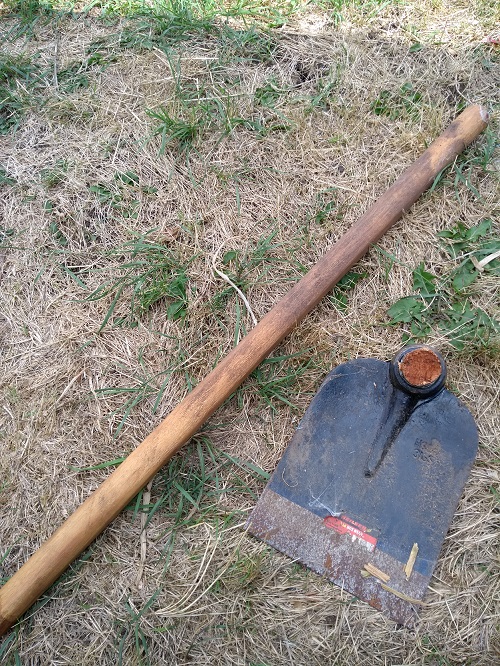

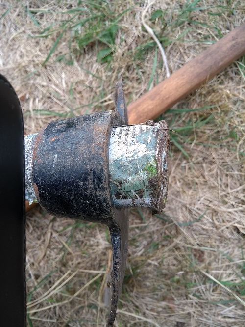

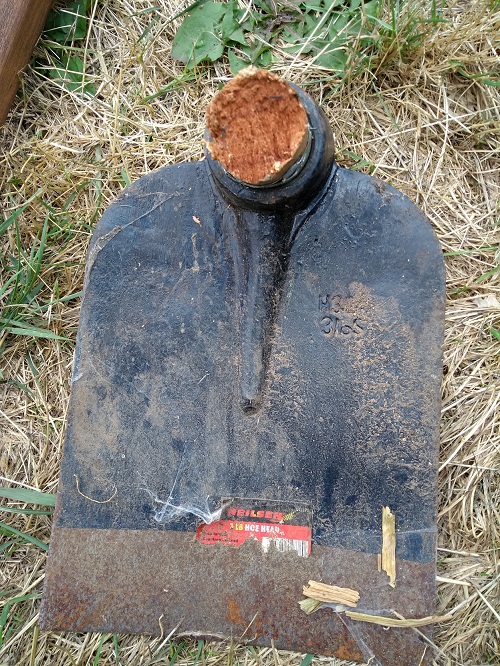

Found this and was curious about repairing it. Any suggestions ?
I do love a hoe
I'd start by drilling the remains of the shaft out, a bit at a time.
There's every chance the shaft was fixed by a taper, maybe with a steel wedge hammered in too. Once the hole is cleared, see how snugly the rest of the shaft sits....if its too slack then you need a new one.
