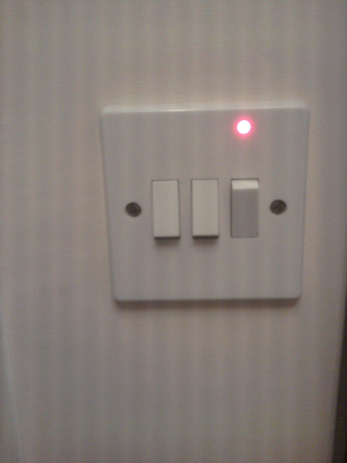

Neon 2 way switch
I did wonder why you would want to turn it OFF when you were in the loft, but I suppose you might forget to switch it ON before climbing up.
No idea what's inside.
Sorry about the stripes, that's flicker free LED lighting

Then take it off the wall and have a look.
It's a bit worrying that when John said "unless they've been 'naughty', one thing which presumably must be inside is a neutral" you said "No idea."
Surely you must agree with him?

Why are you worried and why should I be worried? Should I be worried about every single electrical device in the world, or have you singled out this particular item for some peculiar reason. I still have no idea if there is a neutral in there or not, or even if it needs a neutral.
As I have already mentioned I don't know if there is a neutral there or if one is required, accordingly I don't know if I agree or need to agree. I made a factual reply to a reasonable post.
Even more than this is I have absolutely no idea what the light is there for. I don't familiarise myself with every switch I ever see but in this case I have seen a solution to the OP and thought I'd share it. For all I know it could be a low level alarm for Tinkerbelles fairy dust reservoir and not have any relevance to any of the switches on that plate.

.... I still have no idea if there is a neutral in there or not, or even if it needs a neutral.
As I said/implied, unless they have been 'naughty (or the light comes on when the switch is 'off'), it must 'need a neutral'.

I'm not disagreeing with you in any way.
There are a selection of methods of lighting a LED but having not seen what's behind the plate I don't know which method has been employed. It's easy to jump to conclusions and I'll happily criticise it if I ever know how it's been wired and it proves to be 'naughty', but in the meantime I'll say that my expectation is for that particular building to be electrically correct.
Edit: As mentioned previously I don't even know what the LED is for and it could easily be a locator for when the light is off.
You may be in the loft and someone switches the light off by mistake in the hallway. Then you can just switch it back on in the loft.
You may be in the loft and someone switches the light off by mistake in the hallway. Then you can just switch it back on on the loft.
If you are happy to do that, I'm not too sure what purpose the switch in the hallway (or an indicator light on that switch) would achieve. Is there not a switch in the loft near the hatch?
