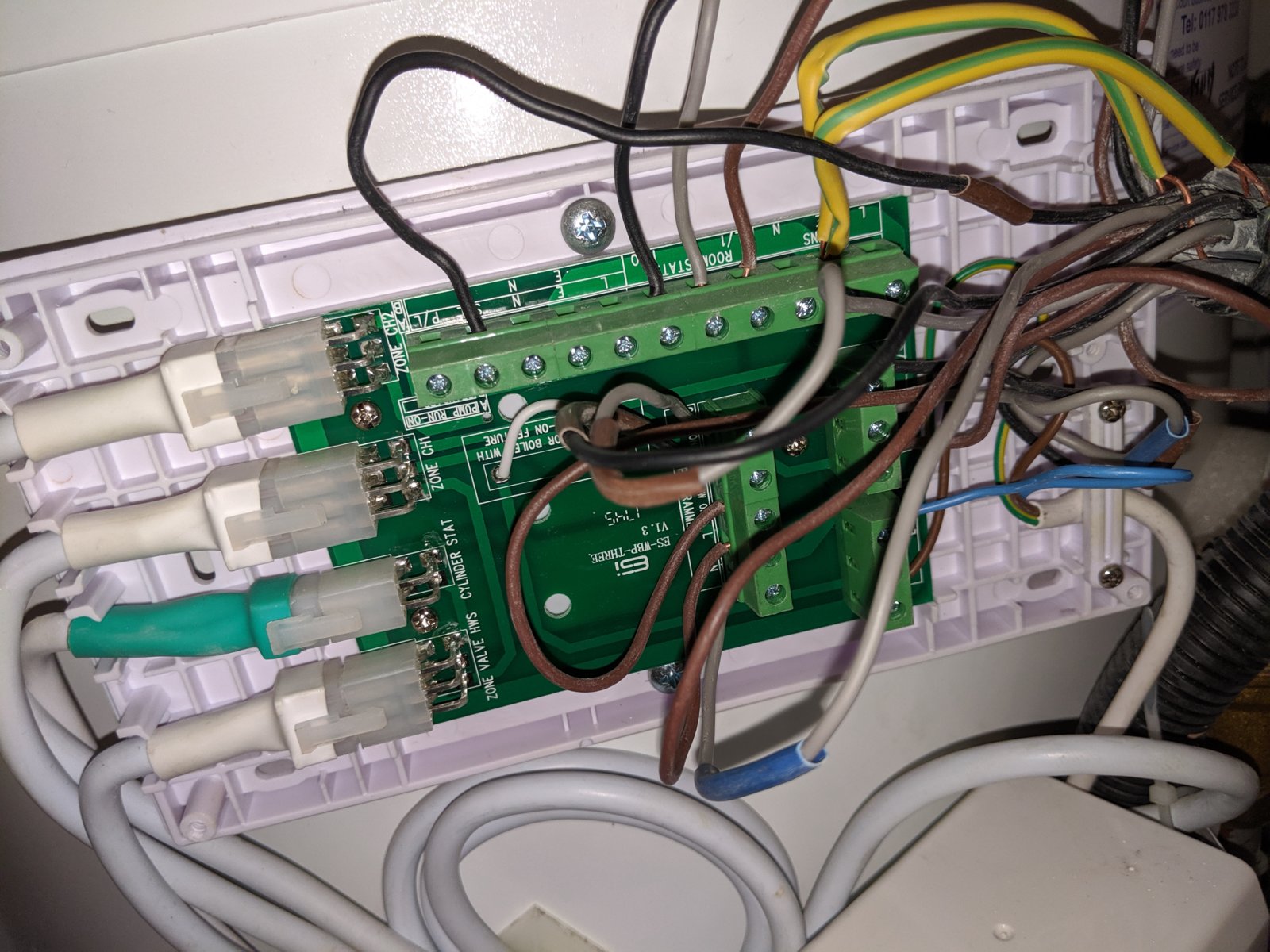

Hello,
I'm going to replace my ESI controls and thermostats with 2 NESTS. I have 2-zone + HW GCH. I think I've worked everything out and I'm confident that I can get this done myself.
On the pictures attached you can see main board and zoom on the wires that I can reuse.
They are upside down and partially covered but here is what they are:
N, L, HW ON, CH1 ON, CH2 ON
Hot water stat is connected to the main board with 2nd to the left connector - greenish plug, next to blue.
Simple! Get the power to both HeatLinks, get HW ON and CH1 to 1st HeatLink, get CH2 to 2nd HeatLink and job done. Of course get 12v to room stats from HeatLinks as currently that's 230v :)
But.. I can't see option for "Satisfied"...
1. Do I need it?
2. Where can I get it from? Any option to hardware satisfied to that stat?
3. Could I rewire anything to get that "Satisfied" feed from the board ?
Many thanks for your help.
Kind Regards
Chris
You don't mention the motorised valves in your system but there are likely three 2-port valves and with that sort of setup you don't need a HW satisfied connection.
It's only using 3 port valves where it's required, in order to get heating running without the hot water cylinder also heing heated.
Hi Jackthom,
Yes, that's correct - they are 2-port valves and there are 3 of them.
I was under false impression that "satisfied" means that water is hot enough... Ah, silly me.
On the other hand - how NEST knows that water is hot enough? Or does Nest doesn't care and just calls for heat for x-hours regardless leaving "hard work" to the stat?
So yeah, I will get on with this tonight and see how it goes...
Thanks once again
Cheers
Chris
Yes the cylinder stat must get its 230V from the 'call for heat' on terminal 6 of the Nest heatlink. The cylinder thermostat then switches this through to the zone valve when heat is required.
Much the same applies for the two heating zones using the Heatlink terminal 3 in each case.
