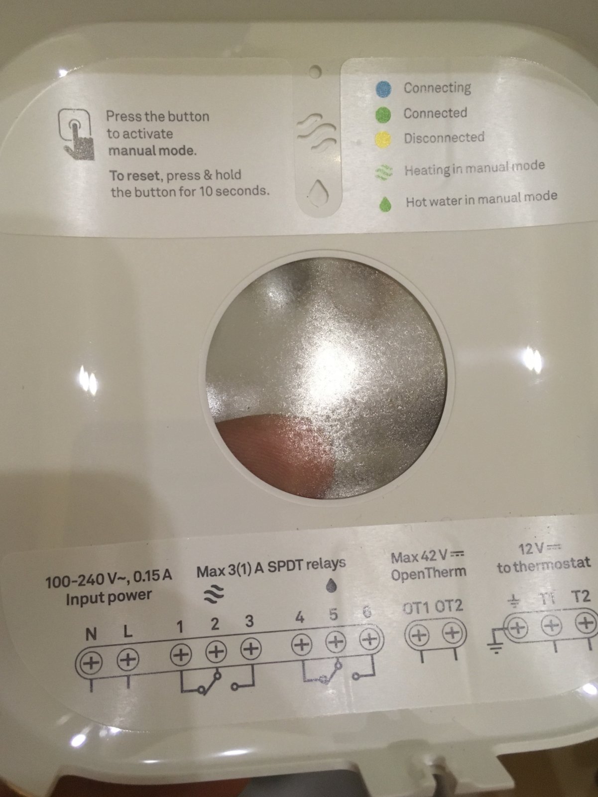

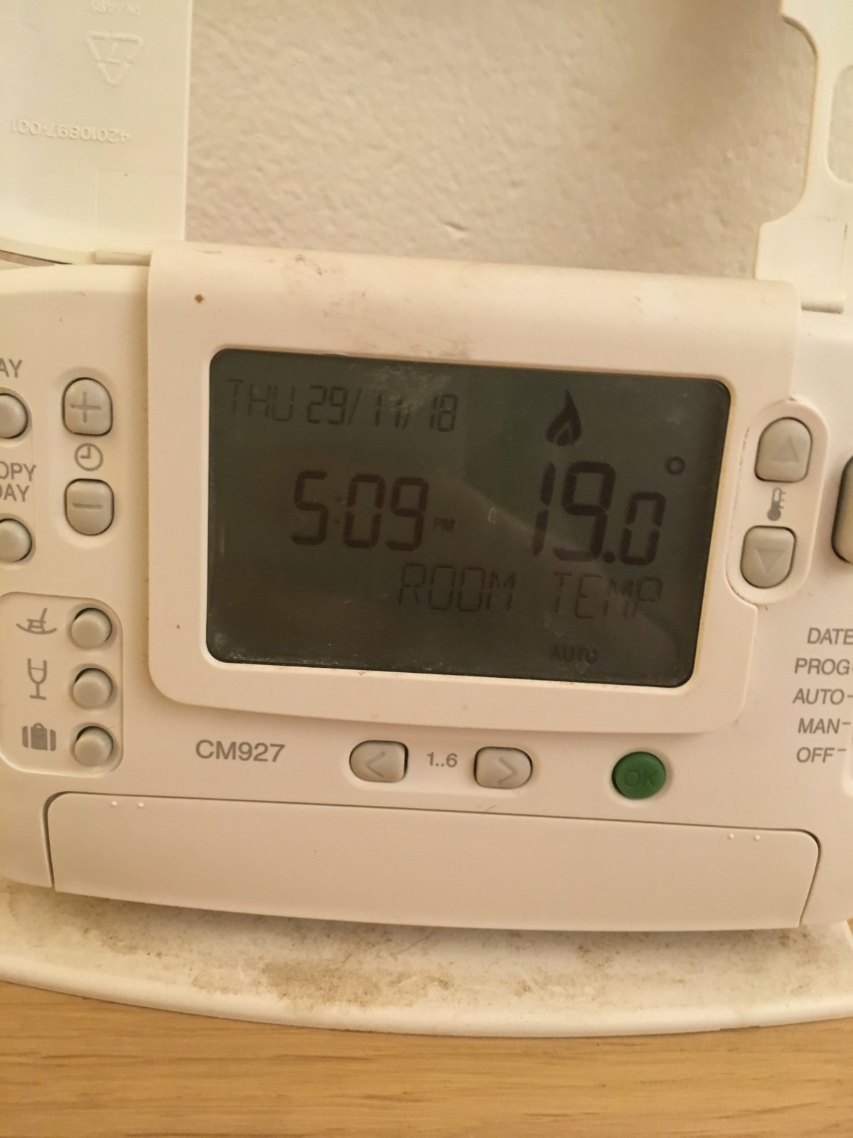

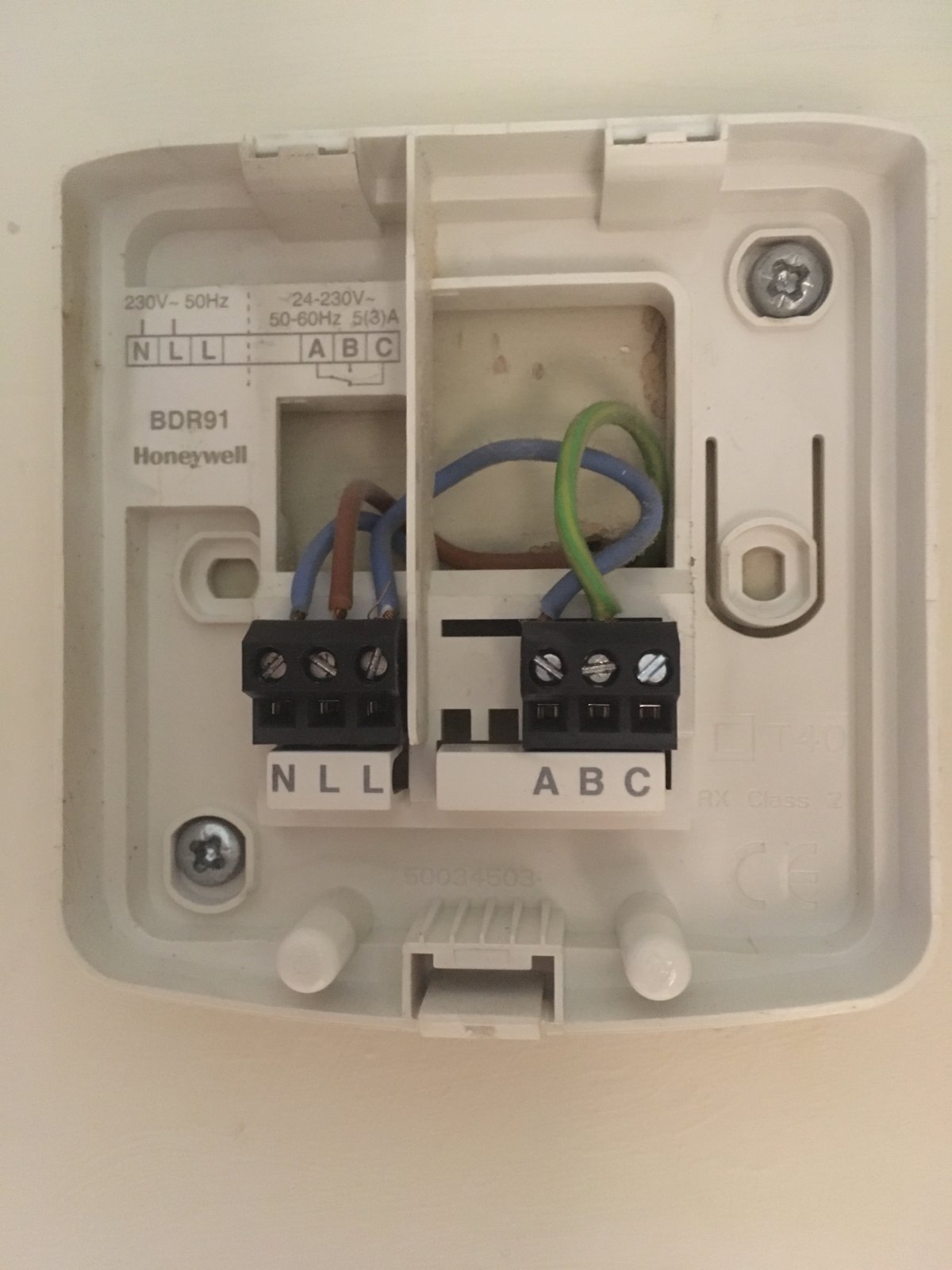

The boiler current has a Honeywell CM927 thermostat with only 5 wires one being a shared live so really only 4 wires as shown in the pictures, N L L and then ABC can anyone advise where these go on the Nest Unit, the Nest Unit is the 2nd picture with the Nest wiring diagram on it ? Hopefully the pictures make it more obvious :)

So I’ve been reading and I think I’ve got it, I’ve measured the voltage across A and B on the BDR91 and it’s 8v which means I have a low voltage switch. So from using the BDR91 as an example I would connect the existing connections to the Nest as so:
L->L
N-N
Shared Live -> 2 on Nest
B -> 3
How does that sound ?

I'm a bit puzzled why you are asking. You have posted the answer yourself:
Existing stat
Nest
The wires, including the link, simply move across from the Honeywell to the Nest terminals that have exactly the same function: The two (L) terminals at the Honeywell are connected together, so are electrically actually the same terminal.
So..
Honeywell CM927 (N) = Nest (N)
Honeywell CM927 (L) & (L) = Nest (L)
Honeywell CM927 (A) = Nest 'Heating Common' (2)
Honeywell CM927 (B) = Nest 'Heating call for heat' (3)
The green/yellow wire is being used as a live wire. This is bad practice. As a minimum it should have a brown sleeve over it to identify it as a live wire.
The link is also a live wire and should be brown not blue, also bad practice.
