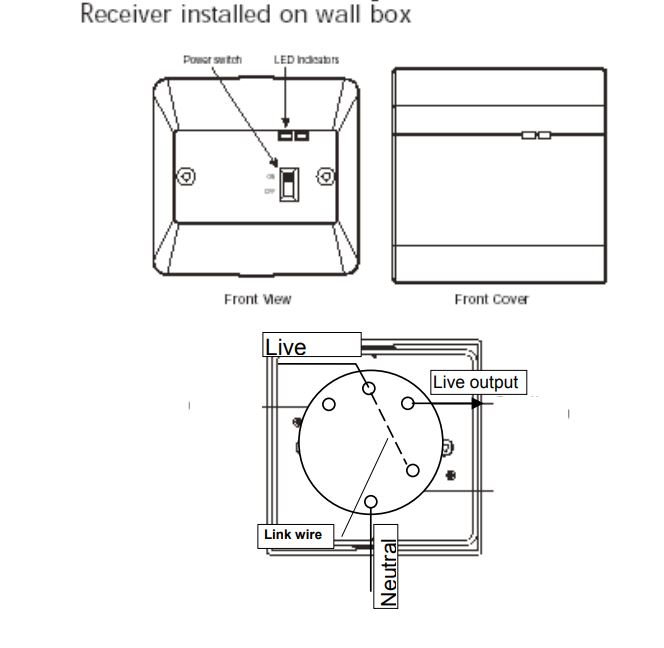

The Towerstat RF documentation I have shows it as:
The wire presently in 'Live' goes to the Nest Heat link (L) and also 'Heating common' (2)
The wire presently in 'Neutral' goes to the Nest Heat link (N)
The wire presently in 'Live output' goes to the Nest Heat link 'Heating on' (3)
Finally the Nest thermostat needs a 12v supply to power it. It can get this by being wired to the Heat link terminals T1 & T2. Don't forget the earth connection next to T1 & T2.
Alternatively you can power it by using a separate plug in power supply.

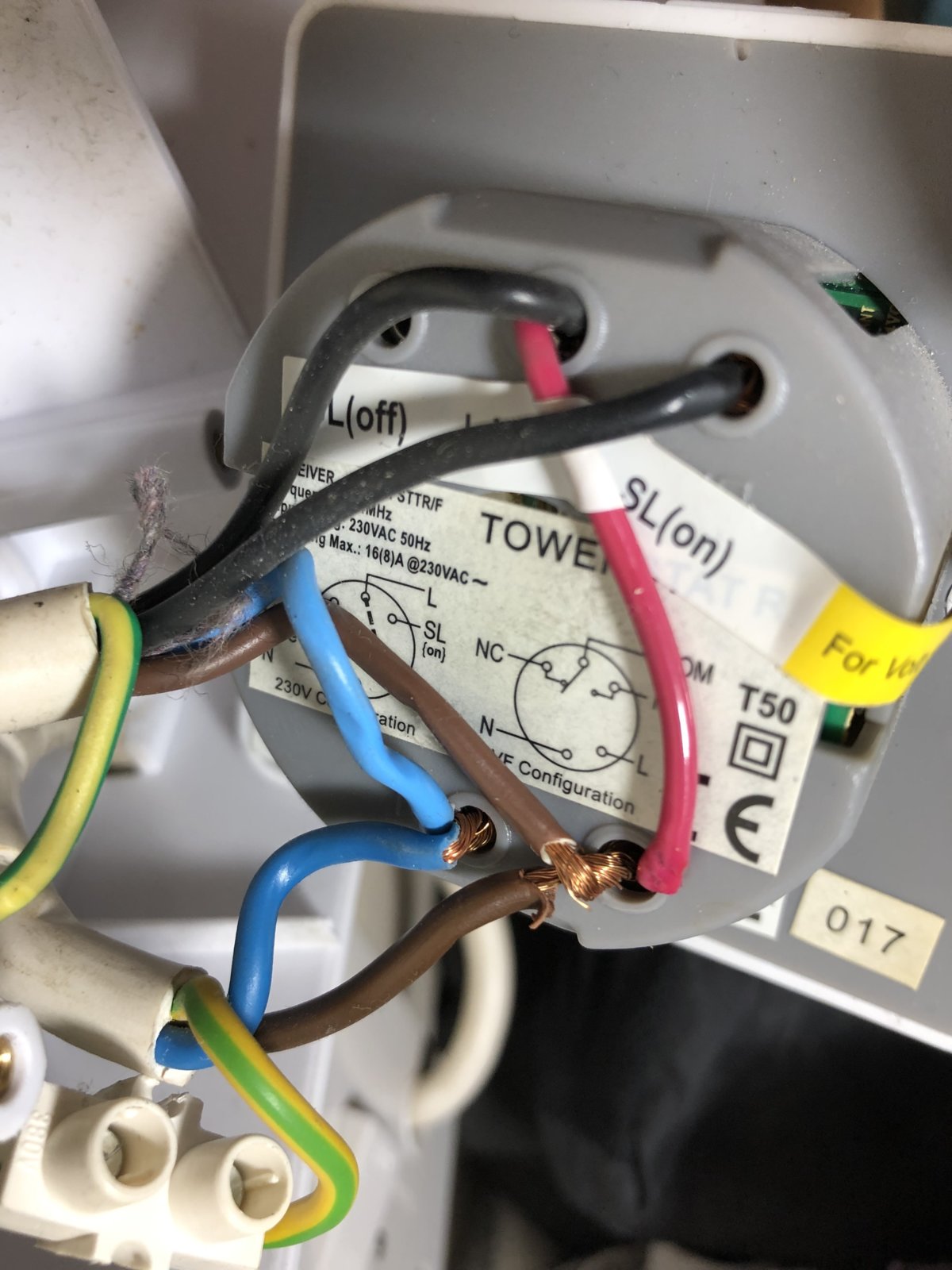

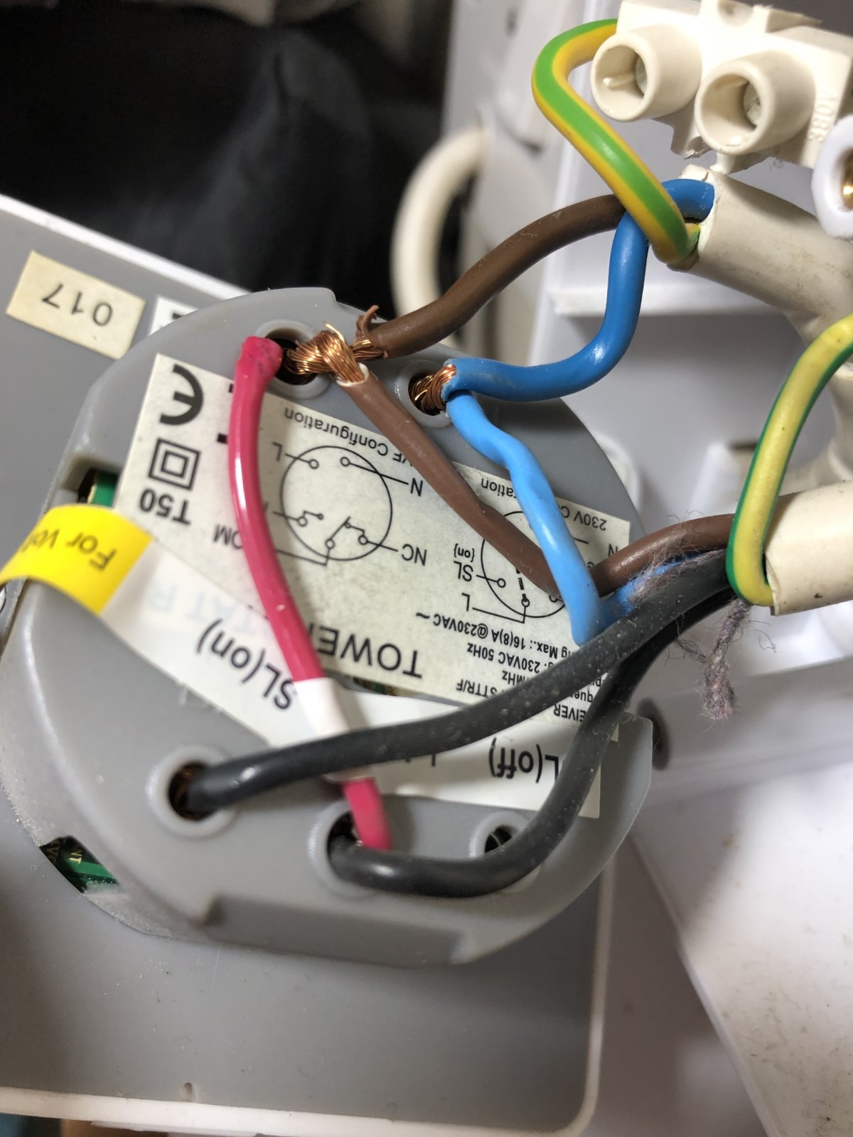

20181129_150250547_iOS.jpg This is the back of the current Towerstat RF. Does your advice still apply Stem? seeing as i have wires in the bottom right connector?
Yes it's still correct. Unfortunately, the original installer has also used the thermostat as a junction box, and done so badly. :rolleyes:
All of the wires that are presently connected together will need to stay that way so electrically:
All three wires now in L connect to Heat link (L) [including one end of the red loop]
Both wires now in N connect to Heat link (N)
Both wires now in 'Com' connect to Heat Link 'Heating common' (2) [including the other end of red loop]
Black wire on its own in 'Switched live / NO' goes to the Nest Heat link 'Heating on' (3)
You will never get that many wires into the Heat link terminals. If I was doing it, I would run them to a junction box first, and then just run four single wires to the appropriate Heat link terminals.
