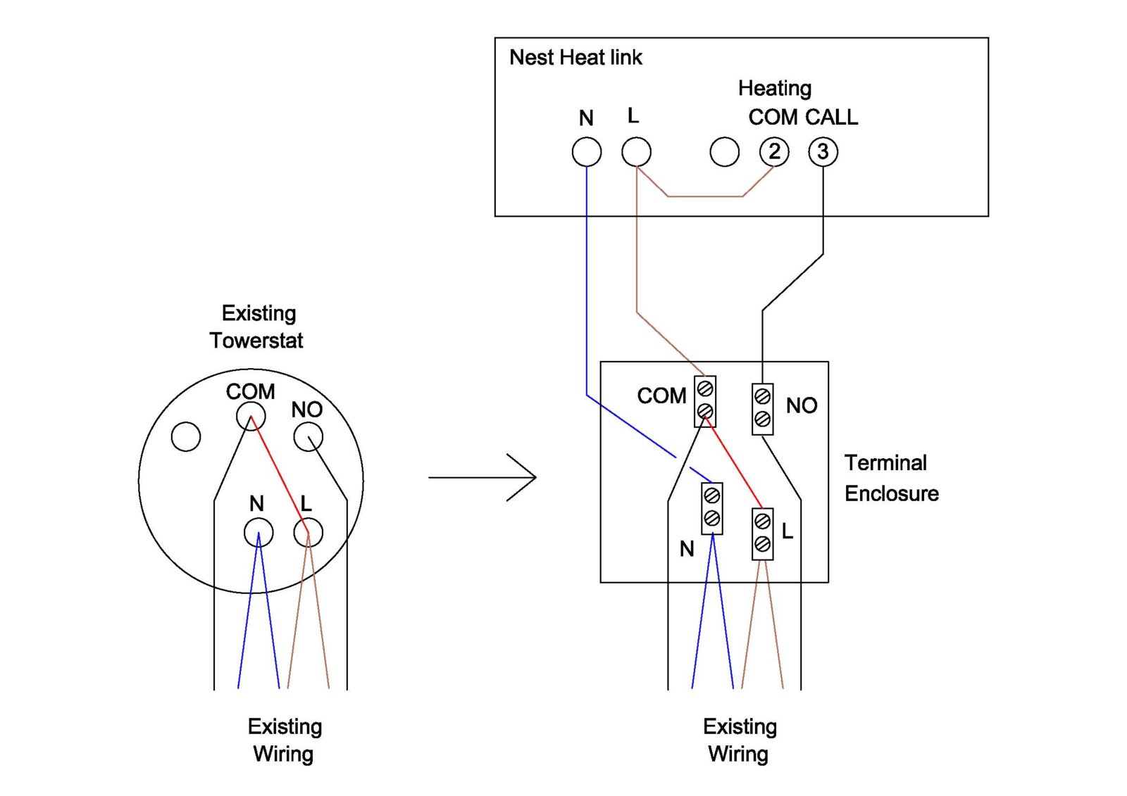

    Diagram below as promised. The left diagram is what you have now and the right shows how I would remove the Towerstat and connect the Heat link to the existing wires. Take care not to mix the two black wires up when moving them.
    It appears from your photo that the Towerstat is fixed to a surface mounted pattress box. If so, this can become a junction box to contain the new wiring terminals. You can buy a blanking plate to cover it.
    I have adjusted what I said earlier slightly, in that instead of running 4 wires to the Heat link you will see that I've only used 3 and added a link between the Heat link terminals L and 2. Electrically the circuit is exactly the same as before, but doing it this way has two advantages:
    1) It will allow you to use standard 4 core cable (3 core + earth) to connect to the Heat link
    2) You won't have to try and cram 4 wires into one of the new terminals
    Earth wires aren't shown for clarity, but I can see an earth terminal in your photo. That can stay as it is. The earth wire in the new cable can be used to connect it to the Heat link earth terminal.
    The wiring to the Nest Thermostat isn't shown, in case you plan to use a separate plug in power supply for it. If you do want to hardwire it, two new wires would connect T1 & T2 at the thermostat to T1 & T2 at the Heat link respectively.
    Final note: I don't know what type of wireless thermostat is presently being used in conjunction with your RF receiver. If it is just a basic thermostat controlling only the temperature, and there is a separate on/off timeswitch somewhere else controlling the heating, that would need to be set to be permanently 'on' to keep the Heat link permanently powered and to stop it interfering with the operation of the Nest.

    Thanks again Stem, i’ll Be looking at this when I get home. Can I use simple connector blocks inside the patterns, seeing as they will be covered with a blanking plate?

    The pattress when it has a lid on will be fine as a junction box, so simple connector blocks are fine. Try and make the connections better than they are now, there's too much copper on show. On the other hand don't go to the other extreme, the screw has to connect with the conductor, not the insulation.
    If the pattress doesn't have cable clamps, any exposed cables that could be accidentally pulled should be secured, so as not to put stress on the terminals. That could mean either clipping them in place or running them inside fixed trunking.

    So, thanks for all your help, I muddled my way through to getting it wired and set up.
    However, as lot of of people tend to have, the heating seems to be permanently on, even when I command nest to turn it off.
    So for tonight I’ll have to switch off at the fused spur and address it tomorrow, hopefully after some further advice from you guys on here.

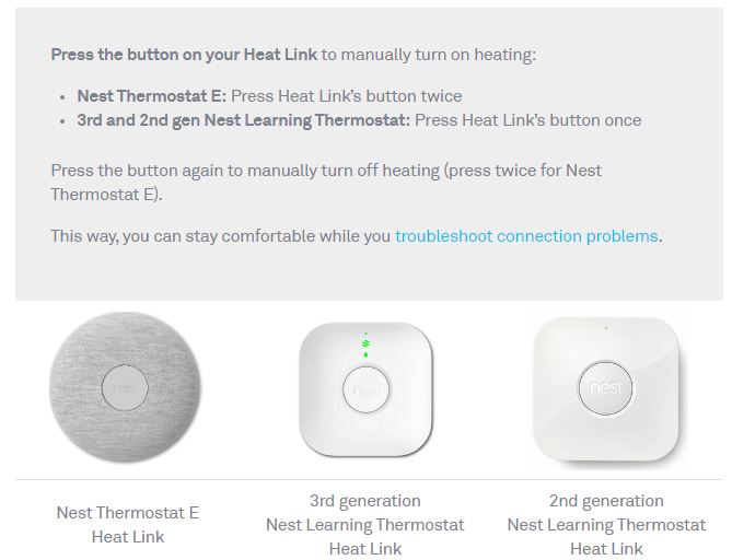

    There's an easy test that will point you in the right direction. What happens when you switch the heating on and off manually as per the below?
    If it does turn on and off manually the wiring is correct, meaning that the software / set up is incorrect.
    If it doesn't turn on and off manually, the wiring is wrong.

    Think it’s the latter
    But I’m sure i’ve Followed your diagram correctly. I even FaceTimed my stepson who conformed the way you’d do it (in my current situation) as the most logical.

    Morning all,
    Is it possible that I’ve got my black wires the wrong way round?
    If I swap them am I likely to damage something?

    Yep, looks like that’s done the trick

    Well I did warn you! :rolleyes:
    Anyway, glad you got it working in the end.
