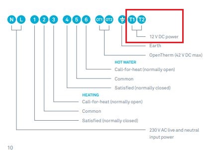

The Nest 3rd Gen thermostat has two parts.
1. The Nest Heat link that is connected to the wires that now go to the existing programmer (UT2) The Heat link is basically just an on/off switch
2. The Nest Thermostat is what senses the actual room temperature and has the control functions. It is designed to replaces the original room thermostat (RS1 in your case) The Nest Thermostat tells the Heat link to turn on / off.
The Nest thermostat requires a 12v supply to power it. It must not be connected to mains voltage. The thermostat can get this 12v by being wired to the special terminals provided at the Nest link.....
....or it can be connected to a plug in power supply.
However the original thermostat will still be electrically connected to the heating system, it can be removed, but it can't just be disconnected otherwise the heating wiring will be left open circuit and won't work. So the two thermostat switching wires would have to be joined to complete the circuit. The wires in question are those in the terminals L and 3.
Ideally the thermostat cable would be traced back to its origin and all of the wires in it disconnected. Then a wire would be inserted to join together the two terminals which the two switching wires have just been removed from.

He says that he can connect the thermostart in the same place the old thermostat is, with no extra wiring and quote: "We can use the existing thermostat position. No rewiring required. Don’t worry about the voltage, Heatlink sends the voltage down existing wires."
Is this ok?
BTW Happy XMas! and many thaks for your help :)
Yes, you can use the existing wiring from the existing thermostat, if it’s 3 wire, then do away with the neutral wire (safely terminating in. Connector block, or disconnect both ends and snip wires back). Position heat link in the kitchen if it’s easy enough, or decommission the UT2 and place heat link where the wiring center is.
If all you’re wanting to do is replace the existing thermostat with a Nest, then you could opt for the Nest E - a 2 wire switching battery operated thermostat.
