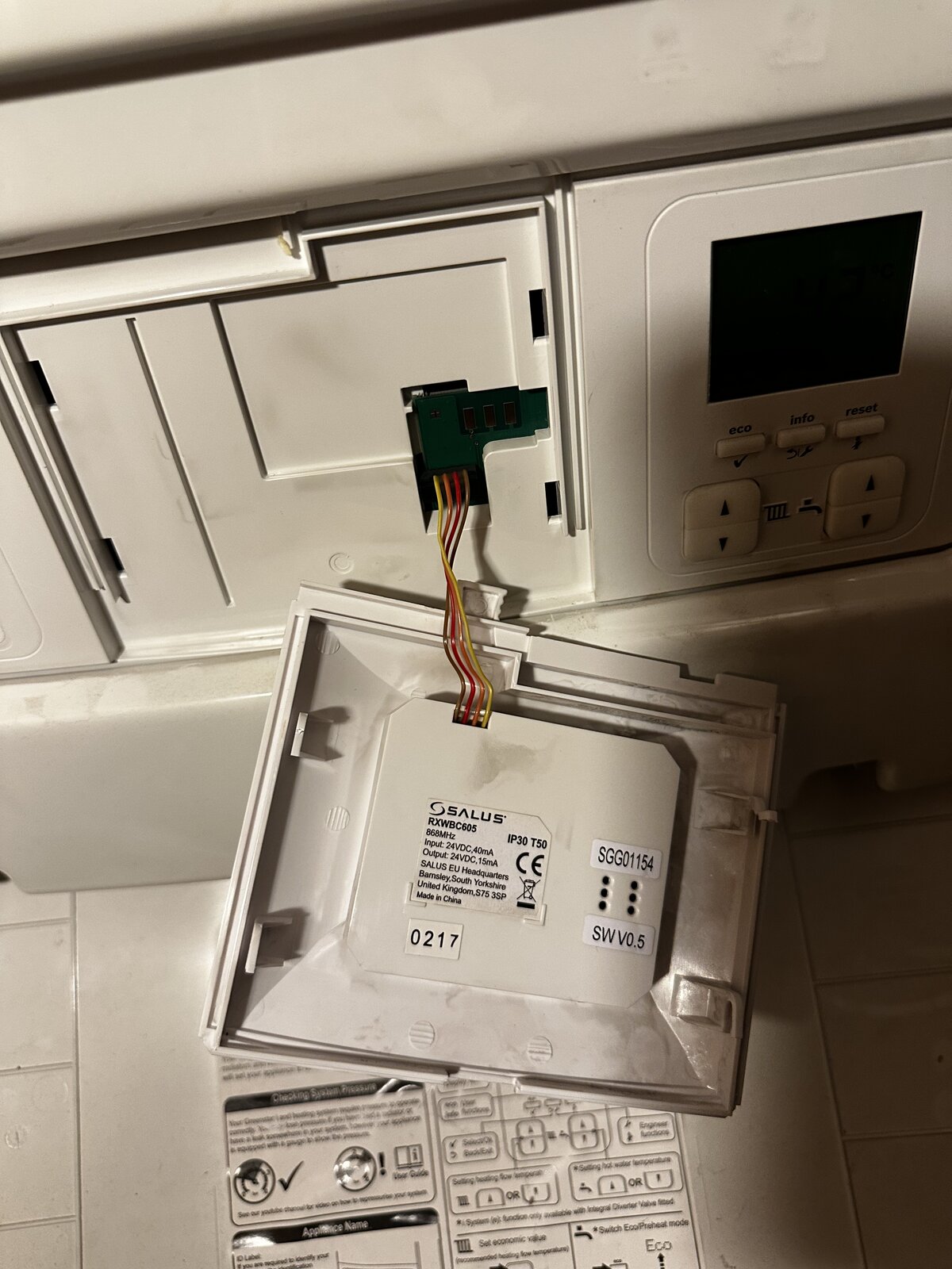

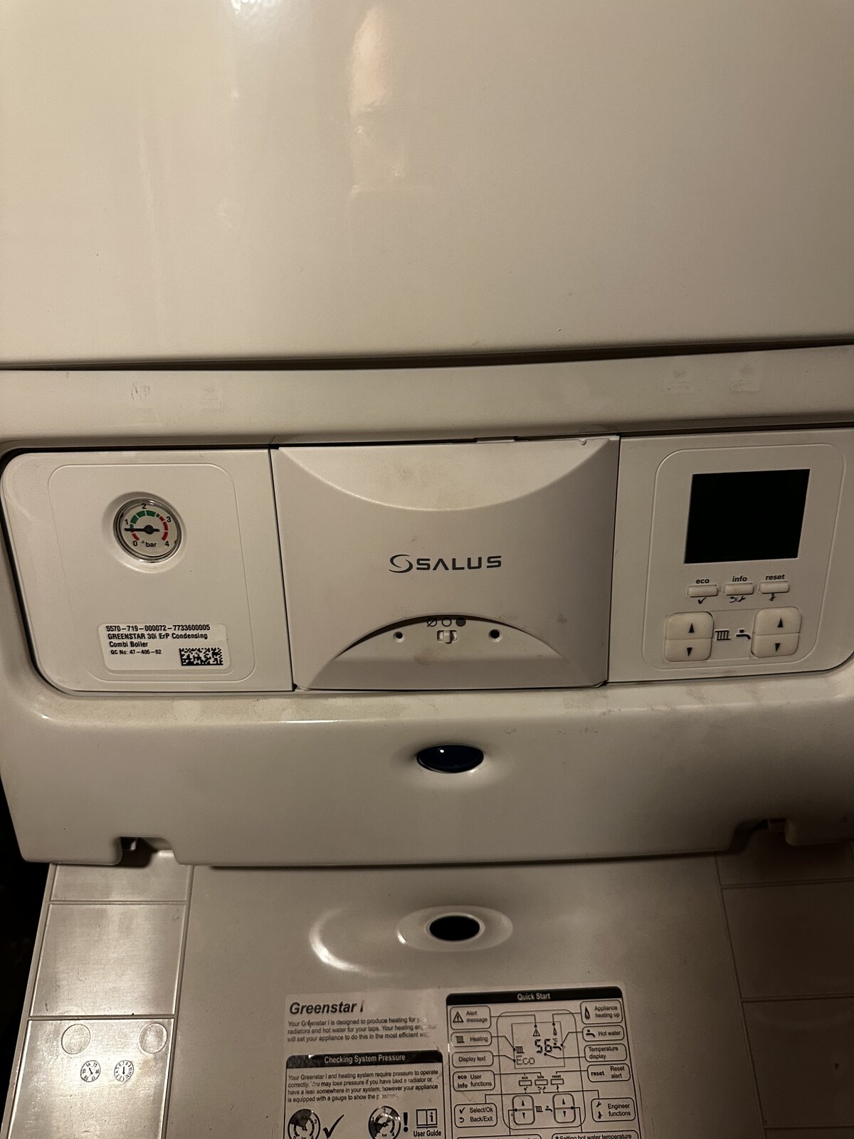

Hey all - I appreciate similar questions have been asked here before so I apologise if this is a duplicate.
I’ve just moved into a new house and I wish to install a nest thermostat. My boiler appears to have this salus transmitter built into it?
Can anyone advise me if it’s possible to replace this with a nest and how I might go about it. Thanks
Pete

in your first pic , you need to disconnect that ribbon, then the nest receiver gets wired into the boiler wiring strip, and you should top up the pressure on your boiler before it stops working
