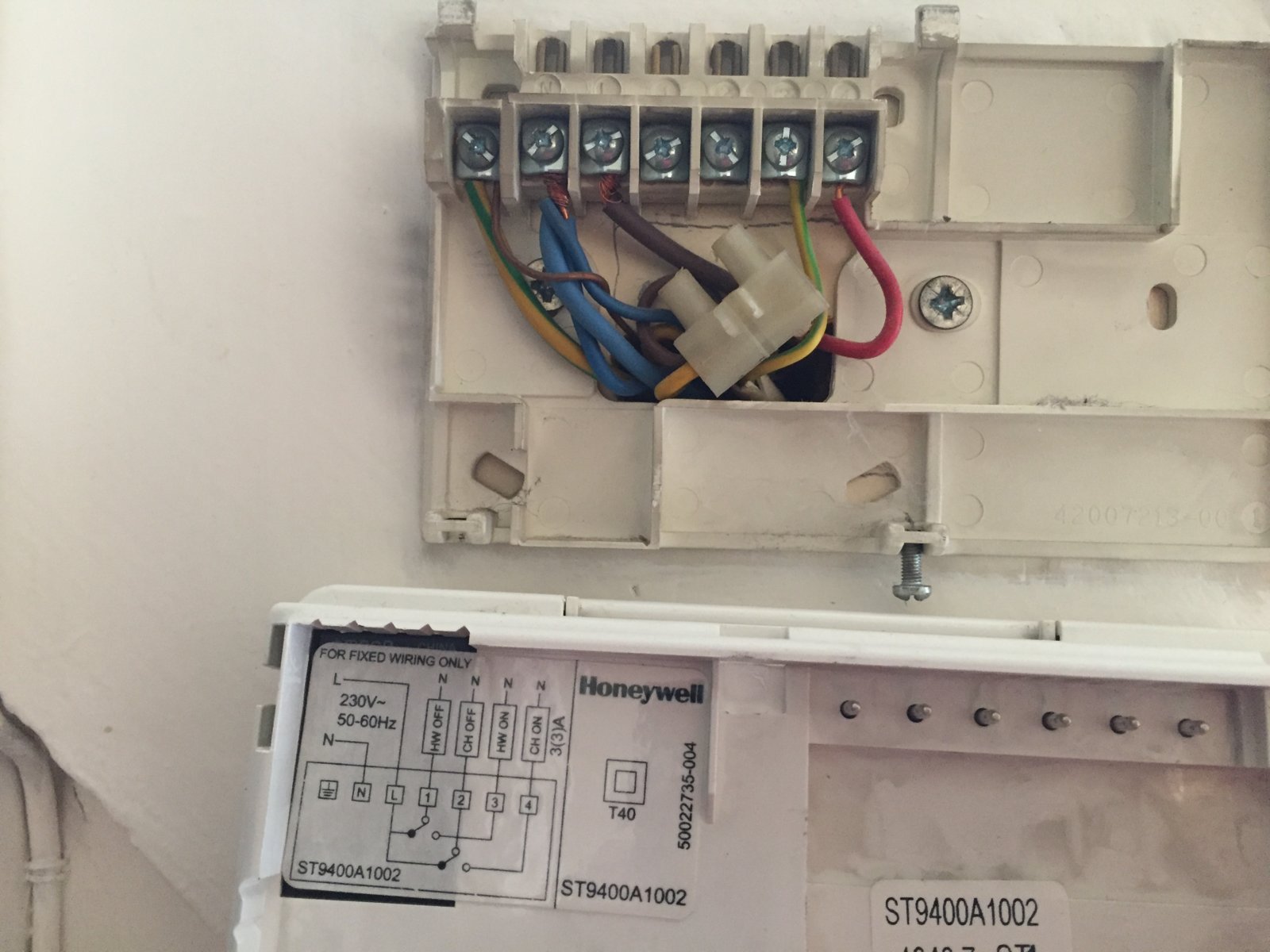

I'm fairly competent electrical wise, however having read up on DIY installing Nest into a S Plan system - now faced with the practical question of how to identify the connection to heating thermostat - see below picture
Any tips on how identifying which terminals go to the heating thermostat and which go to the current Honeywell controller ?

Has this been powered up yet???...unless my eyes deceive me it looks like the grey core @ MV (perm live) terminates to neutral..:)
8 and 5 are the browns that open the zone valves, it will be the room stat and cylinder stat connected to one of each, you should be able to trace the programmer feeds with a multimeter, the oranges switch the boiler on/greys are permanent live.
Usually, the easiest way, is to replace the existing programmer with the Nest Heatlink, Normally all of the wires you need are in there.
Then all you need to do at the wiring centre in your photo, is to identify the cable going to the existing room thermostat, remove it and link the terminals where the two thermostat switching wires came from, together to complete the circuit.
If you need any help, post details of your existing programmer and room thermostat, as well as details of where the room thermostat wires are connected at the wiring centre, it's a bit difficult to see in the photo what goes where.
One wire from the room thermostat will be connected to the brown wire at one of the motorised valves. But because there are two motorised valves both wired to thermostats (Room stat and hot water cylinder stat) It's impossible to tell which is which from the photo, so you will need to tell us which is the room thermostat wiring.
Evening, thanks, appreciate tips so far, this is existing working system prior to Nest install, issue is six cables come through the wall and difficult to trace - four cables come sideways into wiring centre, from these I have been able to tell that -
Incoming Live is 1
Incoming neutral is 2
Earth 3 & 9 & 15
The wall stat I think is on 4
one side heating valve connector is on 5 ?
water tank thermostat on 6
nothing - 7
one side water valve on 8
earth 9
2nd side of both heat valve & water valve on 10
nothing - 11
one side of the pump appears to be 12
nothing 13 & 14
strange as a wire from heating valve goes to 16 but no other wire is connected ?
The Programmer is Honeywell ST9400
I will look again tomorrow and see about taking programmer off to see if can trace its wires back to wiring centre
But looking at prior diagrams on this forum - does not seem to be any real standard on which terminal in the wiring centre goes where - thus I guess going to have get meter and test each one.
Thanks for any thoughts or observations that might help.
Magnus
& @stem - yes that was the plan (just swapping programmer for Nest) it was the thermostat wires to use for 12v that started me into the wiring centre. appreciate tip though - one thought now is turn it all off, take thermostat apart and connect tone generator and then return to wire centre to find it - this should work right ?
Unfortunately when it comes to these systems, much is down to the personal preferences of the original installer and the location of the various components to each other. You seem to have some idea of what the wires are, so you can test the wires you think are the room thermostat with a continuity tester to be sure. Remove them from the wiring centre when you do (after making careful note of where they came from) so that you are not measuring other components that they may be connected to.
You say that you have a Honeywell ST9400 programmer, but make no mention of wires from it, other than perhaps the main supply. However, if your system is presently working as it should be, there is probably no need to trace the wires back from the programmer to the wiring centre, they should be easily identified from the terminals they are presently connected to at the programmer end. The room thermostat cable is the one you need to find.
You probably have this sussed now, but for those reading, the easiest way to identify the cable cores going to the room stat are to identify the heating zone valve, follow the cable into the wiring centre, the brown core will often connect to one side of the room stat. You can normally then identify the physical cable going to the stat, which, by taking the room stat off, you'll see the two live cores, 1 will be the same colour as connected to your brown on the heating valve, the other will be connecting to the heating "on" from the programmer.
Simply bridge these to leave the two room stat cores vacant and connected them to T1&T2 on the nest gen3.
