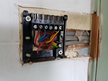

I currently have an Invensys UP2 timer in the kitchen, and the Honeywell (wireless) HCW80 thermostat in the hall. The plan is to replace both of these with the Nest 3rd Gen Thermostat.
The honeywell as stated above is wireless, and connects to a heatlink which is hard wired in to the boiler upstairs. The timer in the kitchen is hard wired and I have attached an image of the cabling that goes in to it.
Based on the instructions supplied with the Nest, I know that the cables are the following, but cannot figure out what the cable going in to '4' would be, can anyone help on this or can I just terminate this cable as it won't be needed?

I know there are many videos on the internet, which show people connecting the old cables up to the new Nest thermostat, but some have more cables and some less, so I don't want to start making assumptions.
N - Neutral
L - Live
1 - Satisfied (optional?)
2 - Common
3 - Call for Heat
You are looking at entirely the wrong information, and the old programmer numbering is not the same as the nest numbering. The wire connected to terminal 4 is not spare it is central heating on.
The wiring diagrams are supplied on the back of the old programmer and in the nest installation manual.
