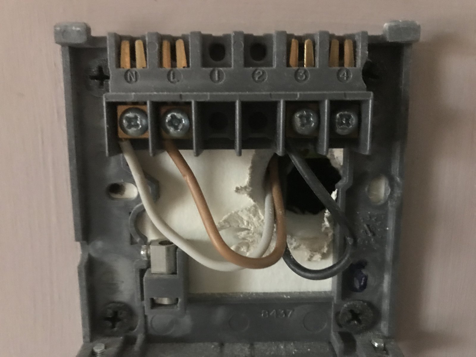

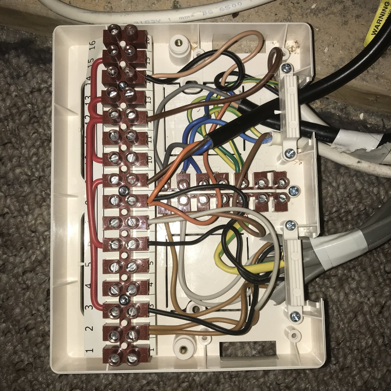

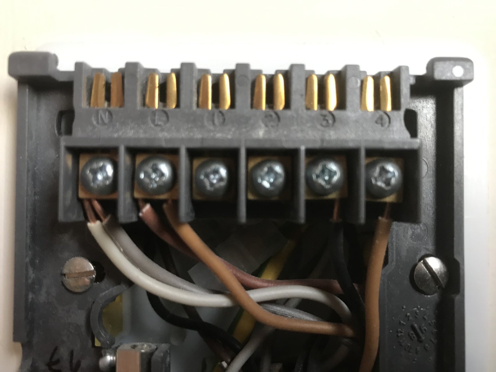

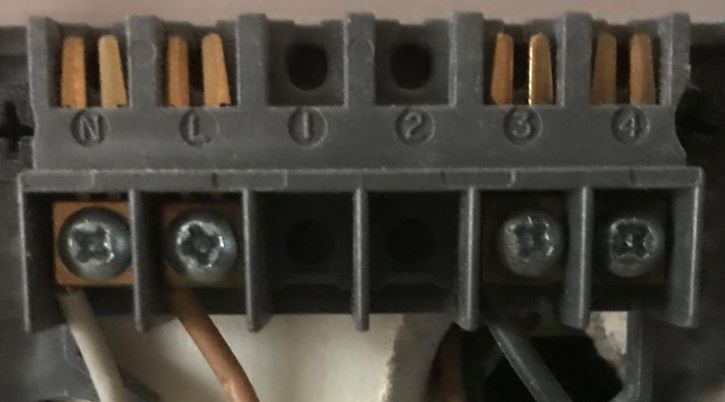

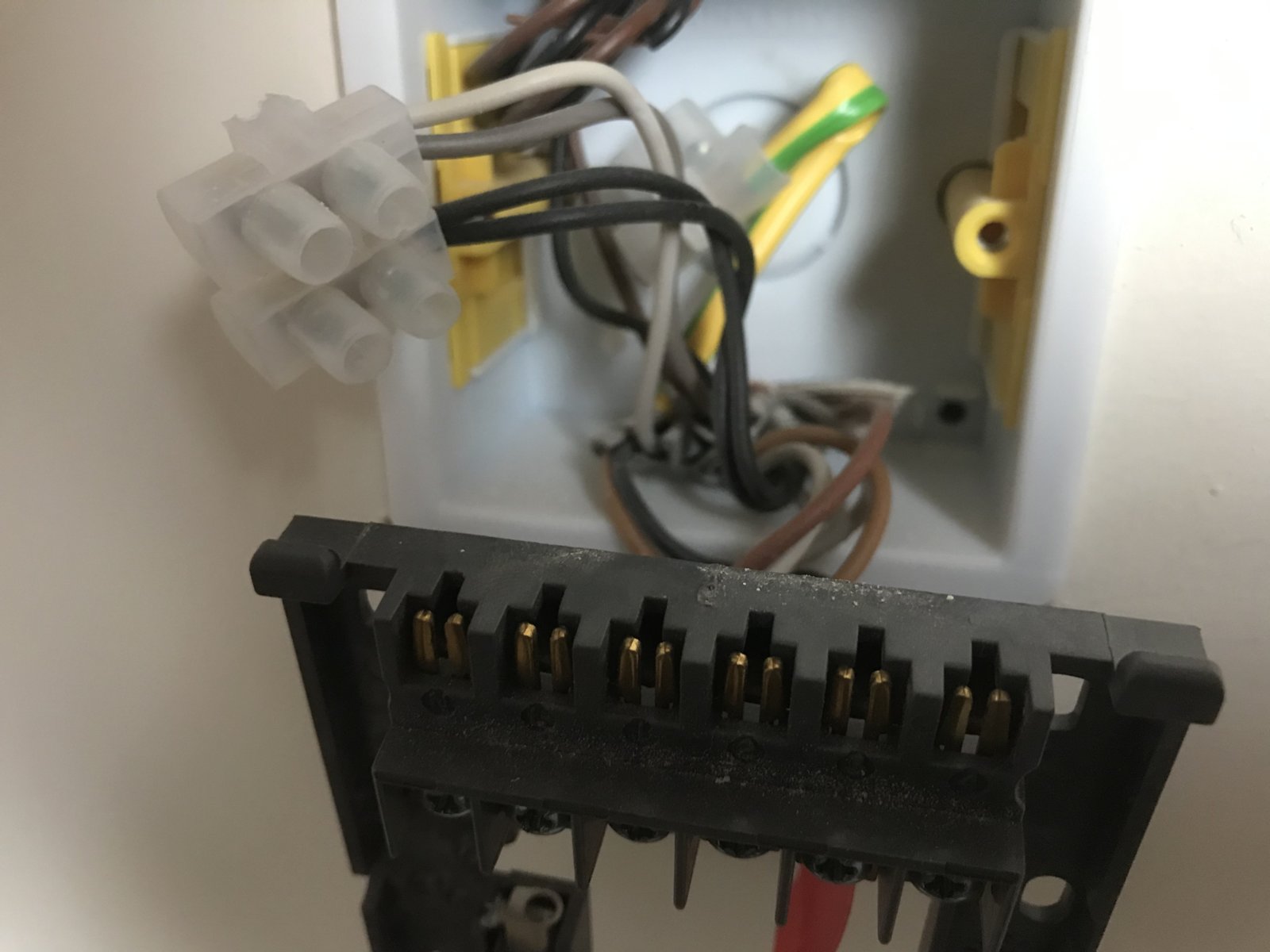

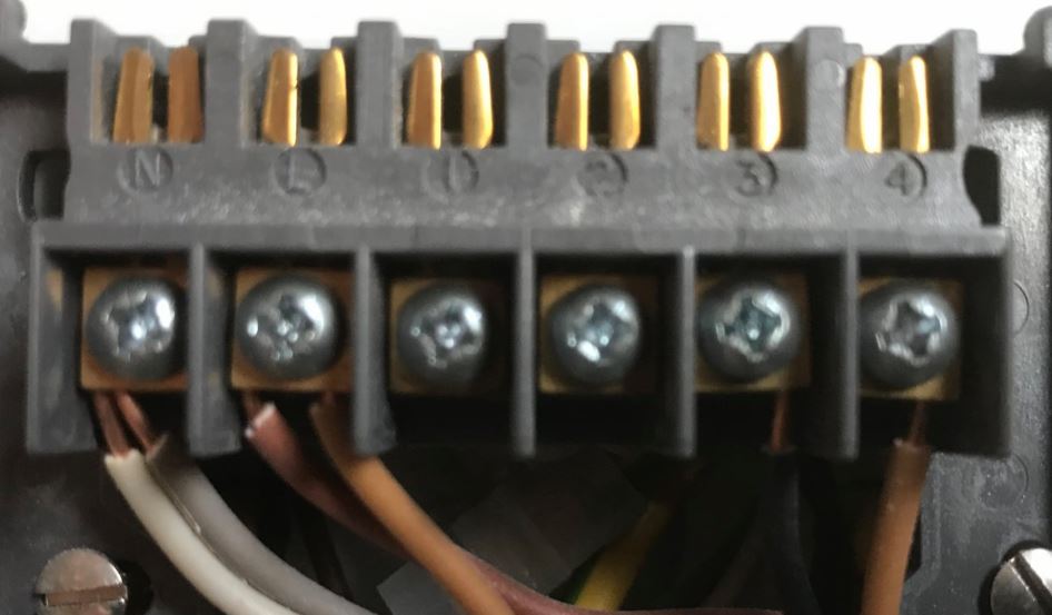

Hi, I am replacing my current thermostat and timer which are danfoss, my boiler is an Ideal logic and I believe it’s a Y plan ( I could see only 1 motorised 3 way valve at the pump and hot water tank). I assumed it would be an easy enough install but find it hard to trace back wiring there is also an electrical junction box at the hot water tank. My query was where does the heat on wire feed back to the pump or the timer, I was going to use the live and neutral from the thermostat to power up the nest. Please see enclosed pics, the second last pic is the wiring to the timer the 4 wires that are in the terminal block ? and coiled up behind there is a brown and black with bare ends ? Any pointers would be greatly appreciated.

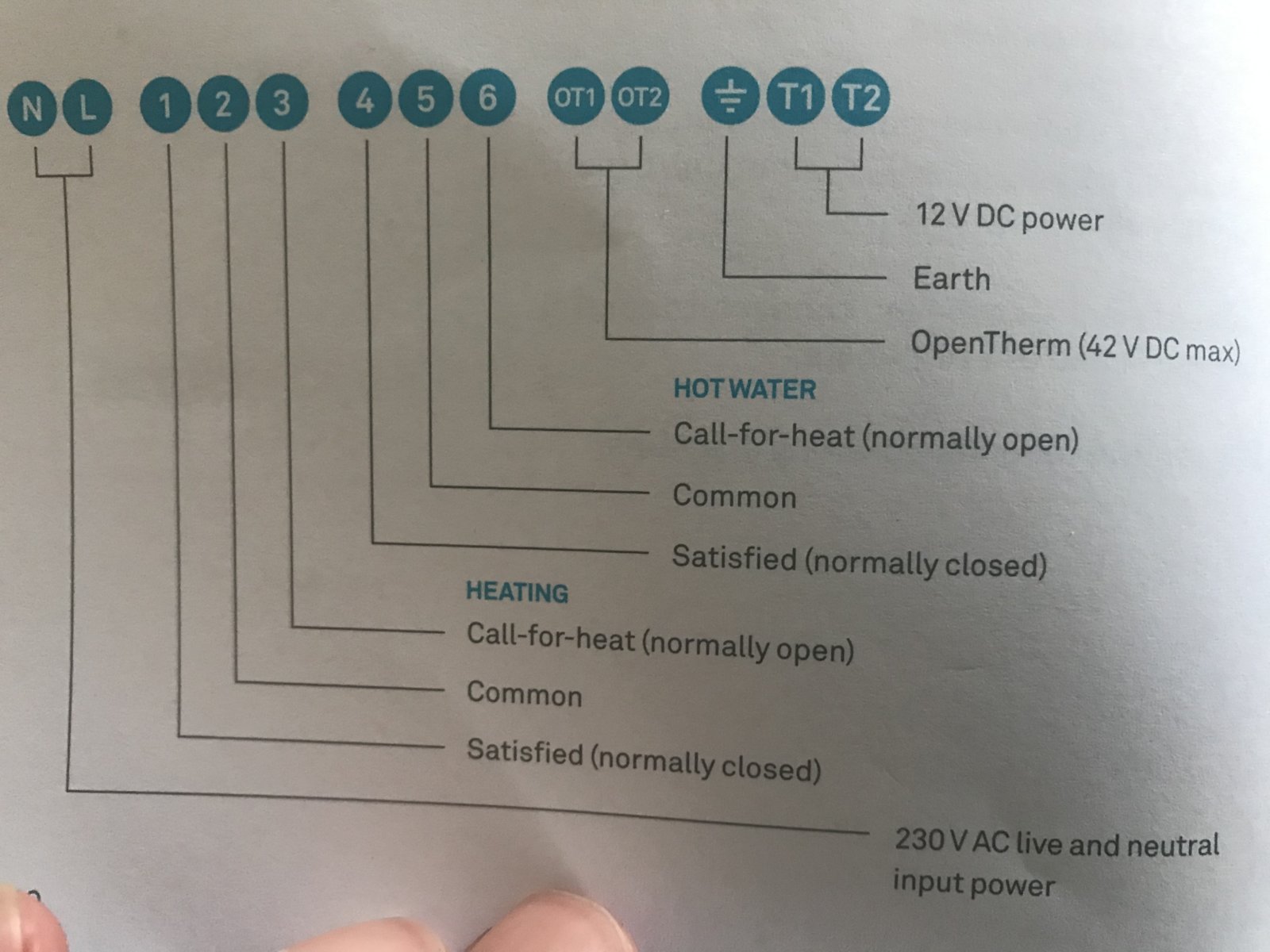

OP, the Nest Heat link replaces the existing programmer. As has been said previously, you are erm....just replacing a switch with another.
The wires in the programmer L go to Heat link (L)
The wires in Programmer N go to Heat link (N)
The wire in Programmer 3 goes to Heat link (6) Hot water call for heat
The wire in Programmer 4 goes to Heat link (3) heating call for heat
Also connect together Heat link terminals (L) (2) & (5)
The Nest thermostat can be powered by wiring it to the Heat link terminals T1 & T2, or by using a separate Nest plug in power supply.
You will also need to decommission the existing room thermostat.
If you are happy to leave it in place, then just move the wire from L and put it in 3 with the wire that is already there. If you want to get rid of the original thermostat; trace the cable from the thermostat back to its origin, disconnect all three wires and then join together the terminals that you have just removed the brown (L) and black (3) wires from.

You can use the old cable to provide power to the thermostat it but only once it has been completely disconnected from the mains wiring. More often that not though, it doesn't go to where the Heat link is located so isn't always that much use. It looks possible that it may go to terminals 2 and 3 of the wiring centre, as per the label as it appears to be connected to a brown wire going to a motorised valve via the red link. Hopefully the heating motorised valve. (installers don't always follow the pre- printed label)
If you want to site the Heat link near the wiring centre you can but you will have to disconnect the wires from the programmer and then wire the Heat link in in there place. So you will be pretty much re-wiring the system. I wouldn't recommend that for DIY there is too much scope to get something wrong.

If It does look like you say, that the original stat wires go to 2 & 3 in the wiring centre, is there any way I can connect from the wiring centre and tie it into the wiring centre that goes to the programmer? Hmm. If not it is looking like my option is to forget wiring T1&T2 then disconnecting the old stat and using the nest via a 240 plug/usb etc. But just to clear things up with me being a spanner monkey to decom the existing stat (which I’d leave in place ) I only have to move only have to move the live wire and wire it in with the black on the stat and just leave all the rest in place as in no need to disconnect at the wiring centre? Er what does this do or prevent? Just curious thanks
Thanks again,
Once the old thermostat cable has been completely removed from the wiring centre, you can put it in a junction box and connect a new cable to extend it to the Heat link if you like.
Yes that is correct, but the cable will still have 230V on its brown and black wires, so you won't be able to it for the 12v connection.
Electrically speaking there is no difference between the two solutions, it is exactly the same thing. With one the link is actually in the wiring center. With the other the wire goes out from the wiring centre to the thermostat where the link is made (by putting both wires in the same terminal) and then back to the wiring centre. It's just a very extended link.
The advantage of removing the old stat just means that you won't have a function less item on your wall, and you can possibly re use the wire for T1 & T2 if its buried in the wall.
