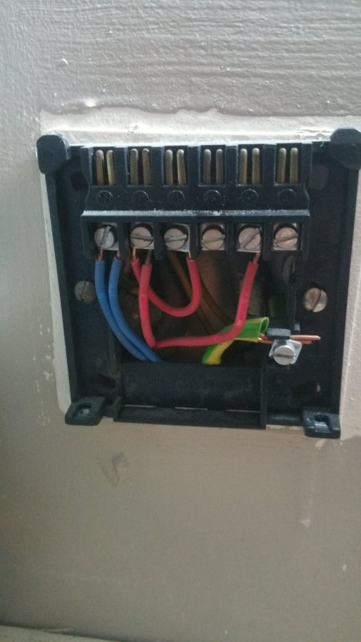

Here is my current setup to my Ideal Isar combi boiler.

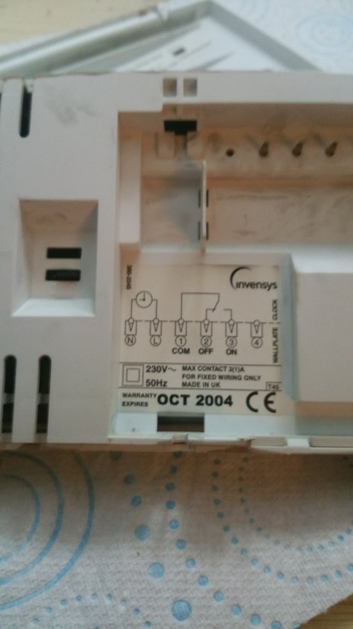

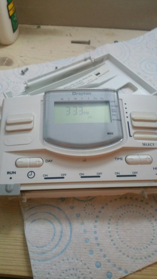

Picture of boiler programmer (Drayton Manor 2)

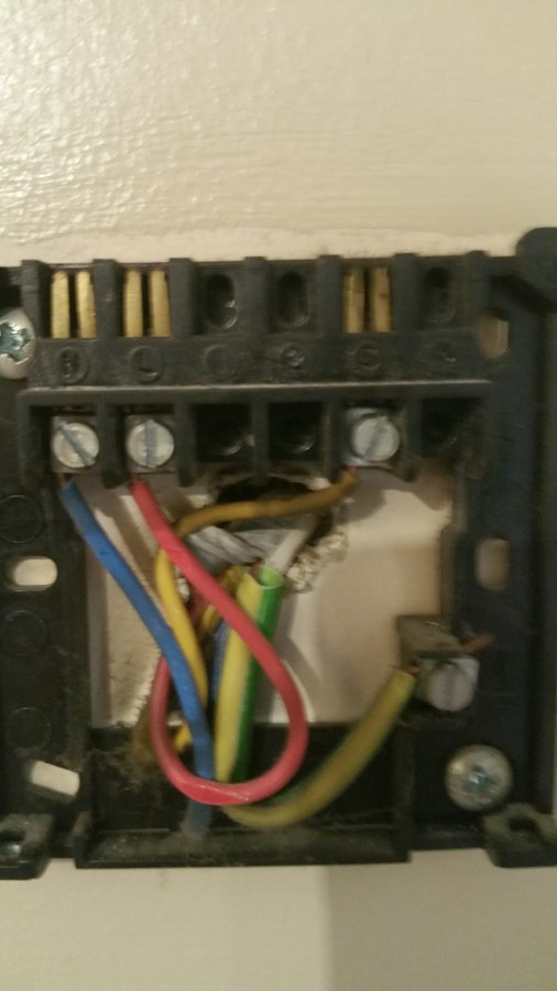

Picture of Thermostat RTS1

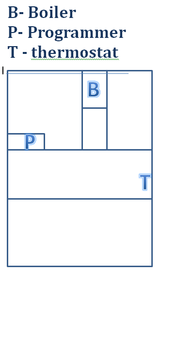

This is how it looks like in flat

Hi Agile thanks for replay.
I was thinking i can get Heatlink in cupboard where currently is Drayton programmer and thermostat where is current thermostat.
If it was for me then I would connect it between the 1 and 3 on the programmer and leave the room stat in place but turned up.
If it was me, I would connect it between one and the wire that yellow wire (behind the plate) is connected to. I would also remove the red at three and blue at N that goes to thermostat.
Once everything is running, I would ensure the wires at the thermostat are all dead. Tape and make safe for future

After a bit of research I`m under impression I can connect Heatlink where is current thermostat (N,L to N,L in Heat-link, wire from heat call to port3 in heat-link and cable from L to port2 in heat-link) and then place thermostat wherever i desire.
Any thoughts on that (and please explain clearly connections).

After a bit of research I`m under impression I can connect Heatlink where is current thermostat (N,L to N,L in Heat-link, wire from heat call to port 3 in heat-link and cable from L to port 2 in heat-link)
Yes you can do this, but if you do, you need to make sure that the Heatlink gets a permanent live. So, remove the existing programmer and its backplane. Reconnect the the two blue wires together as they are now. Then, join the two red wires together, this will provide a permanent live to the Heatlink (ie where the current thermostat is). Finally fit a single blanking plate over the opening to cover the wires.
