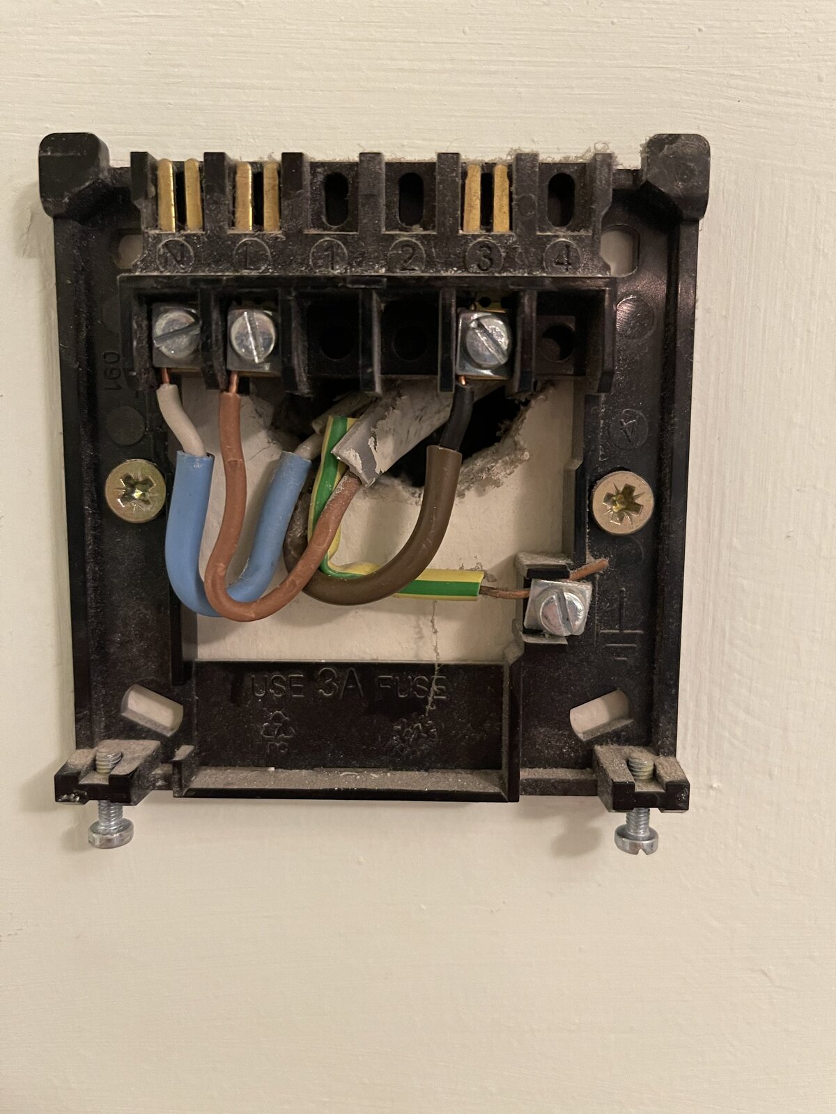

Good afternoon,
Im looking for some advice re the wiring for a Nest Learning Thermostat which will replace a Drayton LP111 programmer currently connected to a Glowworm compact 24C.
The current programmer is wired as in the attached image and any guidance would be greatly appreciated!

Hi,
I'm only a DIY'er, I'm sure a pro will be along soon!
That wiring is a little busy isn't it? :)
There is a third neutral wire connected in there, that I wouldn't expect.
Do you know what it is attached to?
Even if the third neutral is legit, the terminals on the nest are notoriously small - it is often a struggle to get two wires in, let alone three! :confused:

Don't worry too much about the busy wiring. Where the connections are made varies from installation to installation depending on the preferences of the original installer, what you have is not unusual. You might have to use additional terminals to get the number of wires down to get them into the Nest as @RandomGrinch has pointed out the Nest terminals are small and close together, and can be tricky for those of us used to wiring them.

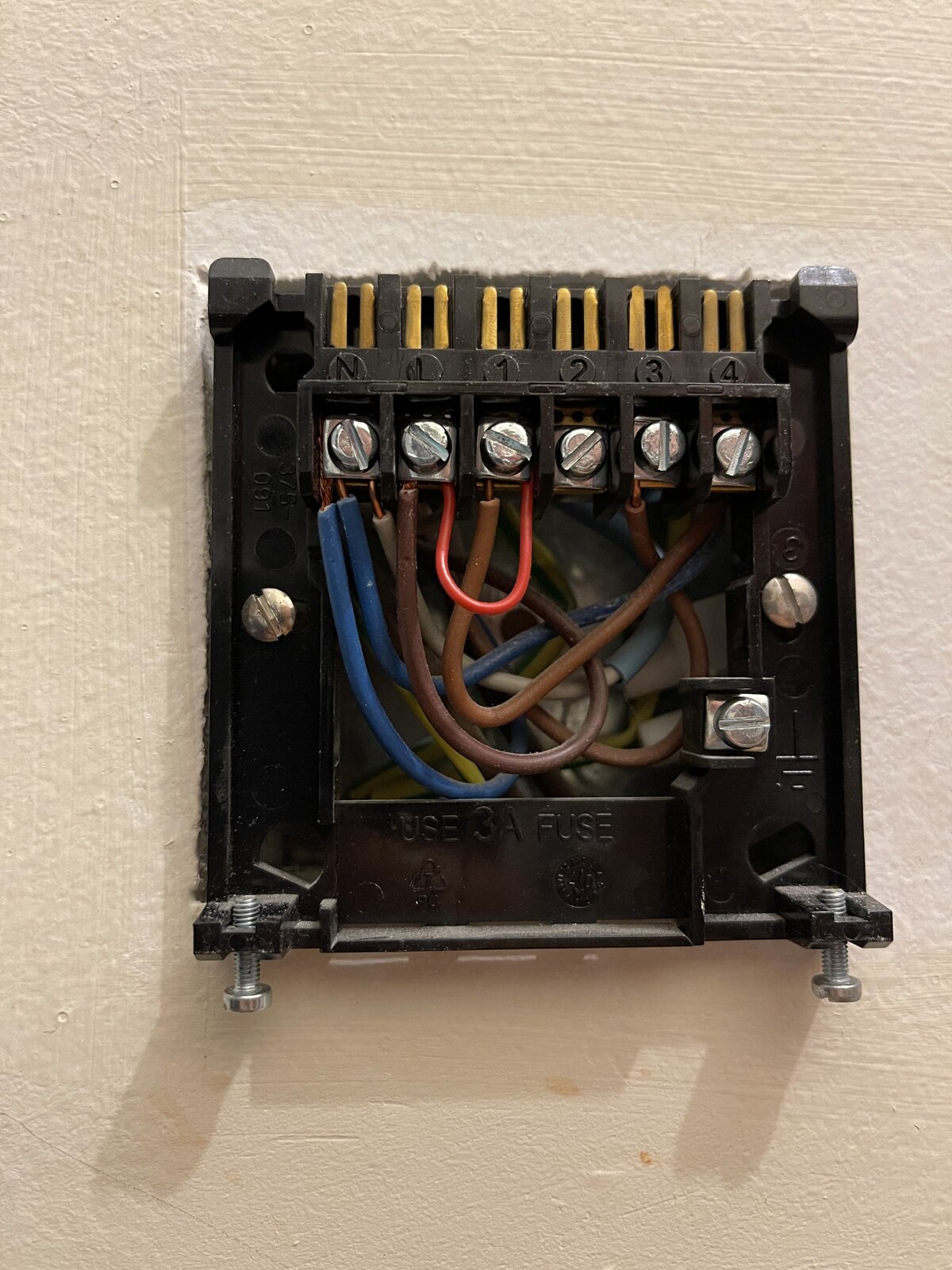

Just to confirm my wiring, because I don't want to get anything wrong!
Thermostat has a LIVE (BROWN), NEUTRAL (GREY, SLEEVED BLUE) and CALL FOR HEAT (BLACK SLEEVED BROWN). The neural goes to the neutral of the programmer. The live goes to call for heat of programmer and the call for heat is connected to the boiler’s call for heat via a cable connector.

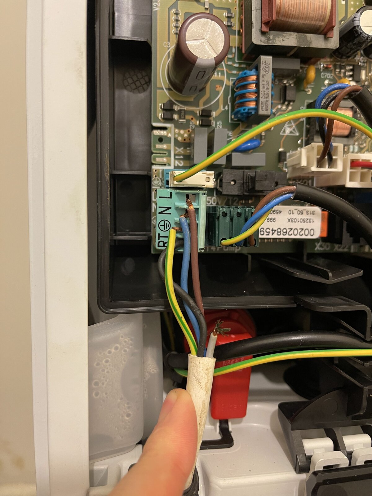

The boiler has a LIVE (BROWN), NEUTRAL (BLUE), EARTH (GREEN/YELLOW) and a SWITCHED LIVE/call for heat (BLACK). Live goes to live of programmer, neutral to neutral, earth to earth and the switched live goes to the cable connector to link to thermostat’s call for heat.
Then I have the power input from a fused switch. LIVE (BROWN), NEUTRAL (BLUE) and EARTH. Live to common of programmer, neutral to neutral and earth to earth.
Does this sound correct?

I'm confident you've got it - though it's worth waiting for the expert @stem to confirm! :)

In order to decommission the old room stat, I'd be looking to run a cable from (3) to the call for heat (RT) at the boiler? That leaves two wires to the old room stat, which I can plug into (T1) and (T2) for 12v power? That'd leave two neutrals into (N) from the fused switch and boiler.
Once the old cable is completely disconnected from the existing wiring you can use it to connect T1 and T2 of the Heat link to T1 and T2 of the thermostat. Also, as per @ianmcd I always connect the earth when using T1 and T2 for the thermostat as per the Nest instructions below, it offers protection should the 12v wiring accidentially come into contact with 230V. Any metal back box should also be connected to earth.
But please tidy these wire up as a matter of urgency. There's a big risk of a short circuit here. It just takes one strand of the wire in one terminal to touch the other. There should only be the tiniest sign of the copper conductors showing outside of the metal terminal
