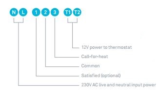

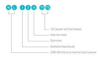

Step 1 - Install the Heatlink

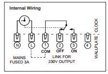

The Drayton LP111 connections are identified for you in the diagram below:
The wires need to be moved from the LP111 terminals, to the Heatlink terminals that carry out the same functions, and are identified for you below. 'N', 'L' and Com(mon') are the same for both, and 'on' at the LP111 corresponds to 'Call for Heat' at the Heatlink. [If your version of the Heatlink has terminals 4 5 & 6, for hot water control, there is nothing to connect to these]
If there is presently a link on the LP111 between 'L' and 'Com' you will need to reinstate it between 'L' and 'Common' at the Heatlink. Do not add one if there isn't one there now.

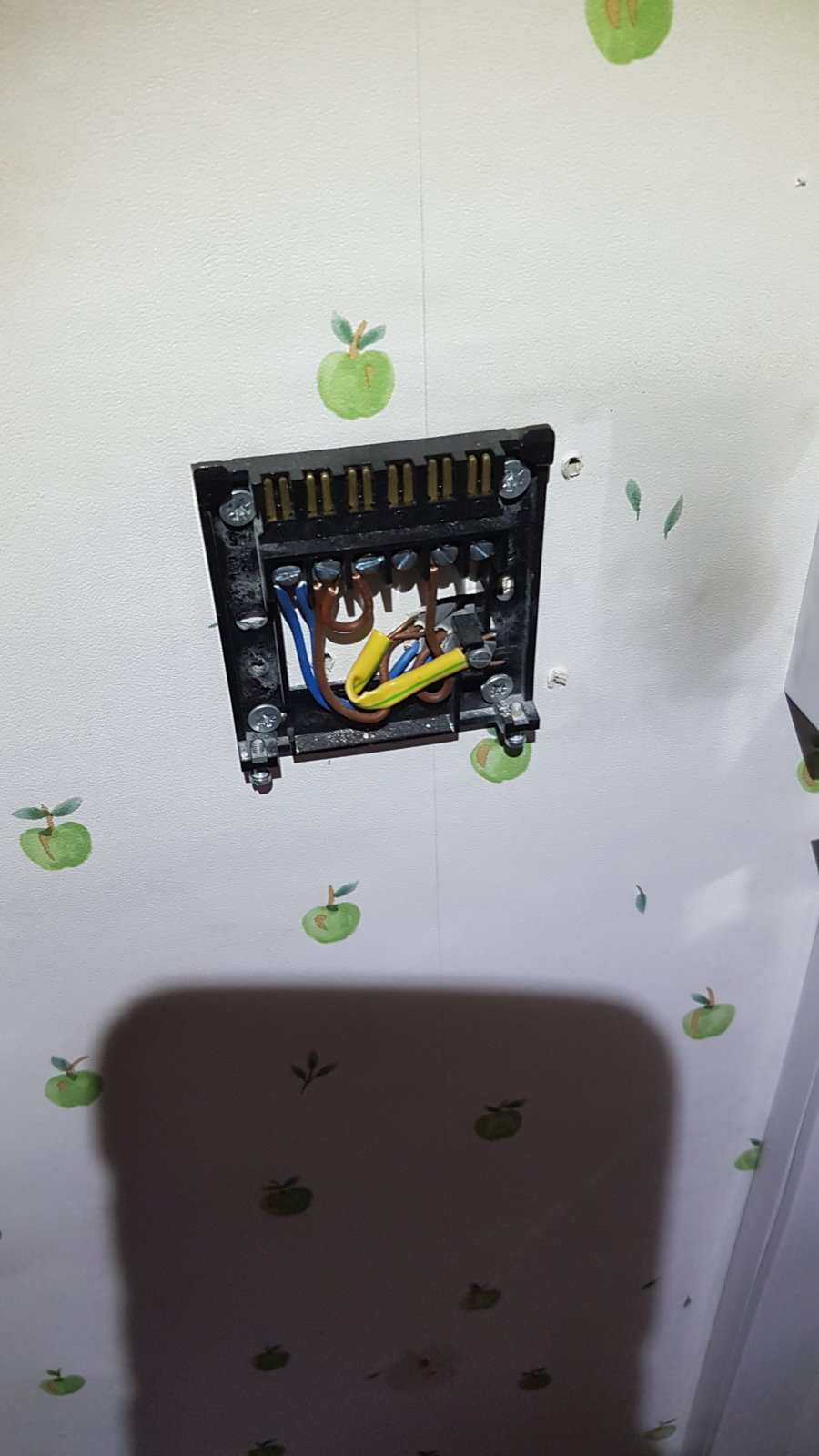

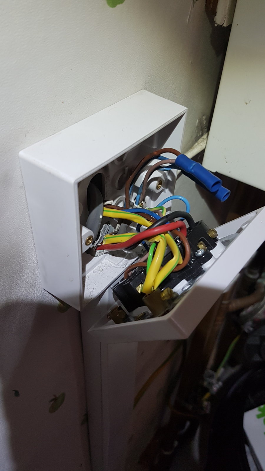

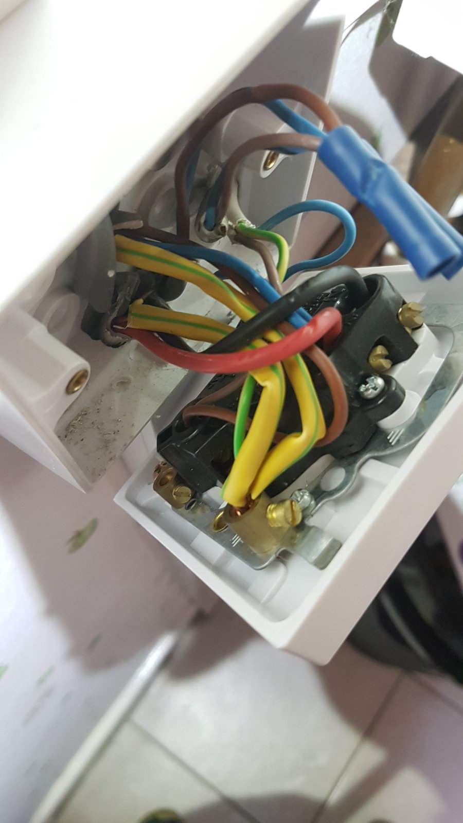

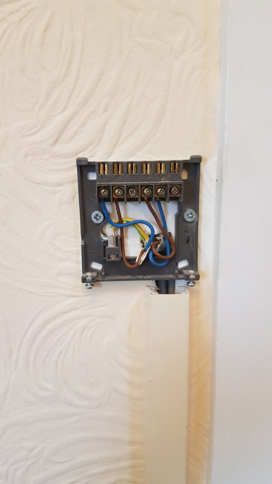

OK today is the day I try and connect the nest. Here' h my wiring looks. Anything unusual or will I just follow your instructions?

Unfortunately I am away at the moment and I can't see the photos too well on my phone. However if the photo with the fruit wallpaper is of the Drayton backplate with the link, and the thermostat backplate with the embossed wallpaper, then both are as I expected to see. The thermostat switching wires are in terminals 2 & 3.
Thanks again for getting back to me. I did as you instructed and all is working well. The only part I wasn't sure of was how to take the thermostat out of the equation so it's just turned up full at the moment. Can you give me more info on how to go about that? I'm guessing I connect the blue and brown wires (2 and 3 at thermostat) back at my main switch at the boiler? I think they are the crimped wires in one of my photos? How do I deal with the power that's going to the thermostat? Apologies if I'm asking daft questions or I'm misunderstanding. Ultimately I want to remove the thermostat as its unsightly where it is. I appreciate your help so far.
Andy.
You can trace the switching wires in 2 & 3 back to their origin and remove them. Then where they came from, insert a wire link or connect their points of origin together as applicable. The 230V supply cable to the original thermostat can just be disconnected at both ends and removed.

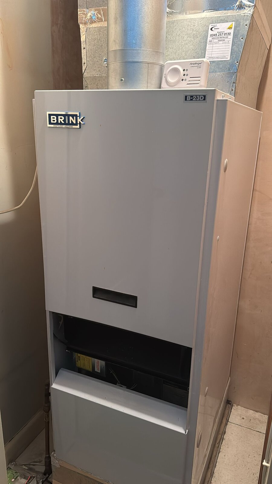

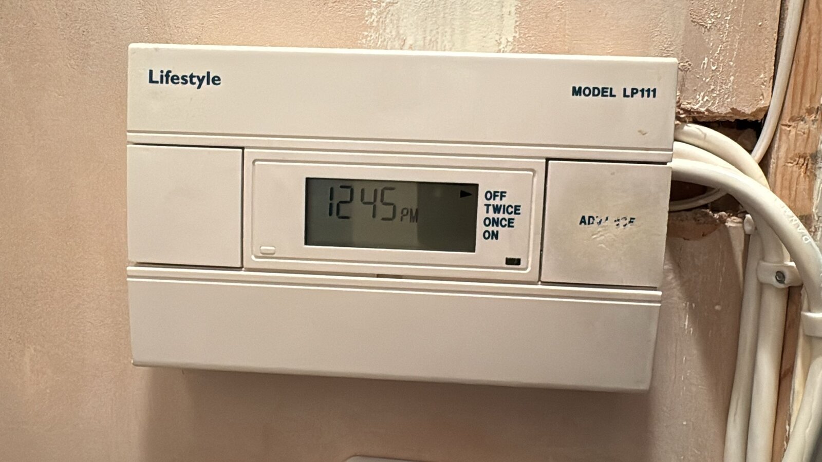

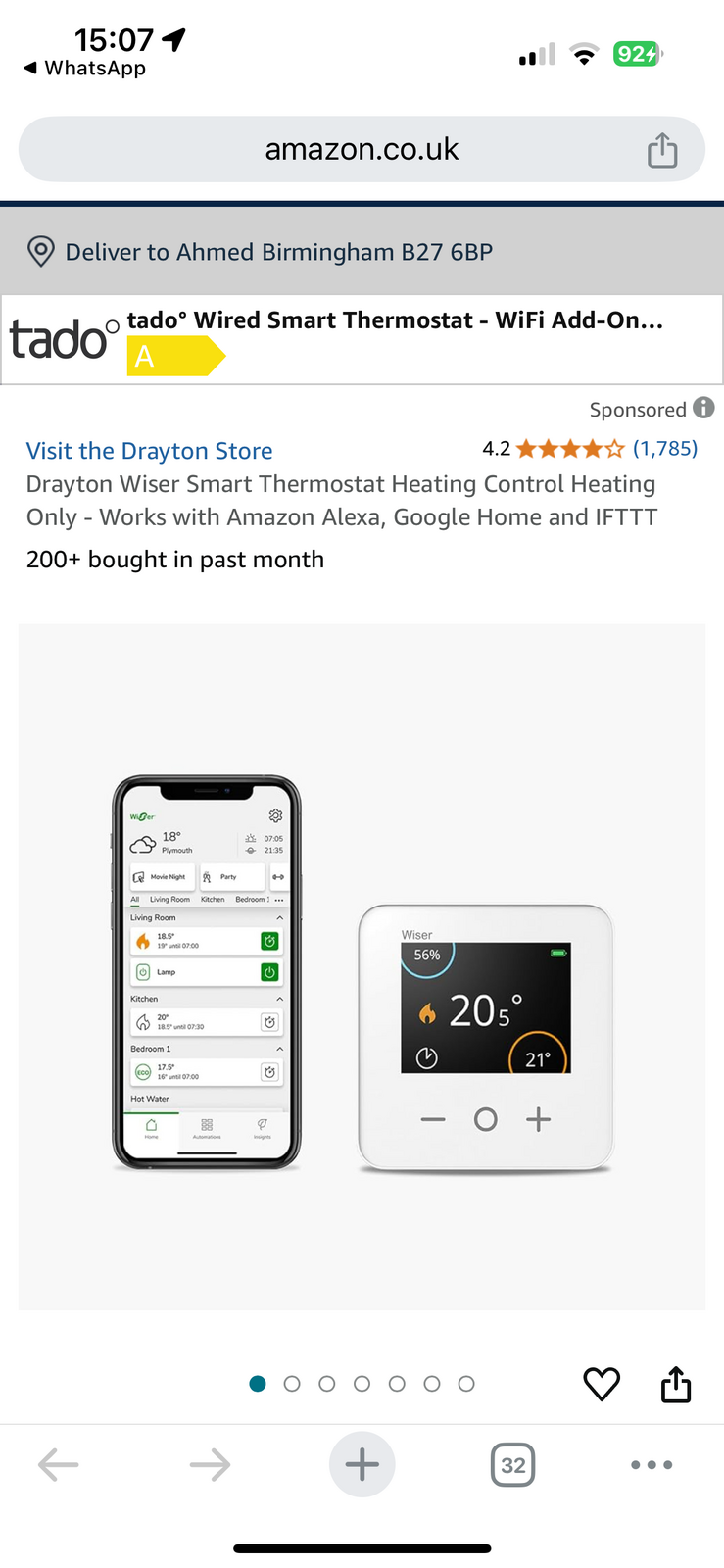

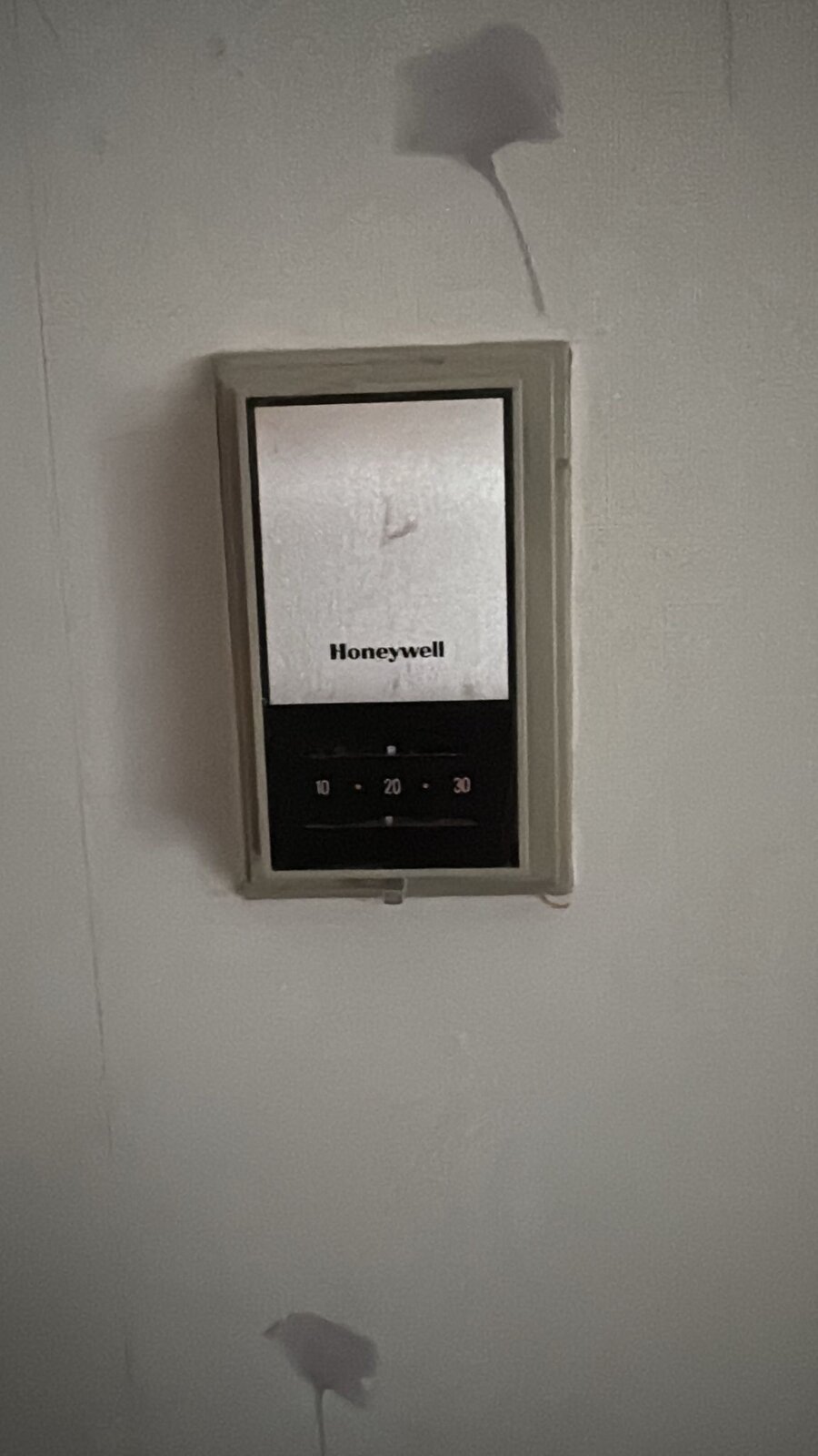

hi
I have air circulation central heating controlled by LP111 and a thermostat attached home , pictures attached. Can i replace it with Drayton Wiser Smart thermostat heating control . If yes can you help me wire/install it .
Thank you

I don’t see why not, however you have hijacked a 7 year old thread with a completely different setup.
I am new to diynot.com . Can you help me wire it ?
Being a Drayton single channel it should just be a case of swapping the fronts over with the backplate being industry standard. Connect existing thermostat wires together or set to maximum.
