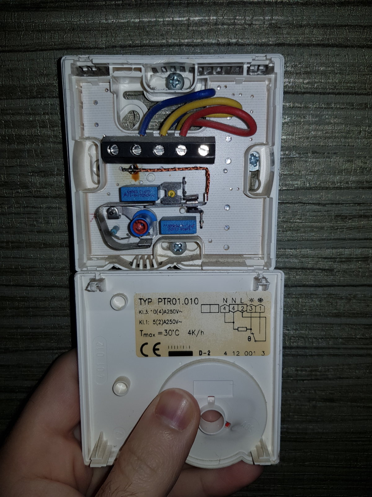

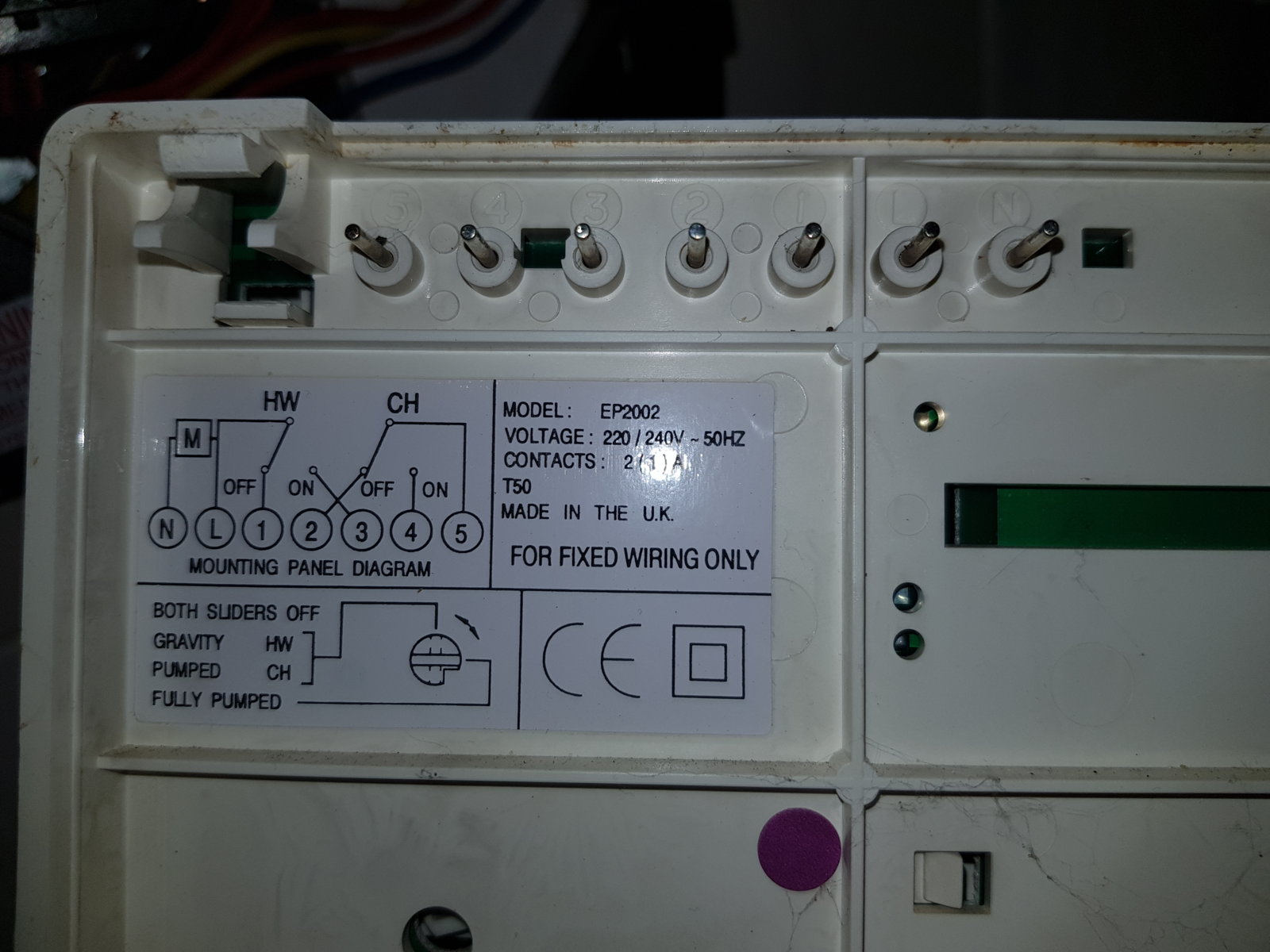

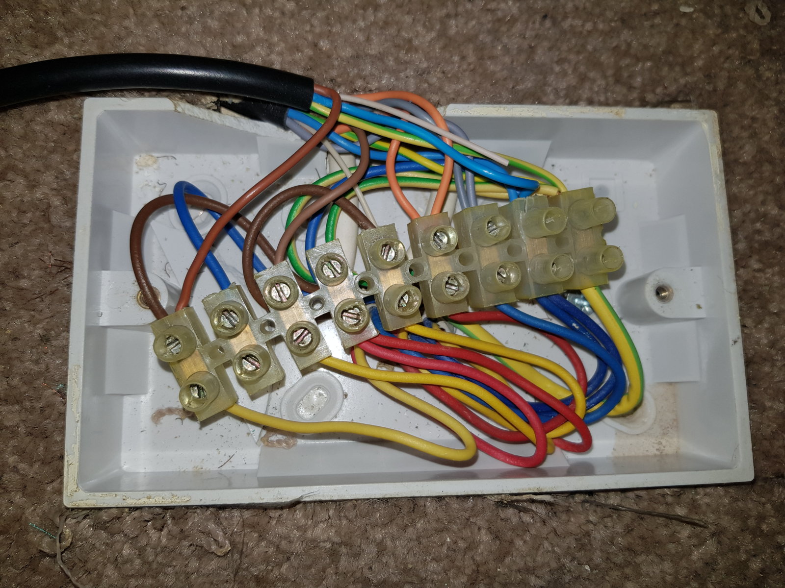

I’m asking for advice on how to install the NEST Thermostat (3rd Gen).
I currently have:
Please find attached pictures of the current wiring on the EP programmer, the thermostat and also the junction box (upstairs inside the airing cupboard).
Programmer:
Programmer Diagram:
Thermostat:
Junction Box:
My plan would be to replace the programmer with the HeatLink, straight forward hopefully, specially after coming across this post.
Pretty much the same setup and very helpful, however, I would like to use the existing thermostat wires to power the NEST thermostat and place it in the same location.
I believe these wires are going to the junction box and then being sent back down to the the programmer, so how do I go about getting that wired?
Please let me know if any further clarification of the wires is needed.
Much appreciated!
