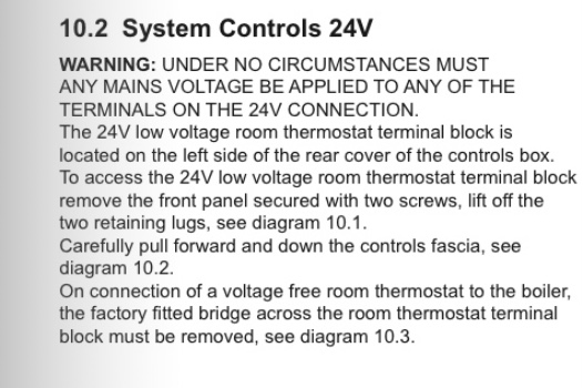

Morning all,
As above I am wanting to fit a Nest to my Glowworm Betacom 30C.
I’ve read a very helpful post on here which says I can take the Heatlink and put 230v in to its L & N, and then using the 24v connector block on the boiler, wire that in to the 2 & 3 on the heat link.
That sounded great until I read the manual for the boiler where I found this under 10.2.
I was going to go and pick a Nest up today but this has stumped me a bit.

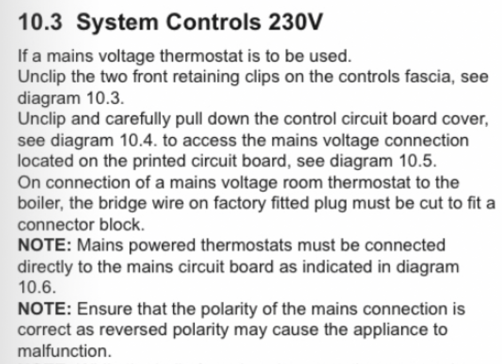

Under 10.3, it says a thermostat using mains voltage can be attached at a different plug in the boiler, however this method is slightly more complicated.
Hope someone can help, thanks in advance.

The L and N supply to the Nest are there solely to provide it with operating power.
Terminals 2 and 3 are a connected to a voltage free switch. These terminals are not connected to the 230V supply in anyway. So terminals 2 and 3 will switch whatever is connected to them be it 24v or 230V. So what you propose below is fine:
When using 24v what you must not do is connect any of the other Heat link terminals to L. You will sometimes see instructions to link terminals L, 2 and 5. That is only for 230V switching and for obvious reasons must not be done when using 24v
